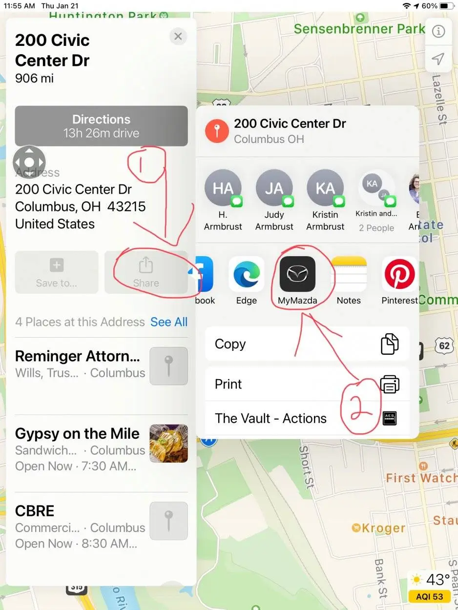

  1. Open and sign-on to the “MyMazda”App. Then Go to either Apple or Google Maps and search up the address you want to send to your CX5. Select the Share button. In Google Maps the share button is a little less prominent but it’s there.
  2. From the window that opens, select the “MyMazda” App.

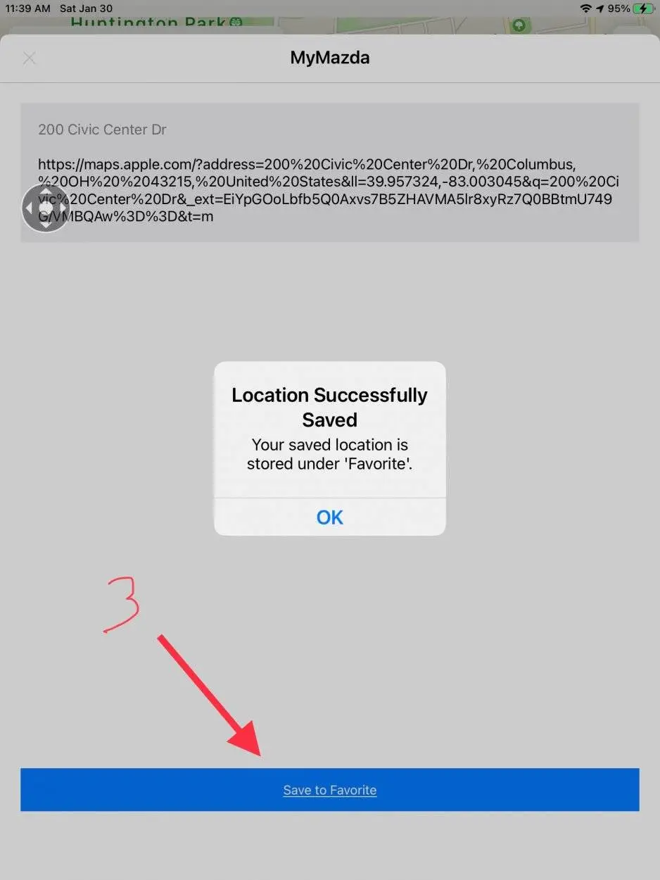

  1. Up will come the following screen. Select the blue “Save to Favorite” button at the bottom. The acknowledgment shown in white will appear.

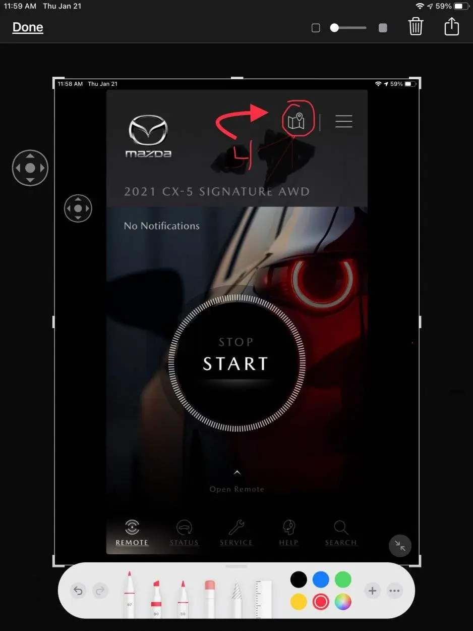

  1. Close the Maps App. And open the “MyMazda” App. Select the small map icon at the top right of the screen.

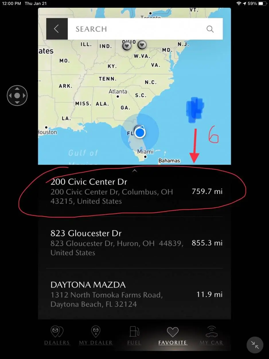

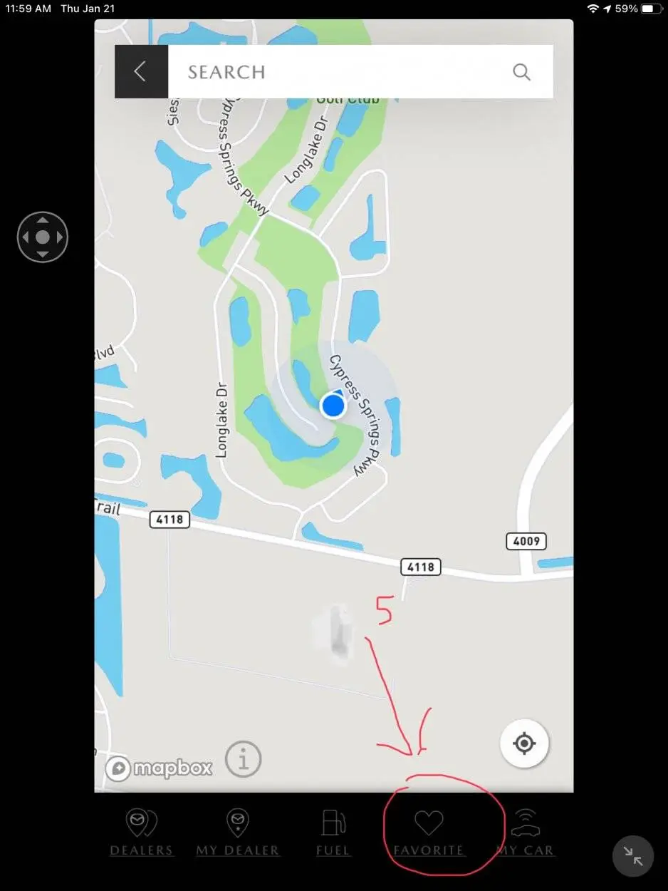

  1. Select “Favorites” at the bottom of the page and up will come a list of your favorites including the address you just added.
  1. Click on the address you want to send to your CX5.

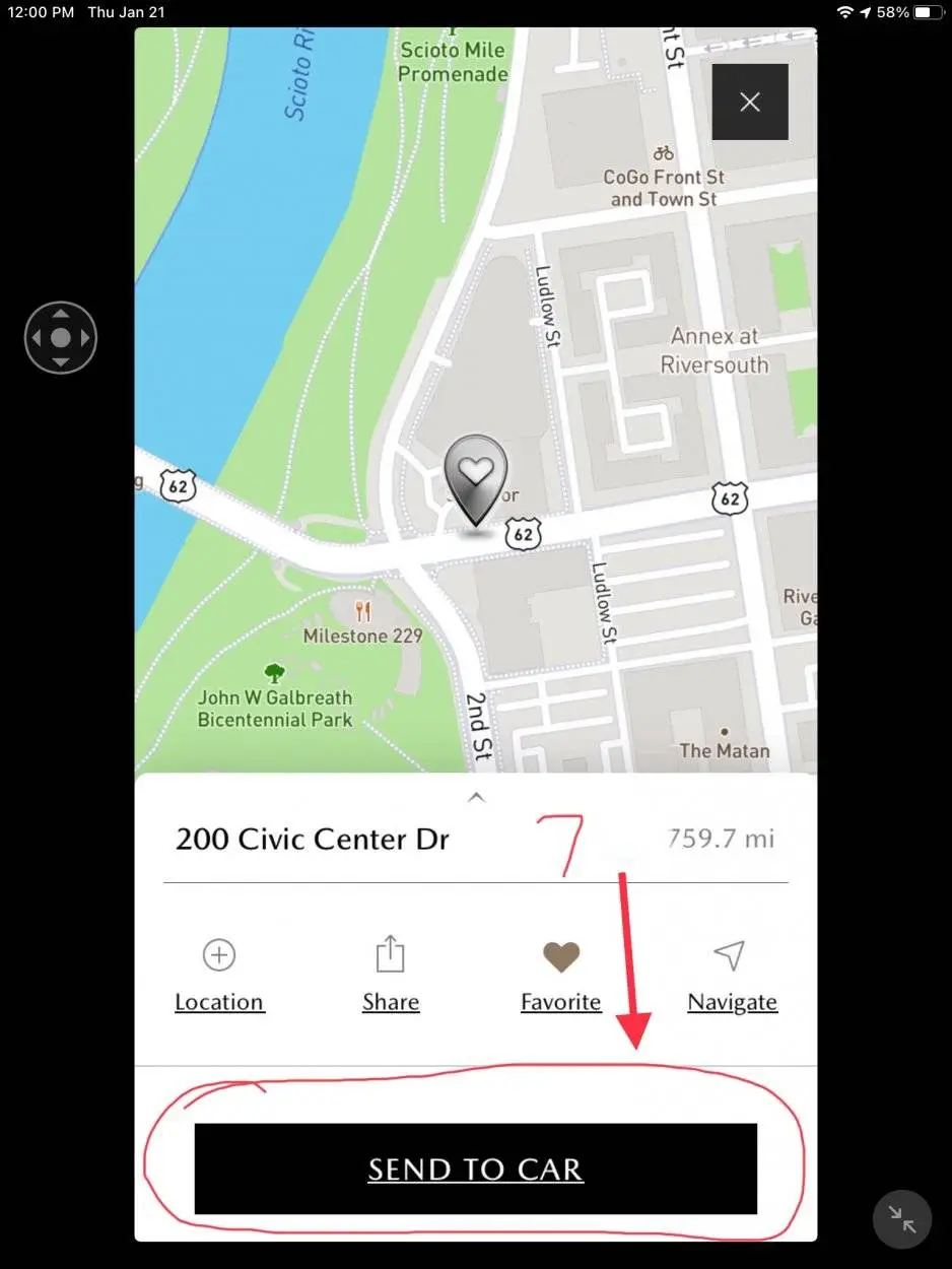

  1. Up will come a map. Hit the “Send to Car” button at the bottom of the screen.
