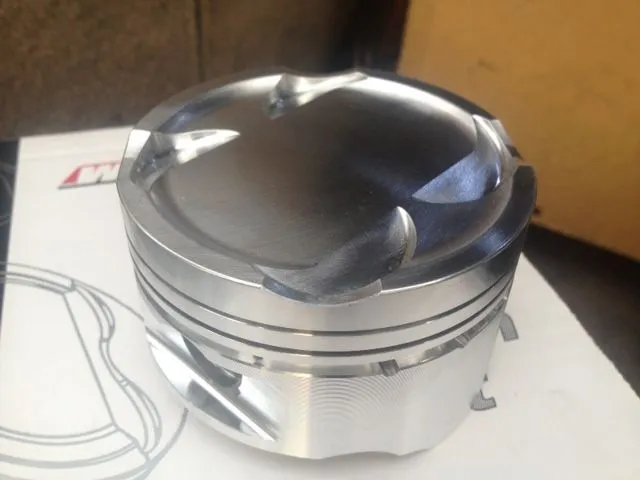

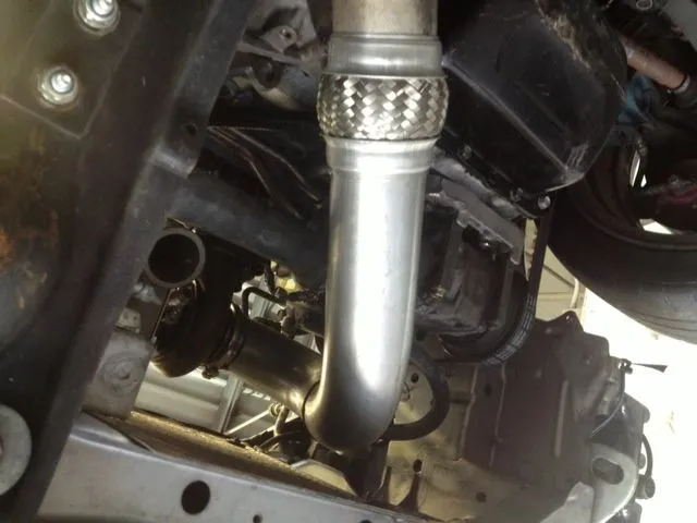

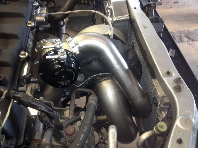

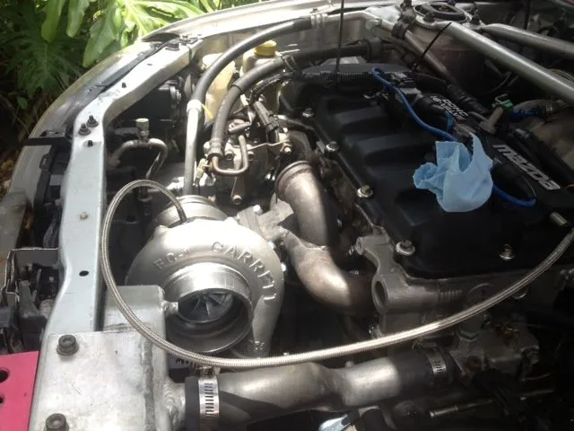

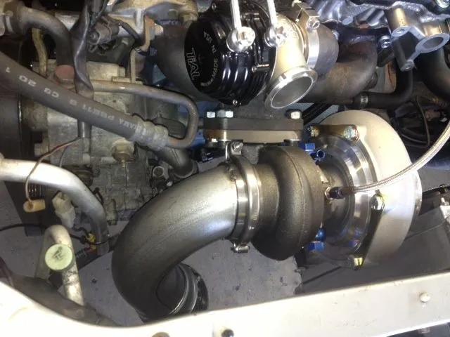

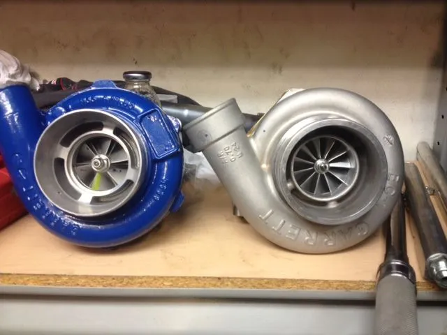

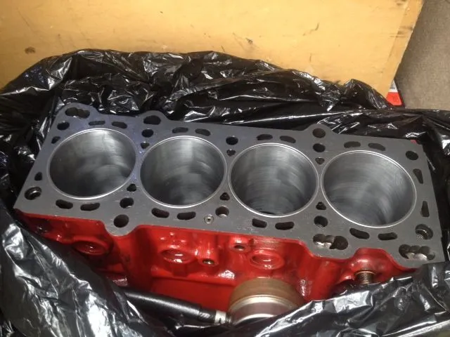

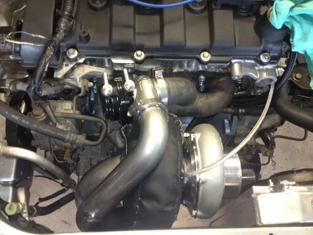

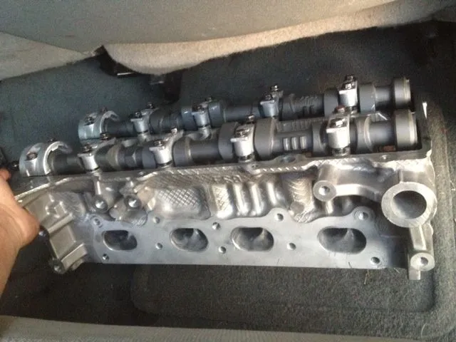

hey everyone, ive posted on here before but havent been on in a long time to update my threads so i figured id just make a new one. im in the processs of putting my car back together now let me list the things i had before i did the rebuild
old setup -
2.0 built, wiseco 9:5:1 pistons, pauter rods , cometic headgasket, arp studs ,1000cc injectors, Perrin fuel rail, aeromotive FPR, walbro 255 , tial wastegate , gt3076r , 626 intake manifold, stock head, ect
that build lasted me a little over 70k miles then unfourtunatly i blew a headgasket due to a waterpump failure. i took the head off and realized since im aready here why not just refresh the block. i took everything apart and before i sent the head to the machine shop i orderd a full supertech valvetrain (1mm oversized valves , guides , springs retainers). when i sent the block out to get bored and decked i decided to go add "fire Rings" to the block. here are some pictures of what i have going in :
New Setup: wiseco 10:5:1 Pistons With No anti detonation rings , Fully Supertech done head , Schneider 272/272 cams , New GTX3582r , New tial Wastegate.
opinions welcome.

This thing is going to fly. how much boost are you going to be running? Dyno numbers in the future?
Nice man.... The old set up sounded sick though i saw the oms vidz that spool sounds crazy from the gt30 wonder how the gtx35 is gonna sound
