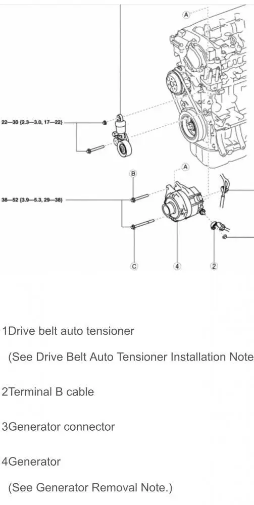

Anybody know how to test the voltage of the alternator? I want to rule out that I'm not losing voltage in the wiring between the alternator and the battery.
Usually there's a port (screw) on the alternator that you can test positive voltage but I can't seem to find anything.

Just find out where the big battery wire attaches, and that stud is where you probe to test. The wire is probably mostly out of sight, and you might need a mirror or inspection camera to find where it comes into the alt.

Thanks, but that video had a nice convenient point to probe. It even had a nice plastic cover to pop up. No such thing on the CX-5 alternator. There's a electrical connector that plugs into the alternator but none of the wires are exposed. I will try to bury the probe down into the connector to see if I can get a reading off that

I don't have a picture of your model's alternator connector available, but most all of them have a removable protective cover that goes over the stud connector. On my '20, it's a plastic flip up, but some have a rubber cap. So you should be able to easily get the cover off, in order to access the stud for testing.

Yeah, that's what I thought too. It looks like it has a standard plastic connector (like a wire harness). I tried inserting the probe down in it but couldn't get a reading.
