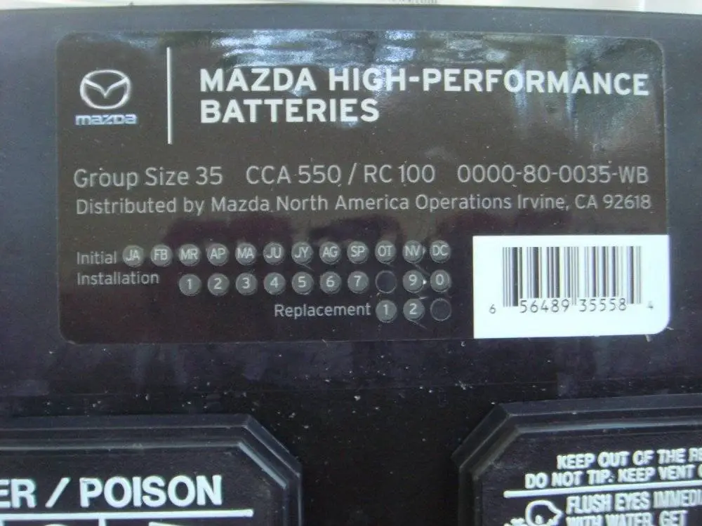

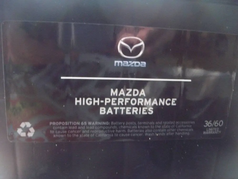

Installed by dealer. Not sure of brand, will check.
So you have Mazda OEM “High-Performance” batteries sold in US Mazda dealers and made by Interstate.
