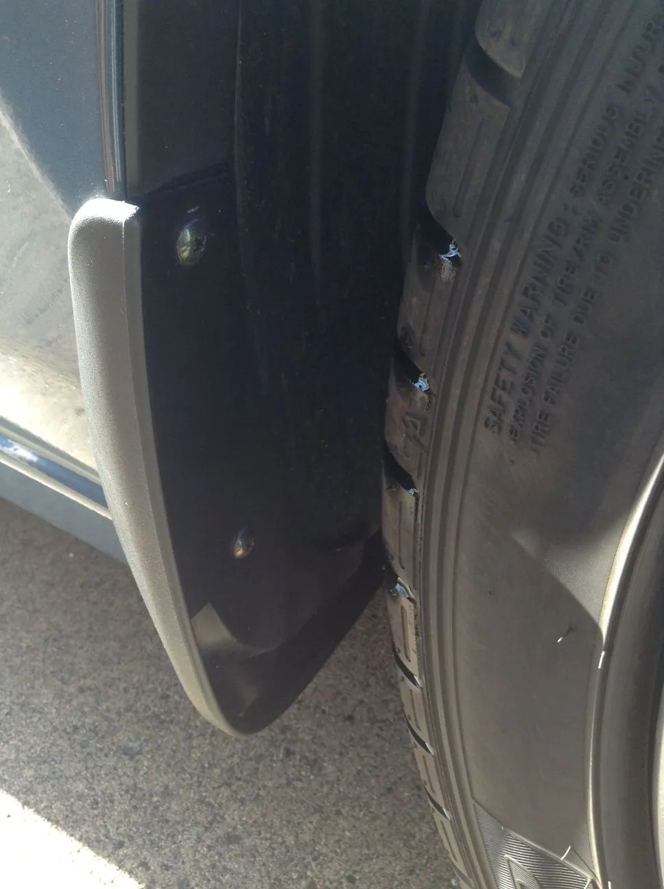

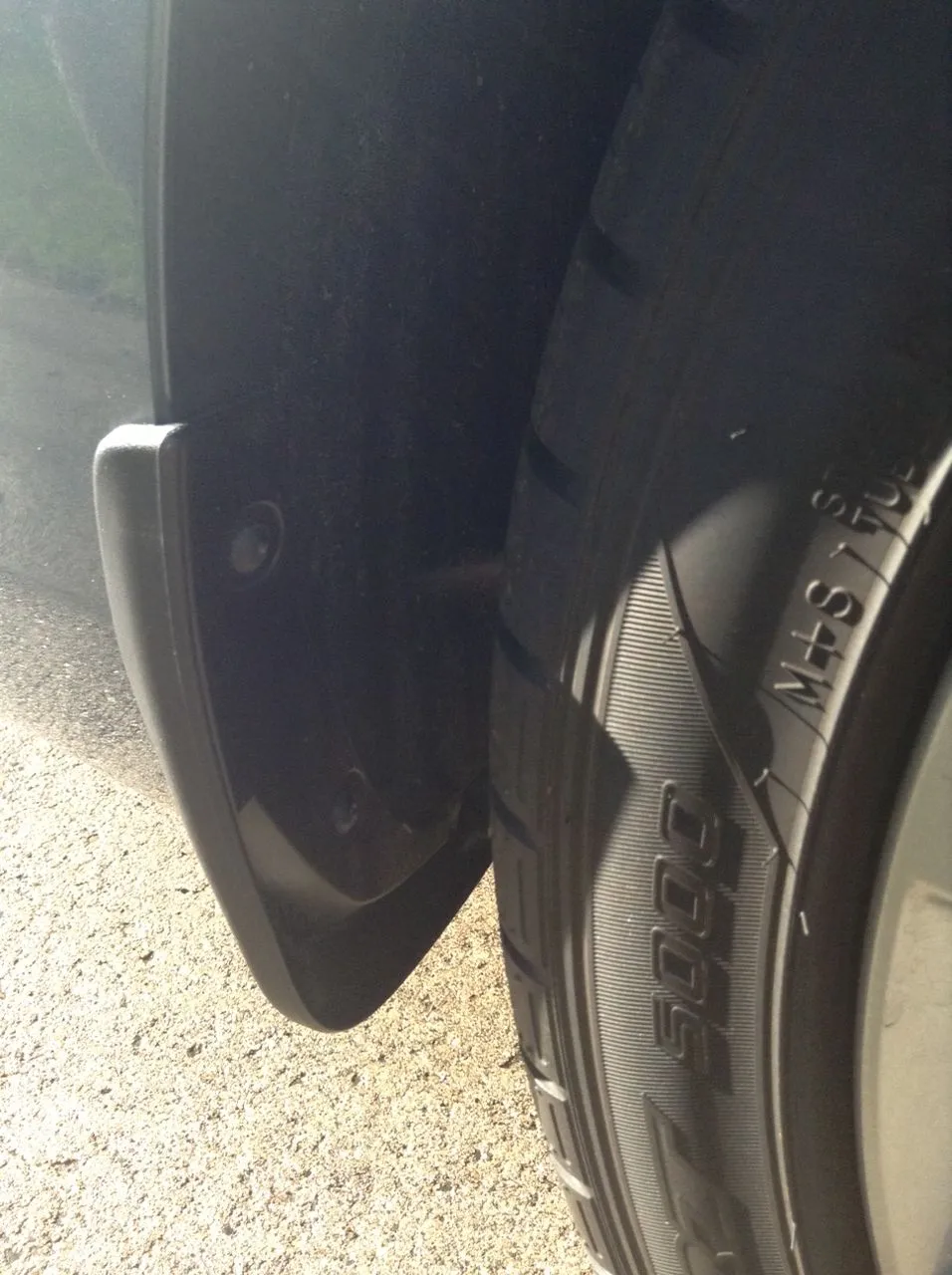

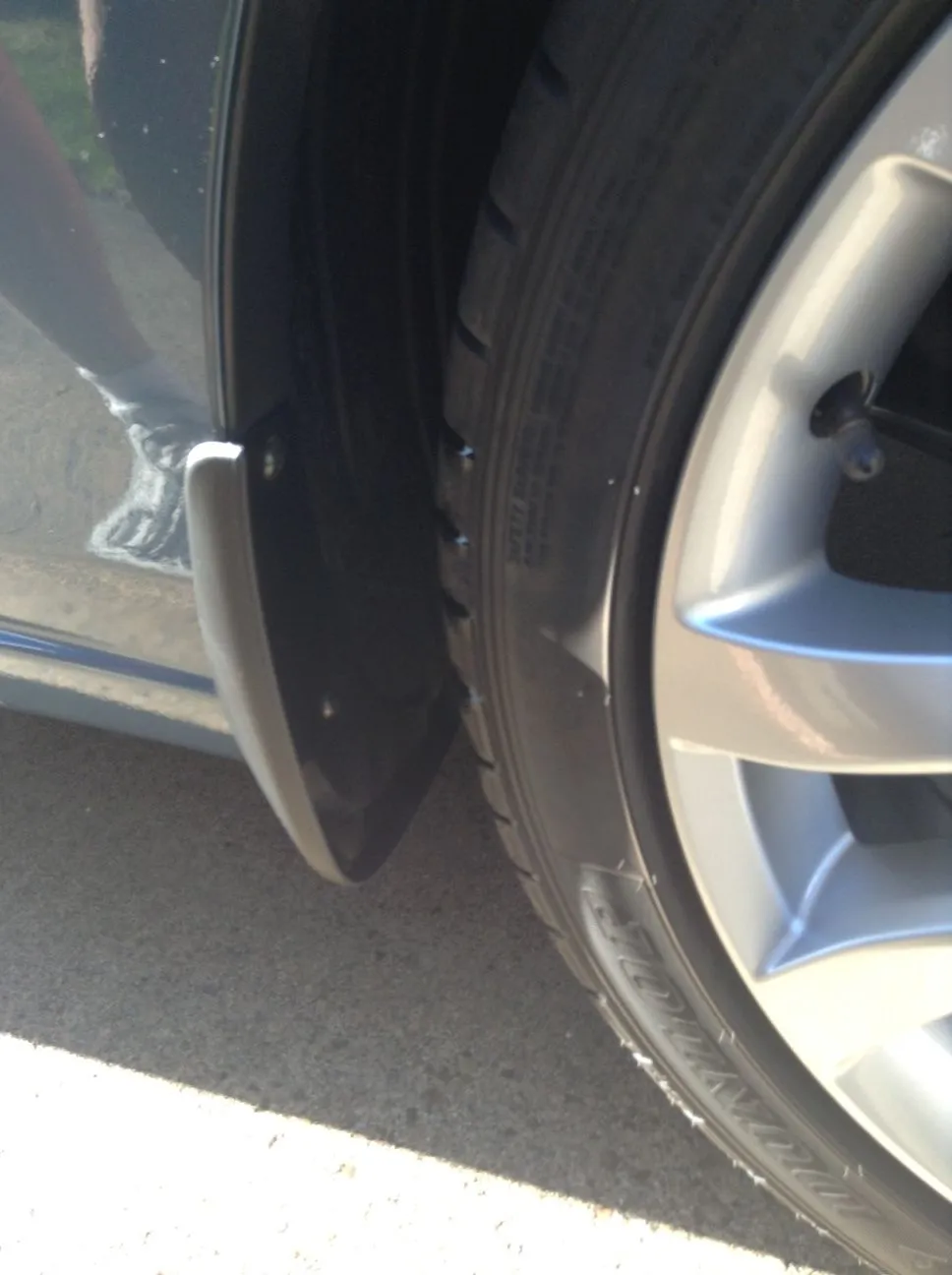

Here's a couple of shots of the flaps installed....

CMFIREMAN's directions are perfect! I installed a set over the weekend using the ratchet screwdriver method to keep from having to pull the wheels or jack up the car. Word of warning, my salesman warned that when ever you change tire pressure or rotate tires that the Tire Pressure Sensor should be reset (dash button next to your left knee sitting behind the wheel) Not sure if simply pulling wheels applies but can't hurt to toggle the reset.
