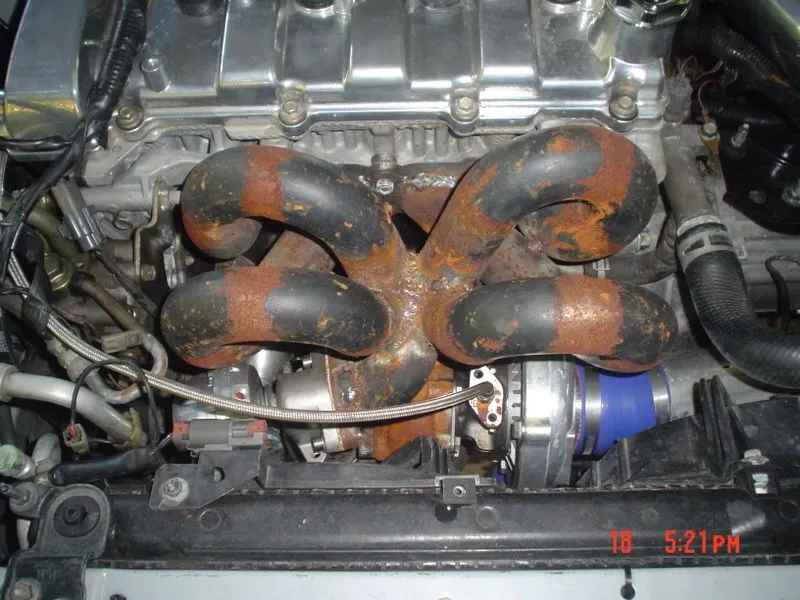

Hey people, the FSDE is a high torque engine, the MSP turbo is a fast spooler, right?
A short runners turbo manifold will give a better TOP END power while a long tubular will give more torque and faster spool. The difference in spool time will be negligible while it will give more power on high rpms.
I think the best manifold for this turbo is a shorty tubular manifold.
On saturday we tested another shorty manifold but this time was on a Celica GTS, it pulled 424whp on 22psi. The pic of the manifold its not so clear because its behind the firewall and a very tight fit. If anyone is interested in the video/pics, let me know.
On the protege, the long tubular on the T3/T4 is still on fine tunning and leak test up to february.

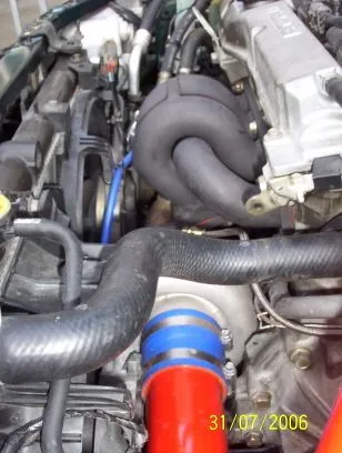

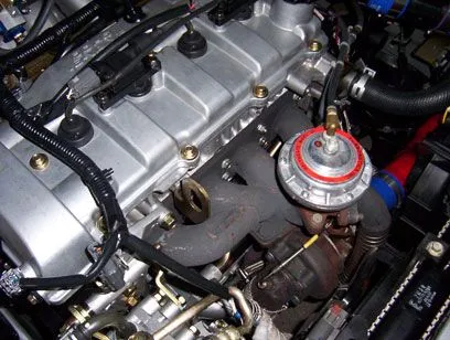

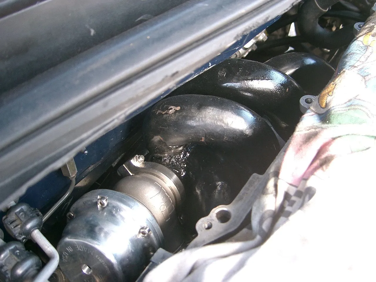

The manifolds
Here are some pics from the actual manifold creations.
1st one is from the Celica GTS running 424whp @ 22psi - Dyno Video
2nd one is from the FSDE 323 running over 600whp @ 40+psi - Track Video
3rd one is the last one made and under testing 262whp @ ~11+ - Dyno video
4th one is from a Protege5 running low 13s @ ~14psi (uploading video...)
5th one is from a 1.6L Protege (no video)
