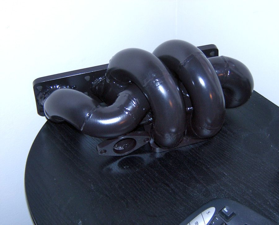

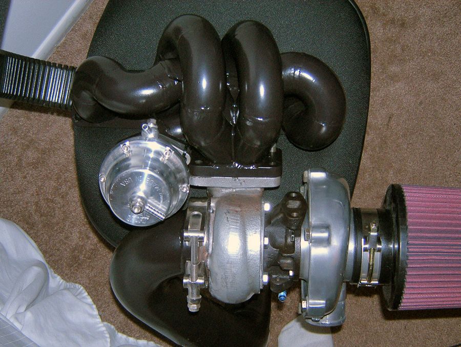

Check it out, the Thumper Manifold is here. Had it Jethot coated black and took a couple pics! Enjoy!
kinda crappy pics, better ones when everything is in the car.
B E A utiful! Glad to see it work out for you bro.
thanks :)

OMG...this is gonna be SICK. I want a manifold that spells sex like that. That is a real DP to be proud of. We SO gotta do a photoshoot b4 you leave to Orlando.
