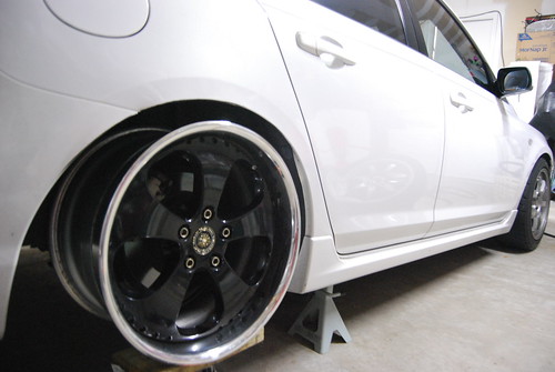

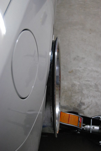

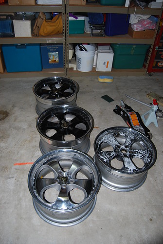

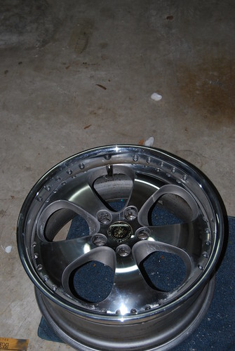

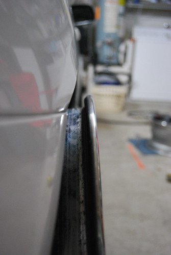

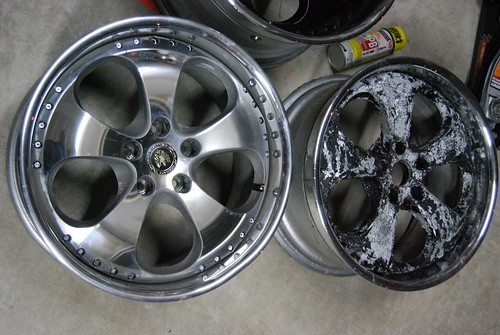

Preview of the new setup! in the process of polishing them.
ABC Exclusives
effectively
18x9 +31
18x10 +28
