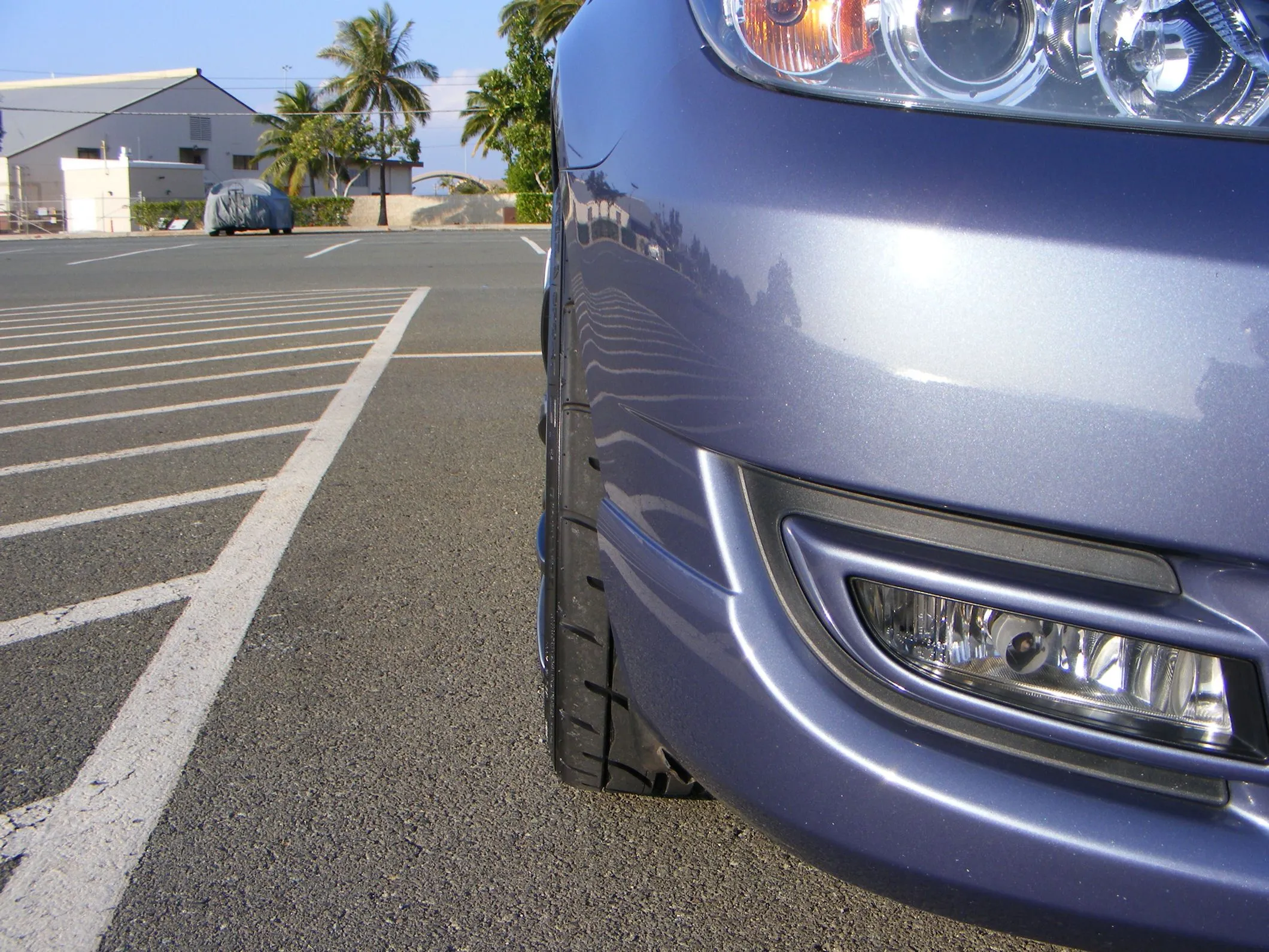

1.
2) Rota, SVN, Hyperblack
3) 18x8.5 +48 67.1mm hub bore
4) Falken Azenis
5) 225/45R18
6) Stock Suspension
7) factory alignment specs
8) Fenders not rolled @ the time.
9) No modding needed. No rubbing lock to lock. Closest clearance was the inside of the fronts to the strut. Approx 1/4"
http://i230.photobucket.com/albums/ee297/mr_mazda329/Speed 3/100_2800.jpg
10)
11) Additional comments: looks fat and flush. If ya want more, Run 235/40s and 5mm spacers. Then you will have to roll and pull your rear fenders some.

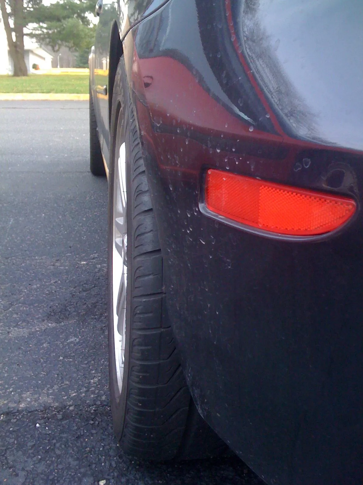

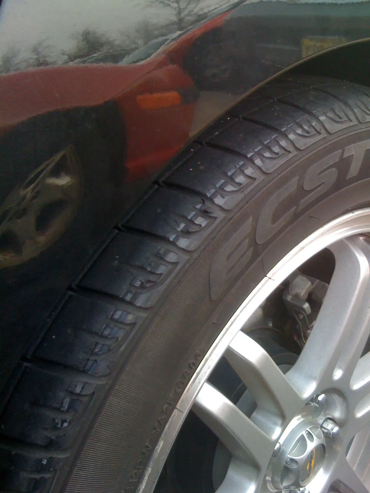

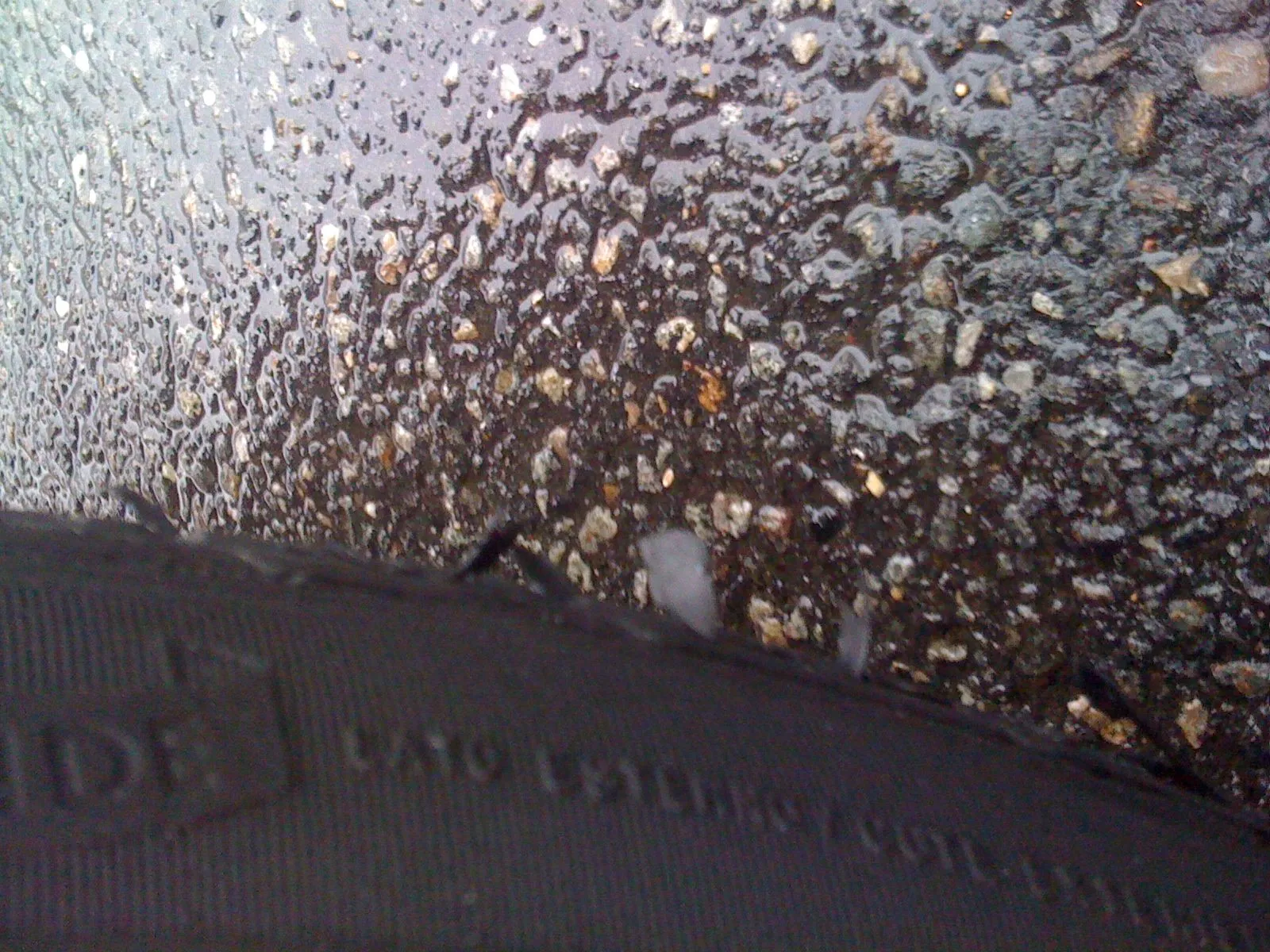

dude i love ur car, very clean, and i like ur set up too i just dont understend how u not rubbing (confused). i will take some pic of my car later and post it so u can see how it rubs.
here it is 17x7.5 with 225/50 tire not sure about the offset but i think its +48 or +45. as u can see it rubbed pretty bad with this set up, idk how urs didnt
It is rubbing. The only think i can think of id that your offset is lower than +45 and/or since you have 50 series on the 7.5'' wheel, its causing the sidewall to be bulgy vs the sidewall on mine which is stretched a little.

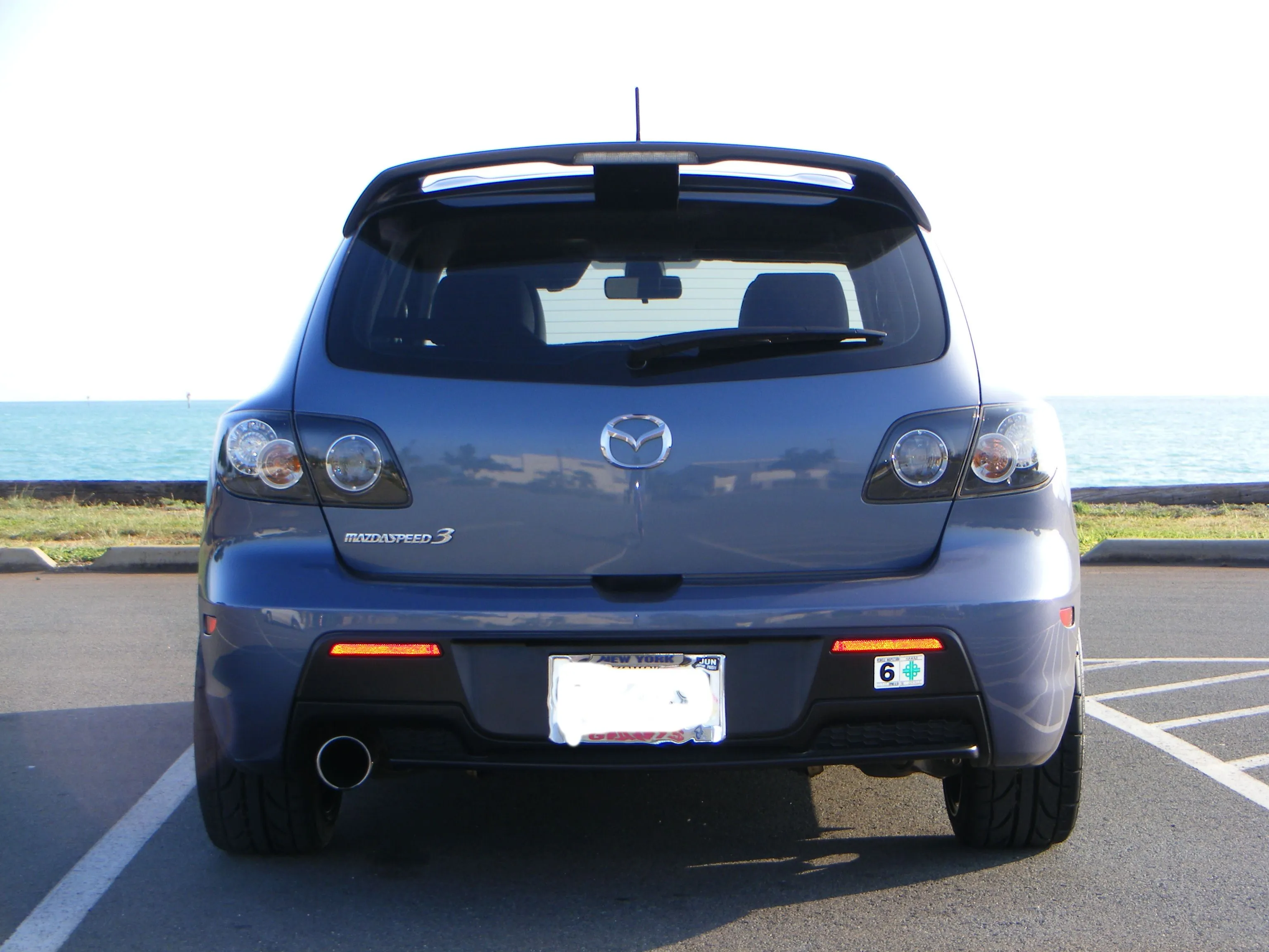

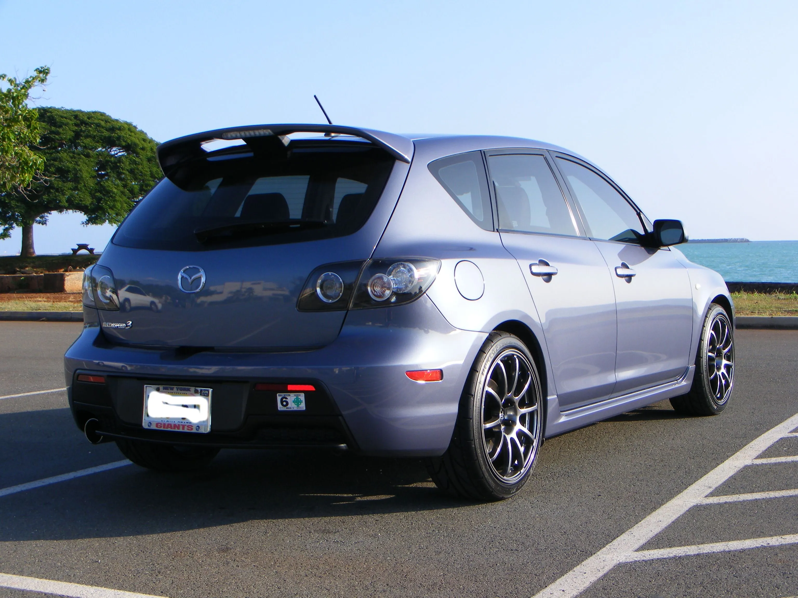

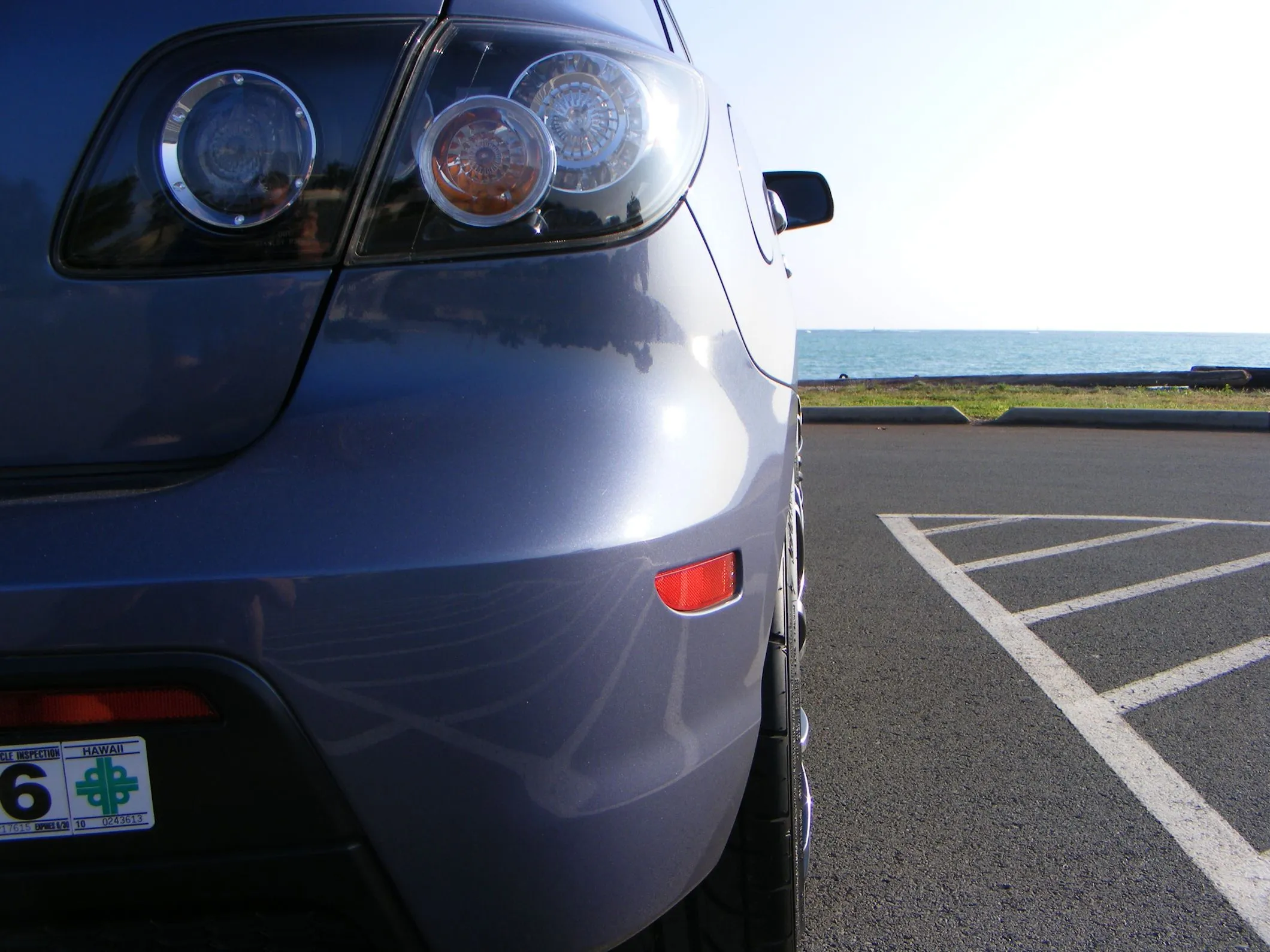

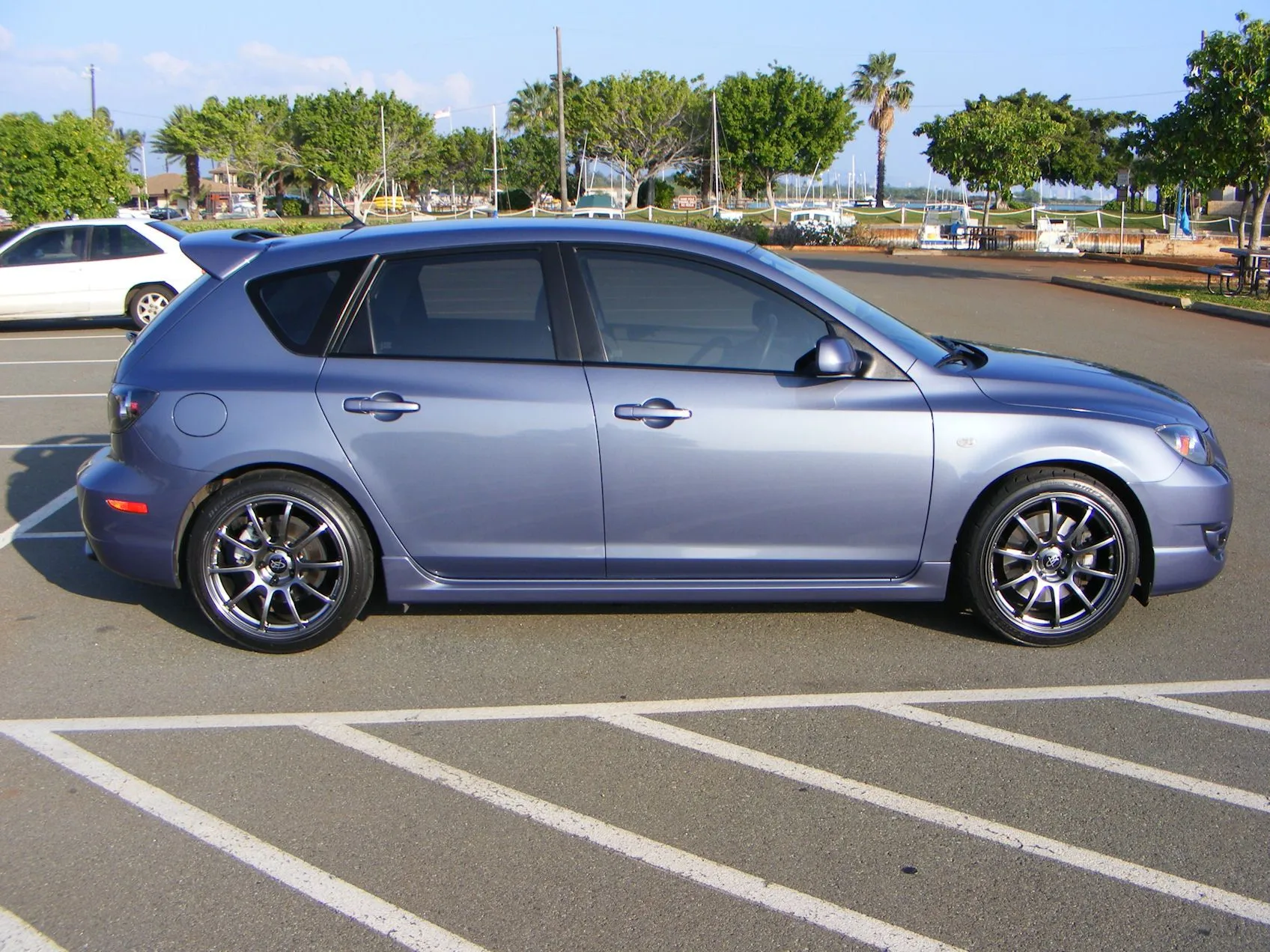

Got my wheels
Finally,
After owning my MS3 for 2.5 years I have started doing some mods. I have been following this forum and building a wish list since I bought the car. I am now the proud owner of a set of Rota G-Force 18x8.5 in Hyperblack with a set of Dunlop Direzza Sport Z1 225/40/W18 tires! Oh I love it so! The tires were an instant improvement over my stockers with 34k on them (no I don't launch it at every light). And I really love the agressive look it gives the car. I have absolutely no rubbing on rough roads hear in Hawaii. I do have considerable gaps and am now thinking of a set of springs with minimum drop, sway bars, and the Koni FDS shocks eveyone talks about. That will have to wait until we recover from the Xmas crunch of course. Anyways thanks for everyones help and to Zoeb@wheeldude. I ordered my wheels on Monday and recieved them on Thursday, not bad for Hawaii, and shows quick action.
