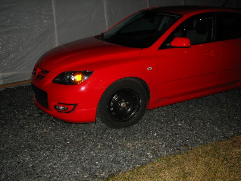

Hey borderline, can you take some pics of the front wheels with 16-inch steelies?
Not that I don't believe you, but all the info I have says it shouldn't fit.
no problems, I will send pics tomorrow ;)
My local dealer was surprised that it fit!
Take a closer look, we see: 205/60R16
yes the 16" fit! (headbang)

damn thats too close to the break for my comfort with the 16" wheel!! any flex or movent in the wheel during cornering, and/or ice/snow build up, and your caliper is rubbing!
Yes it's close but the mechanics at the delaer told me there was no problem cause the wheel won't flex enough to touch the caliper. In fact it almost doesn't flex at all.
With my other car (protege5) Winter tire was on 14", it was almost the same "tight fit" and never got problems. I have about 3/16"-1/4" of clearance.
And rubbing with snow won't hurt the caliper.
The only thing is the handling: very reduced with theses 16". I can't drive like before with my factory 18" :(

borderline, thanks for the pics. My new recommendation with MS3 on 16's will be that it can fit but wheel dependant and test-fitment required.

That wheel must be made differently since my 17" steel wheel has the same clearance to the caliper.
Exactly. You got the Fumagalli steel rims from Mony right?
