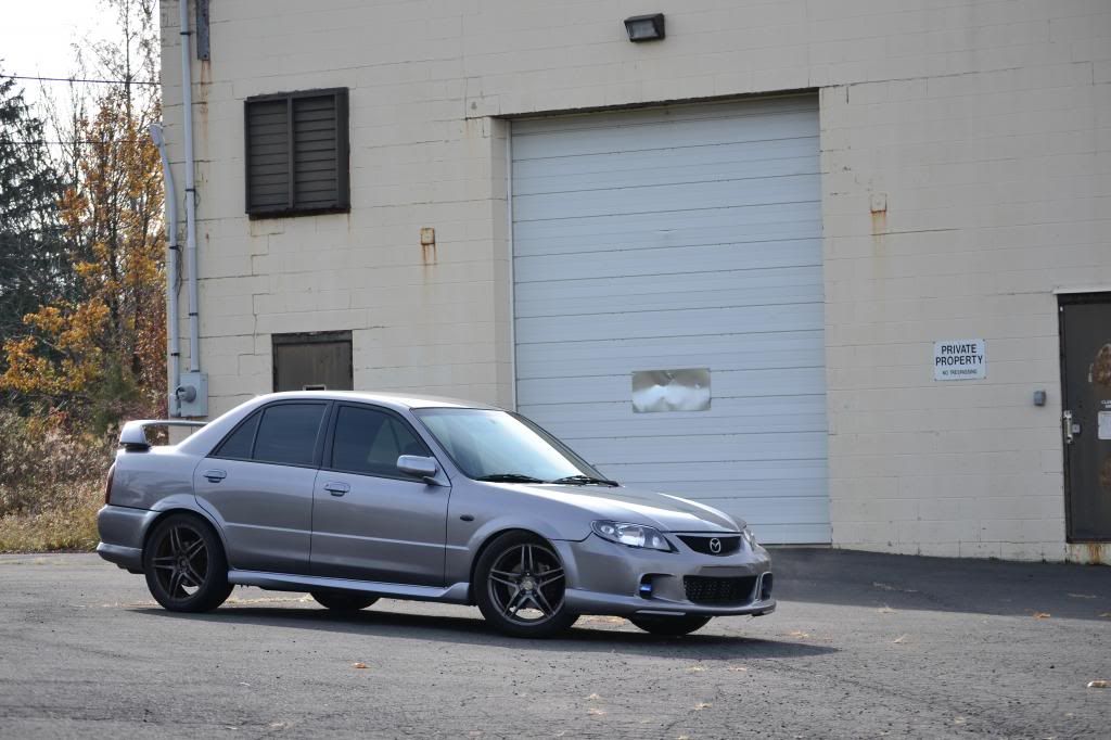

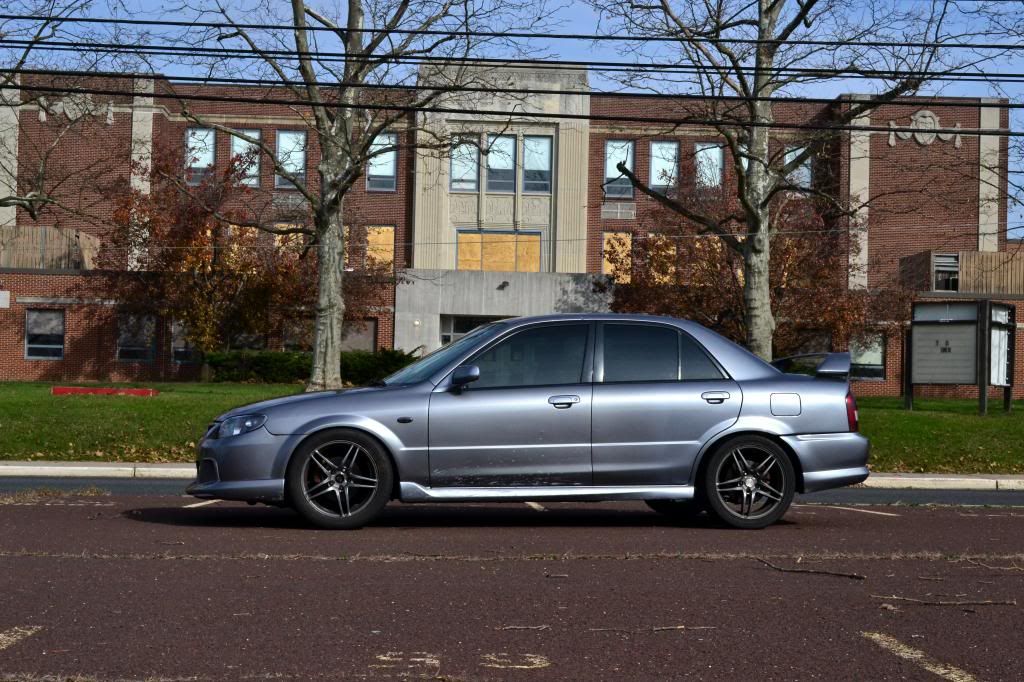

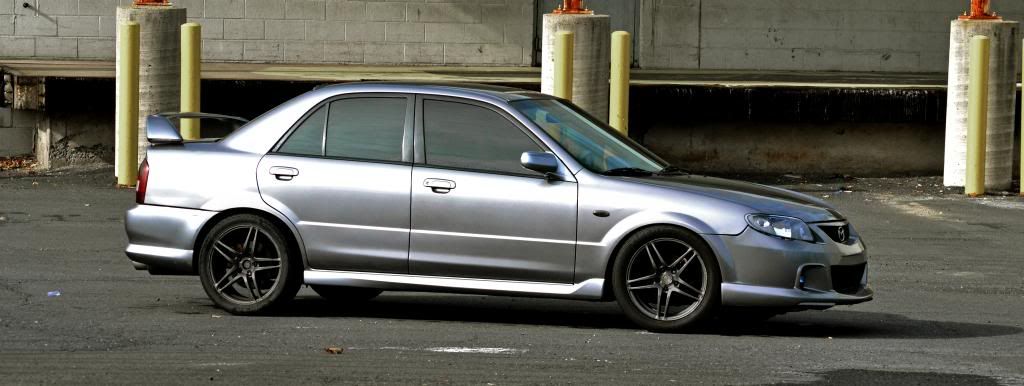

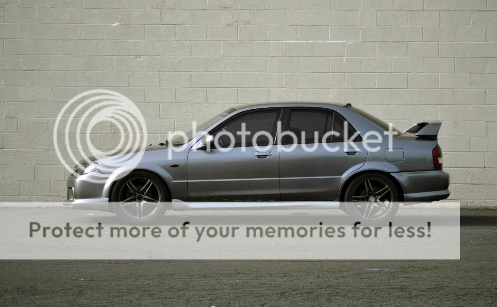

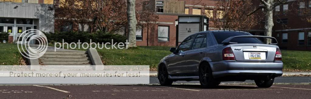

to clarify, this is the mod list:
Injen Cold Air Intake
Vibrant 3" inch turbo back exhaust(catless)
Forge adjustable wastegate(5psi spring)
CX Racing FMIC
AWR engine & transmission mounts
Corksport SS brake lines and clutch line
Eibach pro-kit lowering Springs
Tokico Blues Struts
Alpine speakers all around.
Kartboy short throw shifter
Twiggy Exhaust Cam
and i'm fairly sure the wheels are 17x7.5 Rota Battles... powdercoated gunmetal, but curbrashed as well.
the original steering wheel was beat, so i got a new one in much better condition. i wanted the interior to be super clean, and it is.
