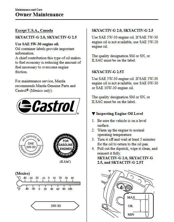

The 2.5L Naturally Aspirated Skyactiv is spec'd to use 0w20 and 5w30 with 5w20 as a backup option per the manual.
