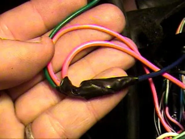

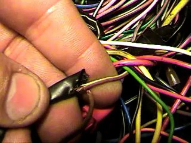

MPI & TM Reinstall: Part 1
Follow the pictures:
1. Install MPI Tunner #13RED to the #71 PCM [12volt key on and run]
2. Install the MPI Tuner wires, #1 black and # 9 green to the #24 PCM [ground] ** not on the pic, but yes...its installed.
3. Find and cut the #88 wire at the PCM. This is the MAF signal wire.
4. Install the MPI Tuner wires, #6 blue, #11 green/yellow, #10 black/white and the green Turbo Module wire to the PCM cut #88 wire that is coming in from the engine side.
5. Install the MPI Tuner wire #18 violet to the PCM side #88 wire.
6. Find the #89 PCM wire. This is your TPS. Install the #7 brown MPI Tuner wire to the #89 PCM wire.
---continued to follow pics---

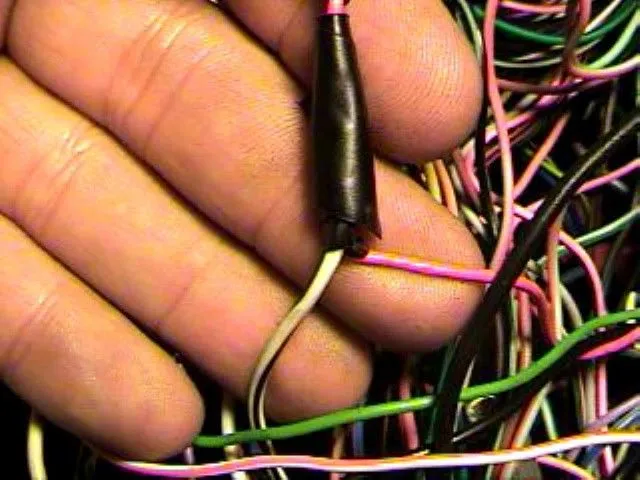

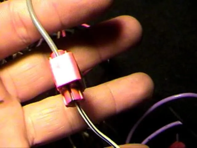

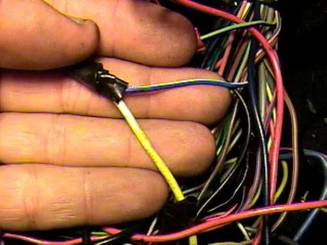

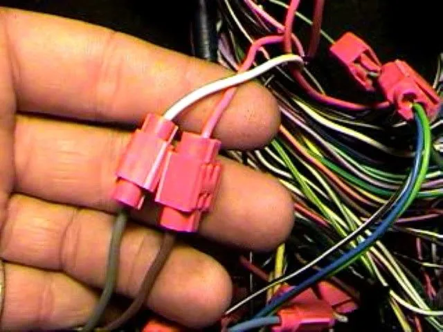

MPI & TM Reinstall: Part 2
7. Find and cut the #26 red wire at the PCM. This is the coil driver signal wire for #1 and #4 cylinders.
8. Install the MPI Tuner wire #8 yellow wire to the PCM side of #26 red.
9. Install the MPI Tuner wire #20 white to the long brown Turbo Module wire. Install the short brown to the engine side #26 red.
10. Find and cut the #52 white wire at the PCM. This is the coil driver signal wire for#2 and # cylinders
11. Install the MPI Tuner wire #5 white/red to the PCM side of the #52 white wire.
12. Install the MPI Tuner wire #17 white blue to the long gray Turbo Module. Install the short gray Turbo Module wire to the engine side of the #52 white wire

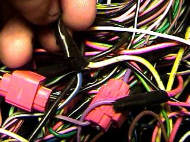

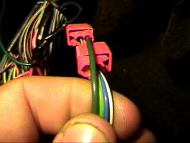

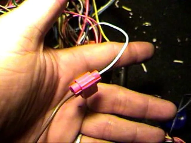

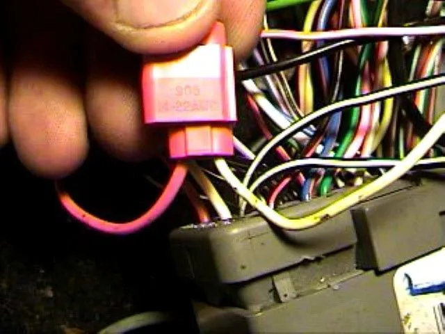

MPI & TM Reinstall: Part 3
The shorties is the first pic (short grey and short brown) on step 9 and 12
13. Find and cut the # 60 PCM wire, pink/blue. Install the MPI Tuner wire #22 black/brown to this wire at the engine side. This is done!
This is the O2 sensor output wire for the upstream Oxygen sensor wire. Install one of the white O2 clamp wires here, the other white wire goes to the PCM side of pin #60.
***Replaced with FM clamp
14. Find and cut the #38 Purple/yellow. This is your ECT sensor wire. Install one of the purple coolant clamp wires here, the other purple wire goes to the PCM side of #38.
***NOT ANYMORE
15. Find and cut the #39blue/white wire. This is your ACT. Install one of the yellow ACT clamp wires here, the other yellow wire goes to the PCM side of pin#39.
16. xxxxxxxxxxxxxxxxxxxxxxxxxxxxxxxxxxxxxxxxxxxxx
17. Install the black Turbo module wire to pin #51, PCM ground.
18. Install the orange Turbo module wire to the orange MPI Tuner orange wire. Use the AMP switch point under global setting/Switch. Adjust this to turn the Turbo module on as you hit higher boost. Set all other Switch point off, RPM,Temp,Deflection are all to be set to the off setting.
19. install the red wire on the Turbo module to the red/white fuel pump feed wire. Do not use the white/red wire, please take your time and look real close. If you make a mistake and use the wrong wire please call Mazda and order new coils, you just fried yours. You will find it by following the wire loom that enters under the front part of the center console. The wire loom will start right above the PCM loom and then run to the front center console under the vents/air duct. This is the only 12 volt key on source that you can use for the red wire in the Turbo module. Do not use any other 12 volt key on source.
20. Find the gray/black MPI Tuner wire#21. This the extra injector driver feed. You will need to run this wire out to the extra injectors.
