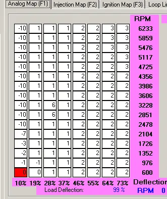

What Im doing right now is adjusting the FUEL ZERO CALIBRATION to lean out the whole map and then adjust idle.
Im currently running with the FM O2 modifier, and had to lower all numers down to "2" in the whole map because the 12:1 FMU pushes enough fuel thru the injectors everywhere in the map.
If you try to use higher numbers you will have problems when boosting.

I cant run without the FMU becuse, it doesnt matter if I put a 40 all across the board on the fuel map, it would run rich on vacuum and lean when boosting over ~3 psi. Looks like my O2 clamp on the Turbo module wasnt working at all.
So I went safe and used the Fm O2 modifier and now its working but not tested the MPI alone without the FMU.
But...this is just a workaround, in the meantime while i run without the extra injectors.
JAJAJAJAJ and tell me about running that rich. I have experienced heavy detonations (not the bad detonation/ping/knock) that were louder than M80's...then I watch a large black cloud in all my mirrors jajajajaj.
Current 10psi FMU Fuel map - fuel zero calibration: 6
This is what Im testing right now....still running pig rich but not that bad.
Still having some fun.
Notice those "6" in the fuel map. Those where imput there while using cruise control @ ~65mph climbing up hill on vacuum near 0vac.
I was just testing, trying to see if i could richen the mix and lower temps....with success. I could lower ~50C just like open loop or better.
That was a workround because I hate to hear my 650C temperature alarm...(crazy)
