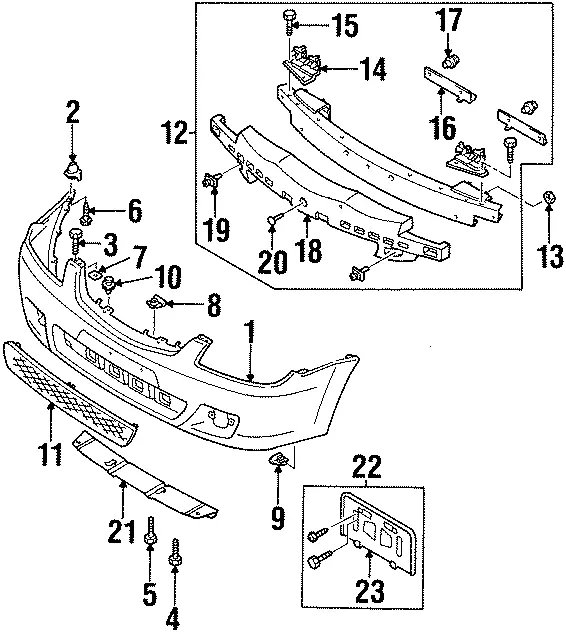

quick questions to anyone, is an air deflector important in the conversion? its on the part list and the ES had an air deflector. its not the same as the "wind splitter" which i think is more visual than functional. its the piece numbered 21 on the attached pic. thanks.
-meGrimlock

I got my msp bumper reinforcement. Could I install the msp bumper reinforcement and put my ES front bumper cover on until my msp bumper is finished getting painted?
I'm more than sure that your ES bumper will fit, because the MSP bumper reinforcement is supposed to be smaller than the ES one.
Well, i had to cut my LX Bumper Reinforcment to make the MSP bumper fit, so i'm just assuming things. But i'm pretty positive that it will fit.
Hmmm... There is a styrofoam piece on that bumper that matches exactly to the MSP front bumper so I dont know if that will interfere with things, and you wouldnt want to crush it.
But Shorebroke brings up an interesting point, I always thought that the MSP bumper stuck out further than the LX bumper. It always looked that way, but hey, looks can be decieving.
