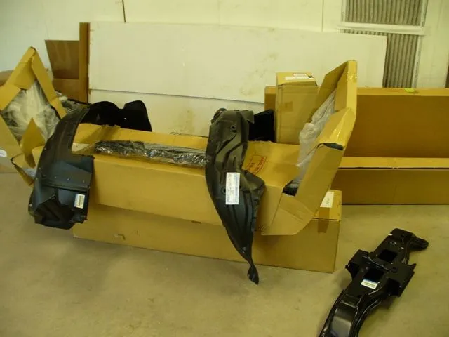

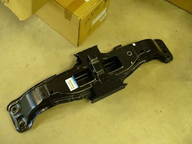

Just got my parts from Ken everything isnt pictured but I have everything needed even all the bolts. I also have the tokico blues from Ken rdy to go on and some msp springs.

No I got the 03 parts including the 03 rear skirt. The black maxima is my rental car while the protege is getting the vtcs fix.

Yeh im still bummed about my motor but ill be happy once I get this installed. Now I need to get the paint I think im going to block sand it all make sure its smooth as possible before I paint the base. I noticed 1 lil spot on the side of the bumper ill need to sand anyway. Im also going to repaint the rear crossmember cause it isnt painted to well just a light coating ill paint it with gloss black laquer it will look good till the first rain haha.I may need to get a few more parts off you also but ill let you know. Ohh I know what I need poly bushings for the sways!
There is a few things im confused on Ken when I was checking off my list.
You had sent me 2 oil seals pn# F003-27-238B not sure what these are for I think you meant to send 2 of ([FONT=&quot]9CF6-00-520) which is a bolt I did not get that was on the list.
Also
[/FONT][FONT=&quot]washer [/FONT][FONT=&quot]9957-83-000 (need 2) I only got 2 and I think this meant 2 sets of 2 lol. I hope nothing else meant that. Anyway I think they are used to hold on [FONT=&quot]J001-50-171 and 2 of the washers r needed for each bracket. To me it looks like the washers hold the bracket to the back of the bumper then the license plate bracket can bolt to them can anyone confirm this?? Lets see one more thing Ill prob want the air dam [/FONT][/FONT][FONT=&quot]B30P-51-9K1B also cause I see where it goes but im not sure if any other hardware is needed for it.[/FONT]

i was a little concerned on a few of the fasteners as they changed numbers when i punched them into the system and after it all arrived i think one bolt came up as discontinued(?). supposedly they replaced them when they shipped to me. PM me a list tomorrow as i am headed over to mazda and i can hammer it all out with them.
