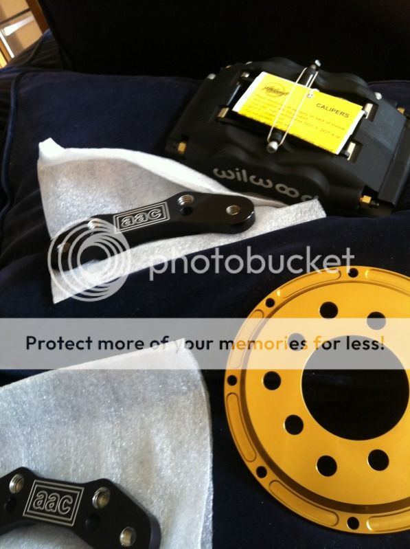

Brake kit in today

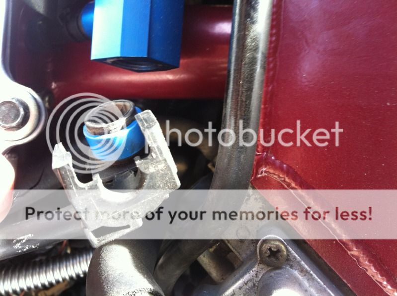

Bump so i still havent got the right fuel fitting to work with the perrin fuel rail its a special factory clamp.
Well i called perrin just now any they say its the same fitting as subaru so they have 1 in stock. I got them to ship that out. Ill post a picture so you see what fitting is missing. I also bought a universal fuel line to go with the perrin fuel rail so im not really sure why they cant install it. Hopefully thiz perrin fitting will work. Has anyone run a perrin fuel rail with just the factory fuel line or do i forsure have to upgrade the line?

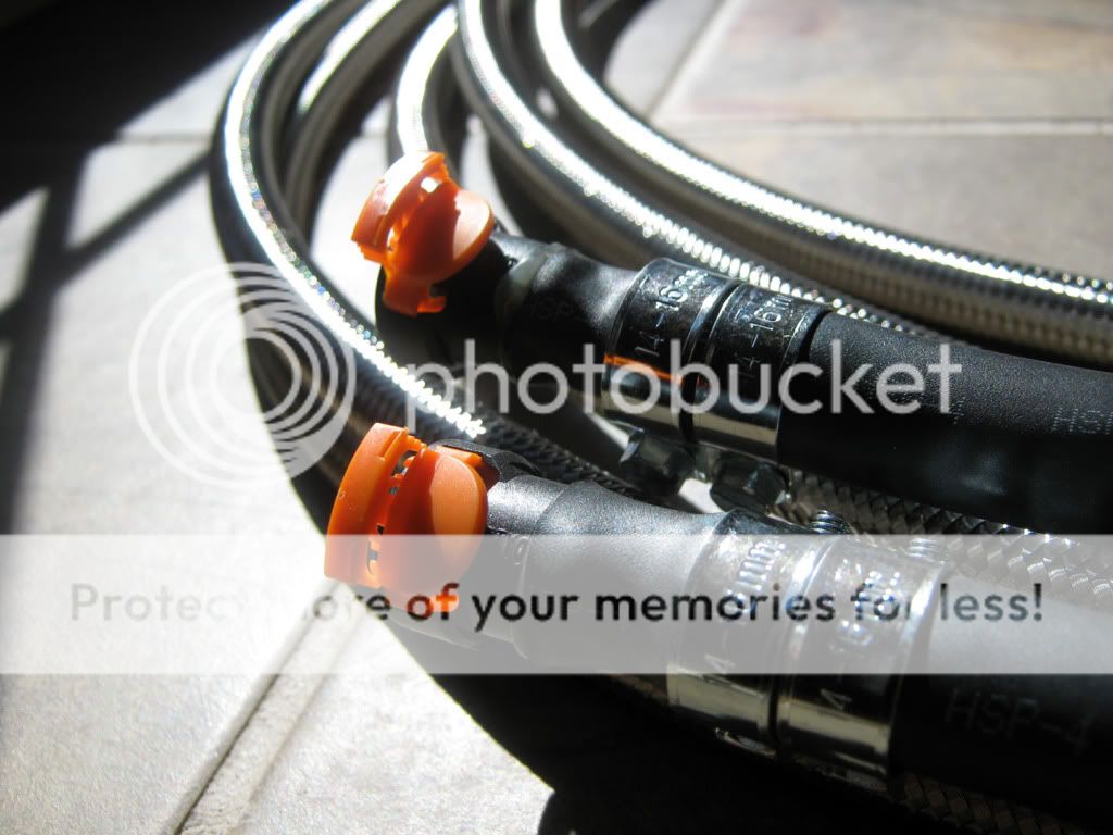

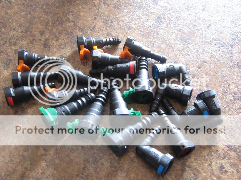

The Perrin rail is 3/8NPT. Run a -6 AN line with a 3/8NPT union to the rail, then you can run the fuel line clips like Brian posted to connect to your stock hardline, OR you can do what I did and flare the fuel line and use a compression fitting. I prefer the compression fitting because it is much more resistant to leaks, however the clip on style are easier to remove should you ever need to pull the rail.

Ya i see what ur saying. I have been patient though lol this build has gone on for a really long time. The only reason i dident go to mopac is because i just orderd a bunch of parts from crossover and thought i would have everything i need. I even orderd the fuel rail install kit from crossover and specified for a perrin fiel rail so im not sure why it wont hook up.

I just did tell you how to properly install it. Pick either a compression fitting or a quick connect like Brian used. Both are available at Mopac. Use -6AN fuel lines and plumb it up.
