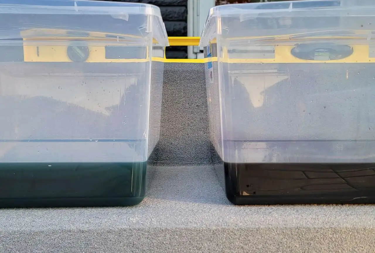

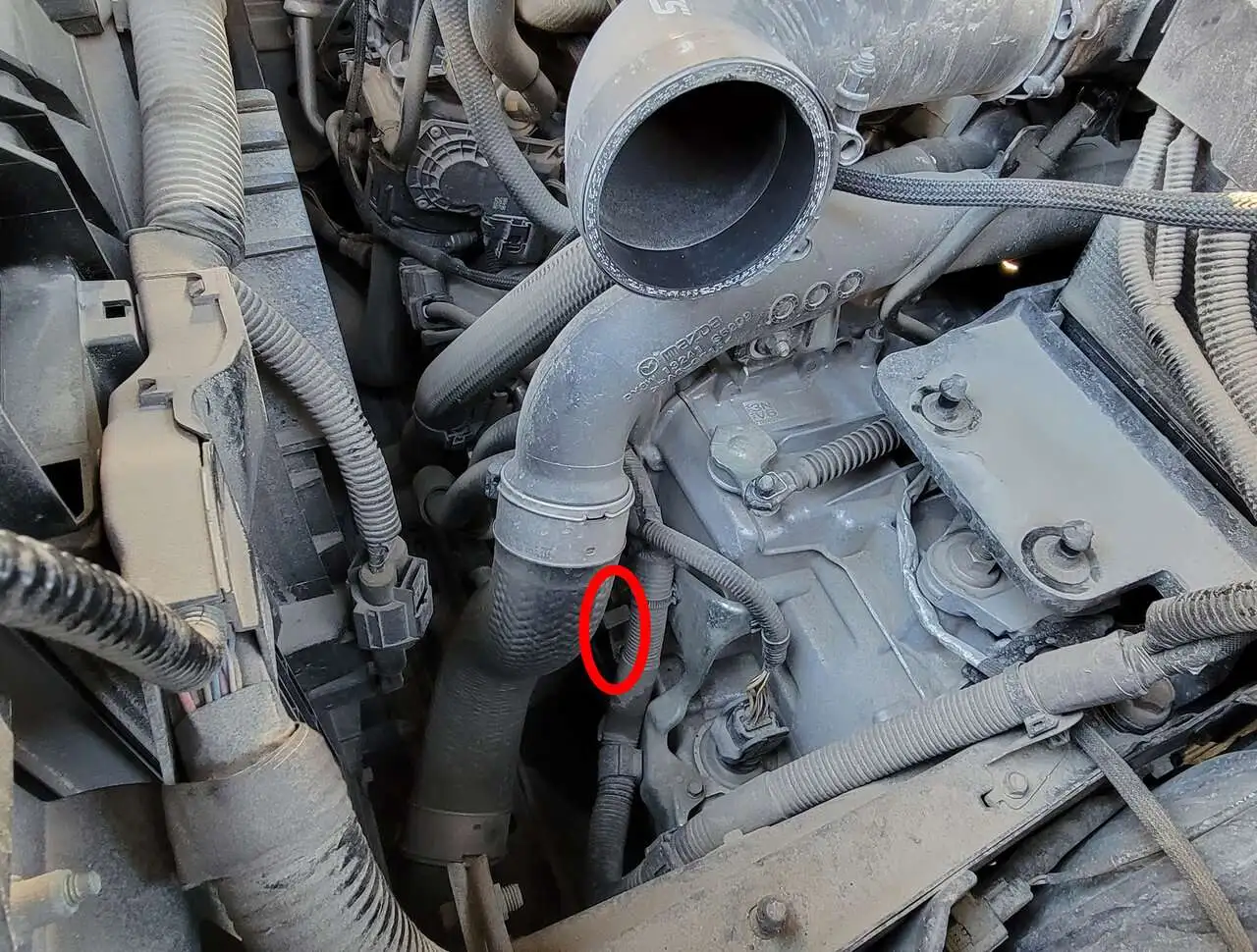

Did a drain and fill on the ATF yesterday. Fluid came out coffee-coloured, and it doesn't smell burnt at all. Drained about 4.5qts to a slow drip from the pan, then let the fluid sit outside with the new ATF to allow both to reach ambient temps. I refilled with the same amount of new Mazda ATF FZ.
This is not the ideal way to do an ATF change as the service process calls for allowing the fluid to reach 122*f before taking a reading on the dipstick to ensure the level is correct. I did not have any issues with the transmission before the drain and fill, and the fluid came out looking fine, so I decided to just refill with the same amount that was drained out (after allowing both fluids to reach the same ambient temp).
Removed the air filter so I could access the dipstick. It's a little tight in there, thankfully I had a small ratchet handy. The transmission dipstick is circled in red.

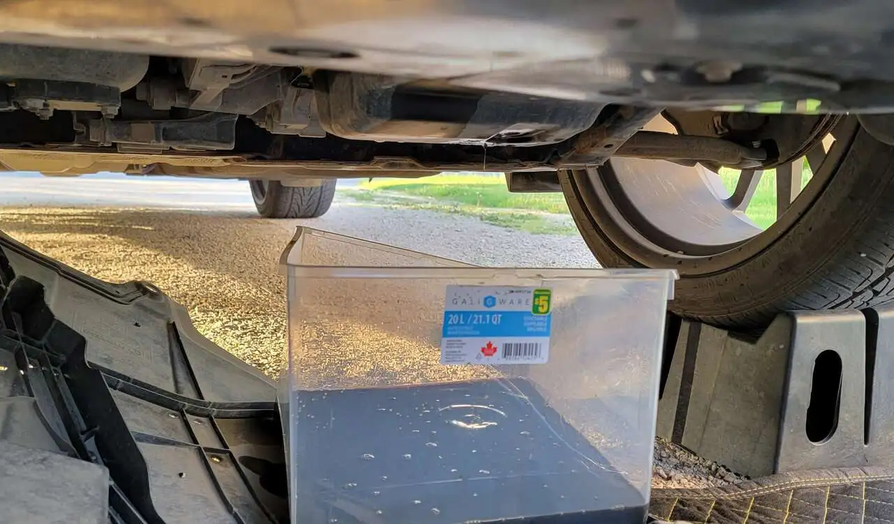

Lowering one side of the underbody plastic shielding to get access to the transmission drain plug. This was the most time consuming part of the fluid change, because I was using hand tools and there are about 8 screws and 6 plastic fasteners to remove if you want to take the whole panel off. I removed the 8 screws and 4 of the fasteners before realizing I could just pull the plastic down and have enough room to do what I needed to do.
New fluid vs old fluid.

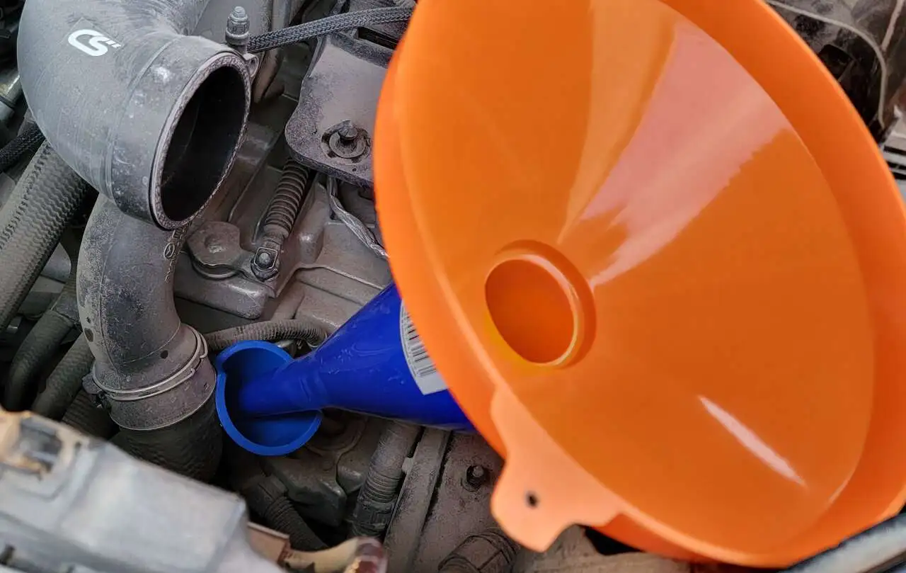

3 funnel set up to fill.

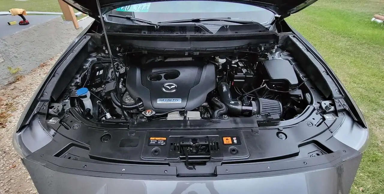

Changed the oil over the weekend, at 96k kms now.

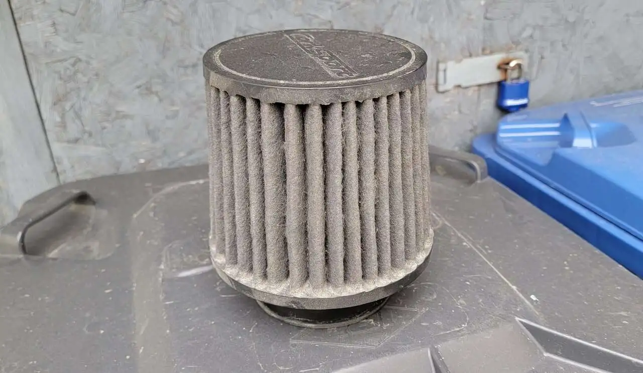

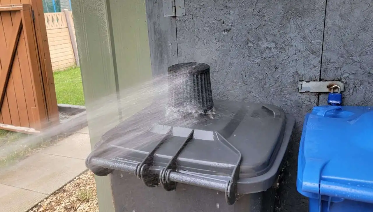

Today I cleaned the engine air filter (AEM Dryflow).
While waiting for the filter to dry, I decided to clean my nasty engine bay.
Much better!
Here's a quick video of me cleaning the engine bay:
