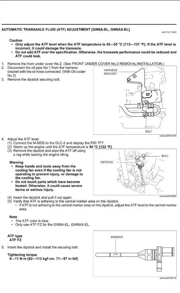

Car moving while the the automatic transmission is in Park position has nothing to do with ATF level. There’s a parking pawl that locks up the transmission gear to prevent vehicle moving. Try to test your CX-5 again on a slop carefully. If the transmission in Park failed to lock up the car moving again, you have bigger problem. Always use parking brake to prevent the damage to the parking pawl or the engaging gear:
If the ATF dipstick is still in place not coming up and loose, I’d say the damage is minimum to have the dirt getting into the transmission.
But you have to add ⅔ quart to bring the ATF level from “minimum line” to the “mid level”? Firstly there’s no minimum line and mid level mark, only a small section of “central marker area” for proper ATF level at 50°C / 122°F while the engine is idling. Secondly adding ⅔ quart of ATF seems to be a lot as the total ATF needed is only ~3.75 quarts for ATF drain-and-fill.
Thx for the reply with useful info. wonder if a certain notch on the transmission gear is rounded off and I only have problems when I hit that notch? I’ve tested and couldn’t recreate. Maybe only a half quart was added since I spilled a bit trying to make it to the funnel deep in the engine bay.
