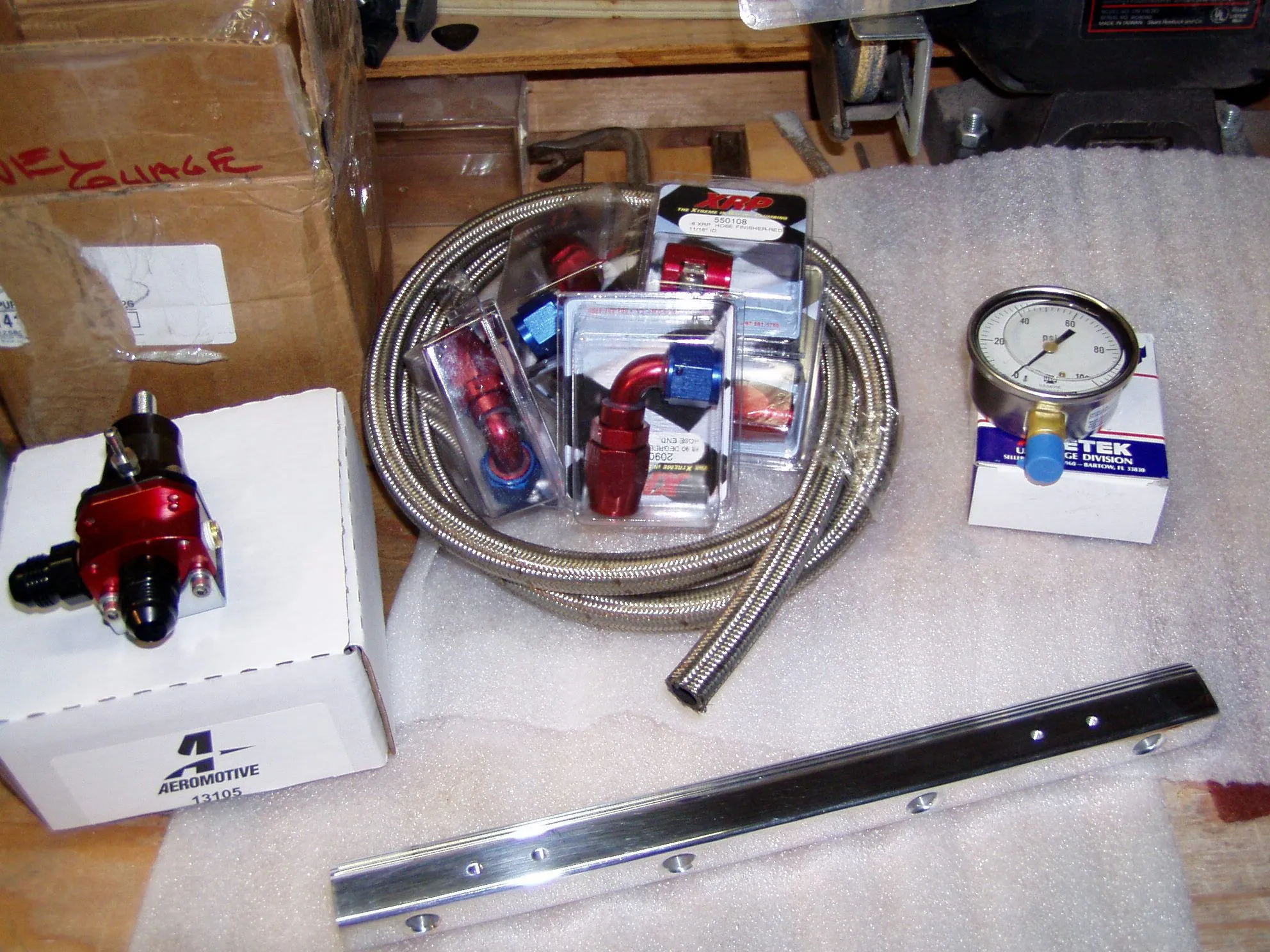

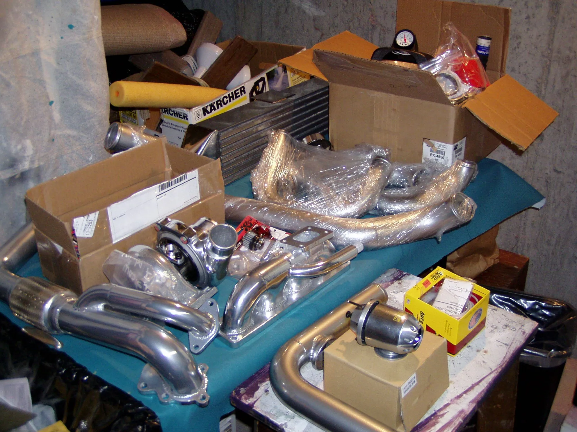

doin some stuff in the yard before the bad weather comes...really getting going tomorrow and next week. been layout all the parts and rereading the directions. goin to get the oil bung installed. i'll post some pics as i go along!!
