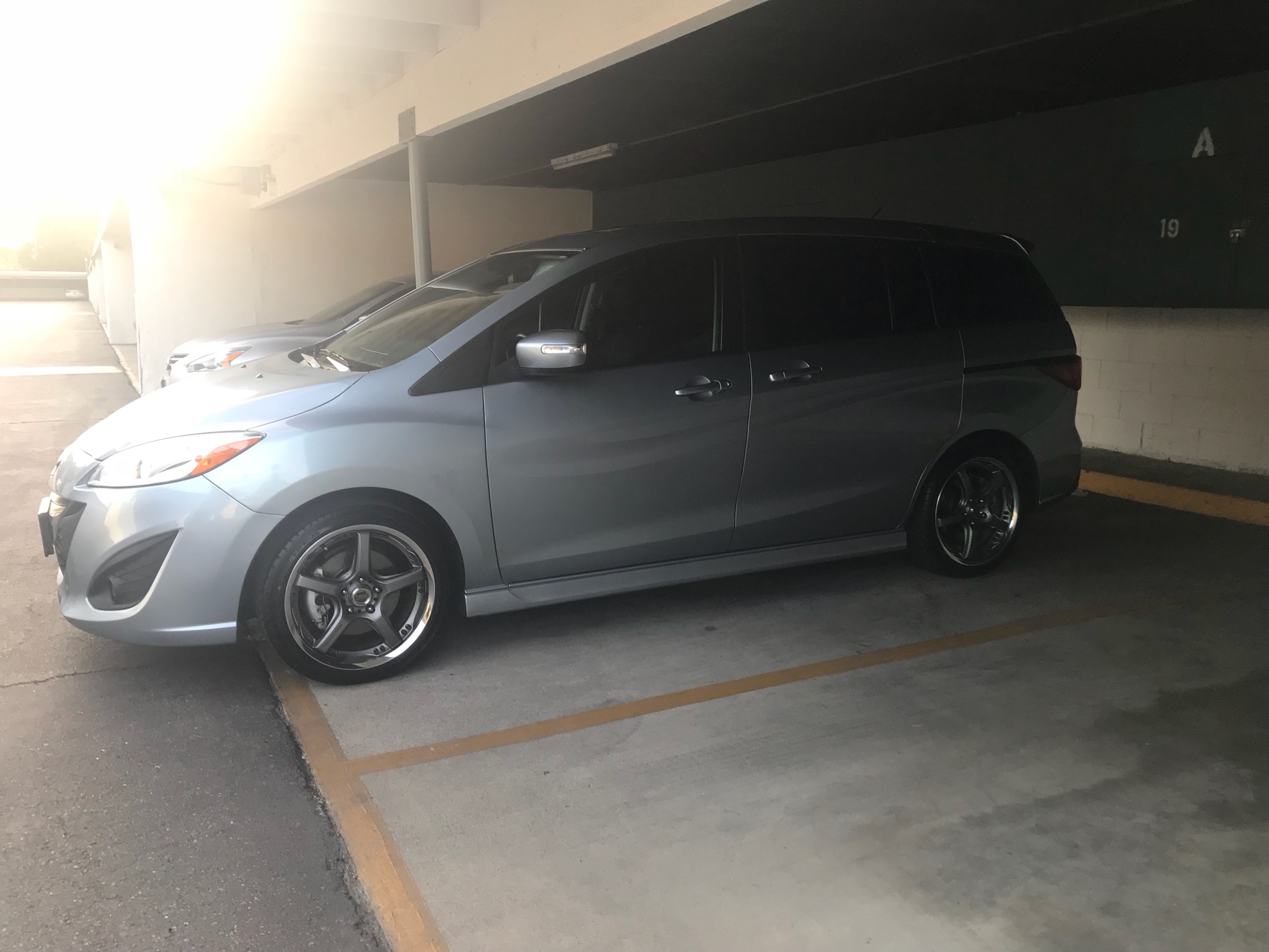

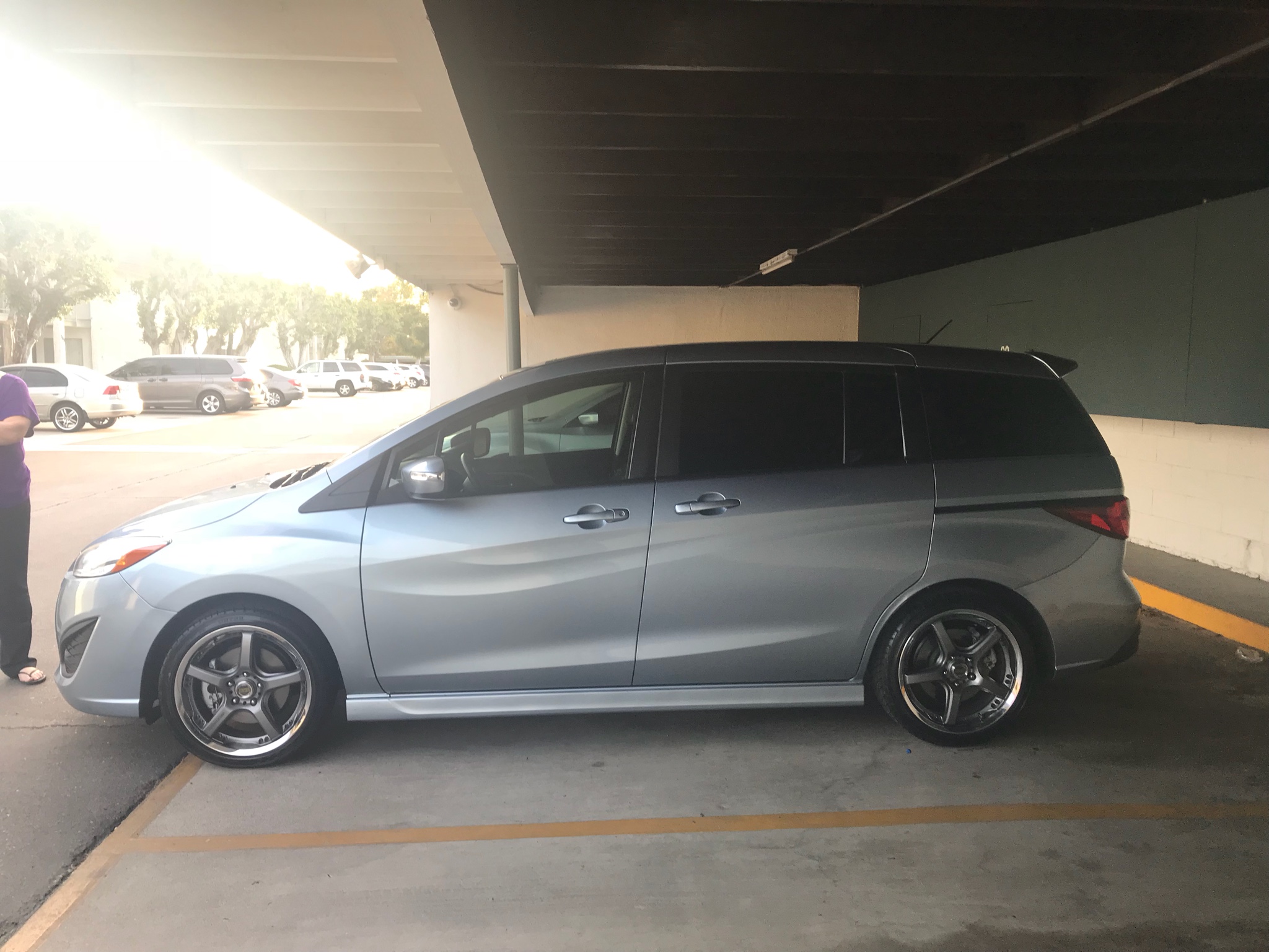

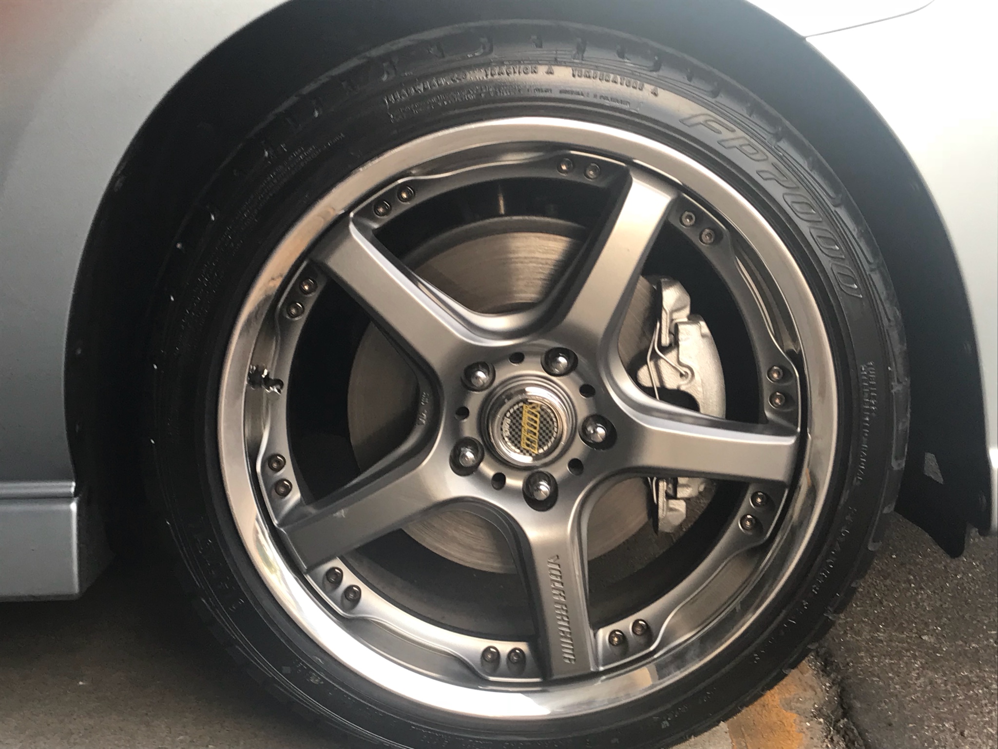

So I ended up buying a 2013 Mazda 5 Touring. Still getting used to driving a van but so far so good except for the body roll on this thing sucks but I’ll address that soon hopefully. I also went with 18’s instead of the 19” R3 Wheels I had originally got for it. Went with a set of 18x7.5 Volk GT-S in gunmetal with 225-40-18 Ohtsu Tires. I’ve used these tires before and they are solid tires especially for the price I got them for ($200 shipped!) so far pretty happy with the look
Thoughts?
Looks great
Thoughts?
Looks great

Thanks man. Yeah I have thought about HID will hit you up when I’m ready. I got a couple other things already lined up that I’m doing next on it

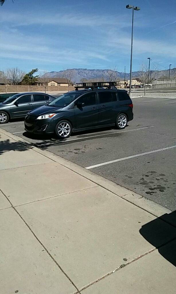

I'm far behind many on the forum in terms of upgrades/mods... My major wheel "mod" is getting 16" Mazda6 steel wheels, putting stock size winter tires on them and running them for about five months out of the year. (cabpatch) Not the classiest look, I suppose, esp. given that I have a relatively bare-bones 2014 Sport but it works quite well for what I need! I actually kind of like it.
JOSER_SPEED6: great looking vehicle (and wheels, of course)!
Thanks! Black on black looks good! My other car is a 2014 Mazda 6 Touring in Black with black wheels. So I like that color combo like you have too. I actually really wanted a black Mazda5 but this one was what was available for what I wanted to spend at the time I was car shopping. The baby blue is not my favorite color but since putting on the new wheels I think it makes it more tolerable for me.
