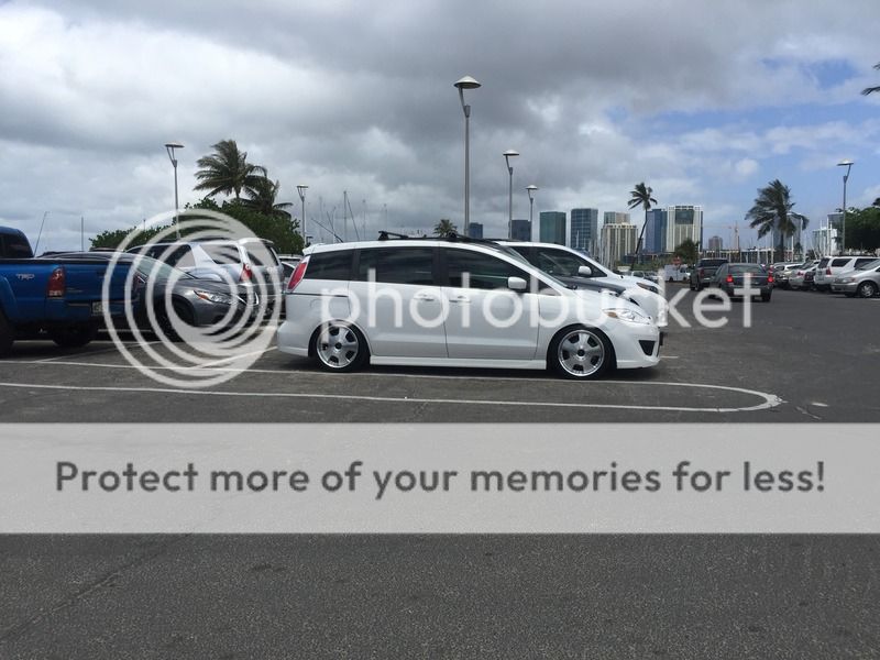

Yes I did on my 2014 went aftermarket rim a 7.5 wide and 235 45 17 and going over bumps fender would hit at one pot hole hit so hard bent my fenders both rear I had to bend back into place so keeping new rims going back to factory size till they wear out then I am getting 225 45 17 that's about 8 1/2 " of rubber on the road and will not hit fender and can have passengers now !!! I think factory rims would be good if they weren't only 6" wide ! Good luck with upgrades!!!

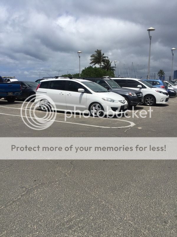

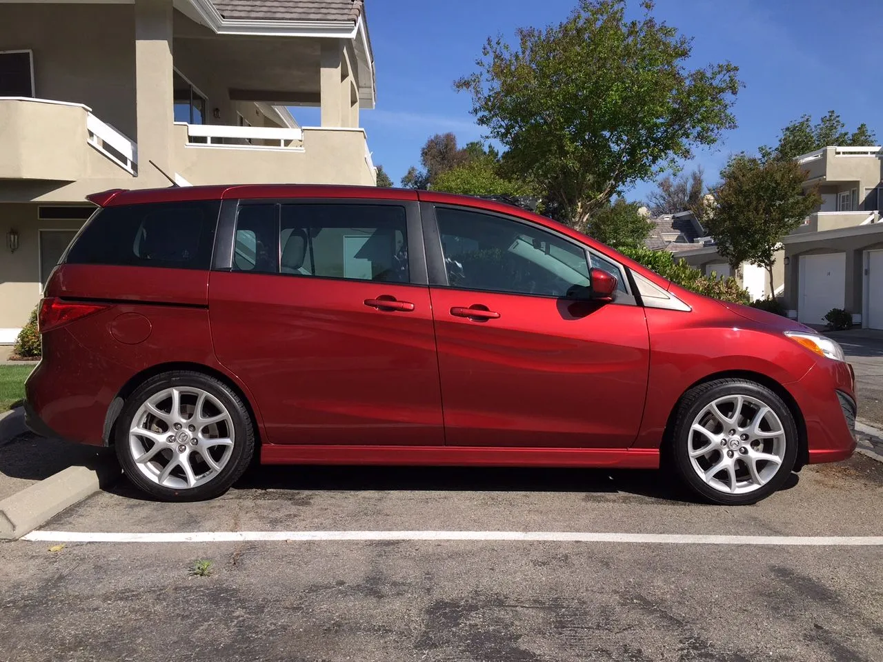

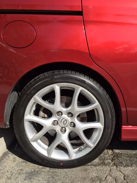

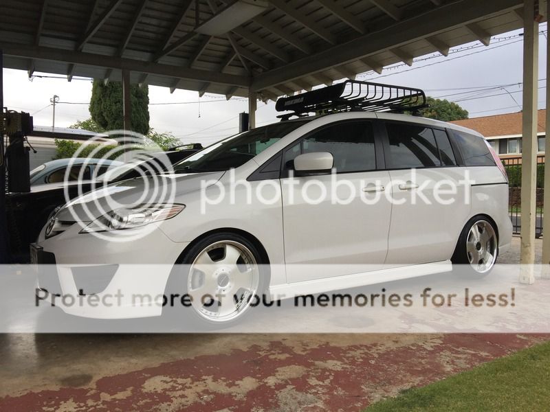

here is mine on 225/45/18
same for 4.5 years

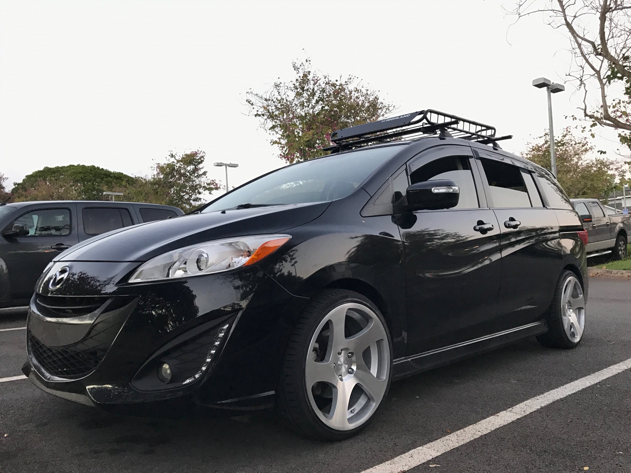

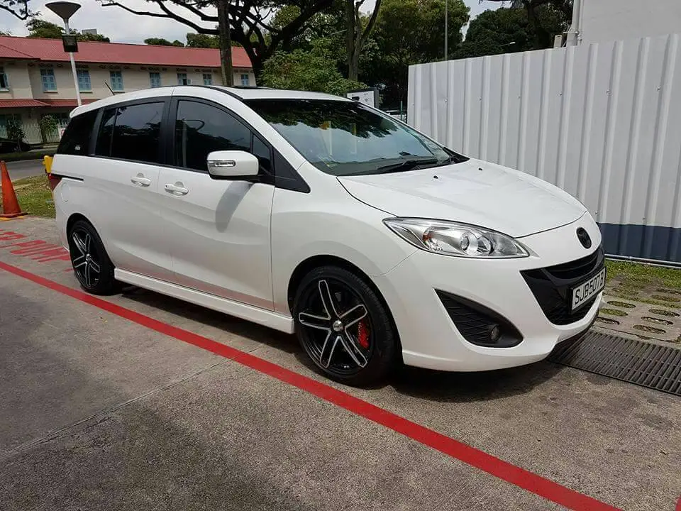

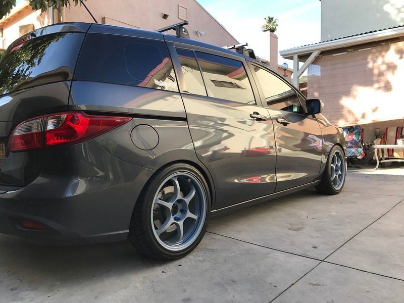

New set up for 2017
Specs: 18x7.5 +31 wrapped with nitto neogen 225/40/18
18"x8" Advanti Rims. Offset 45
225/40/R18 Pirelli PZ4 Tyres
Sent from my SM-G935F using Tapatalk

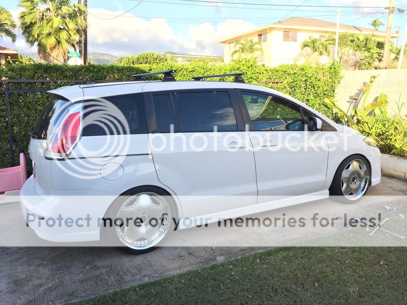

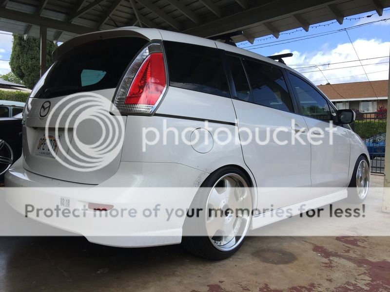

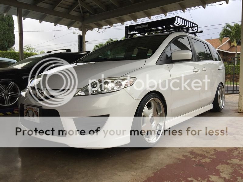

D2 coilovers taken out of a mazda3, 18x8/9 +38 ssr Vienna dish, 205/40 front, 225/40 rear.
19x8.5/9.5 +41 locksmice dukes, 225/35 front, 245/35 rear

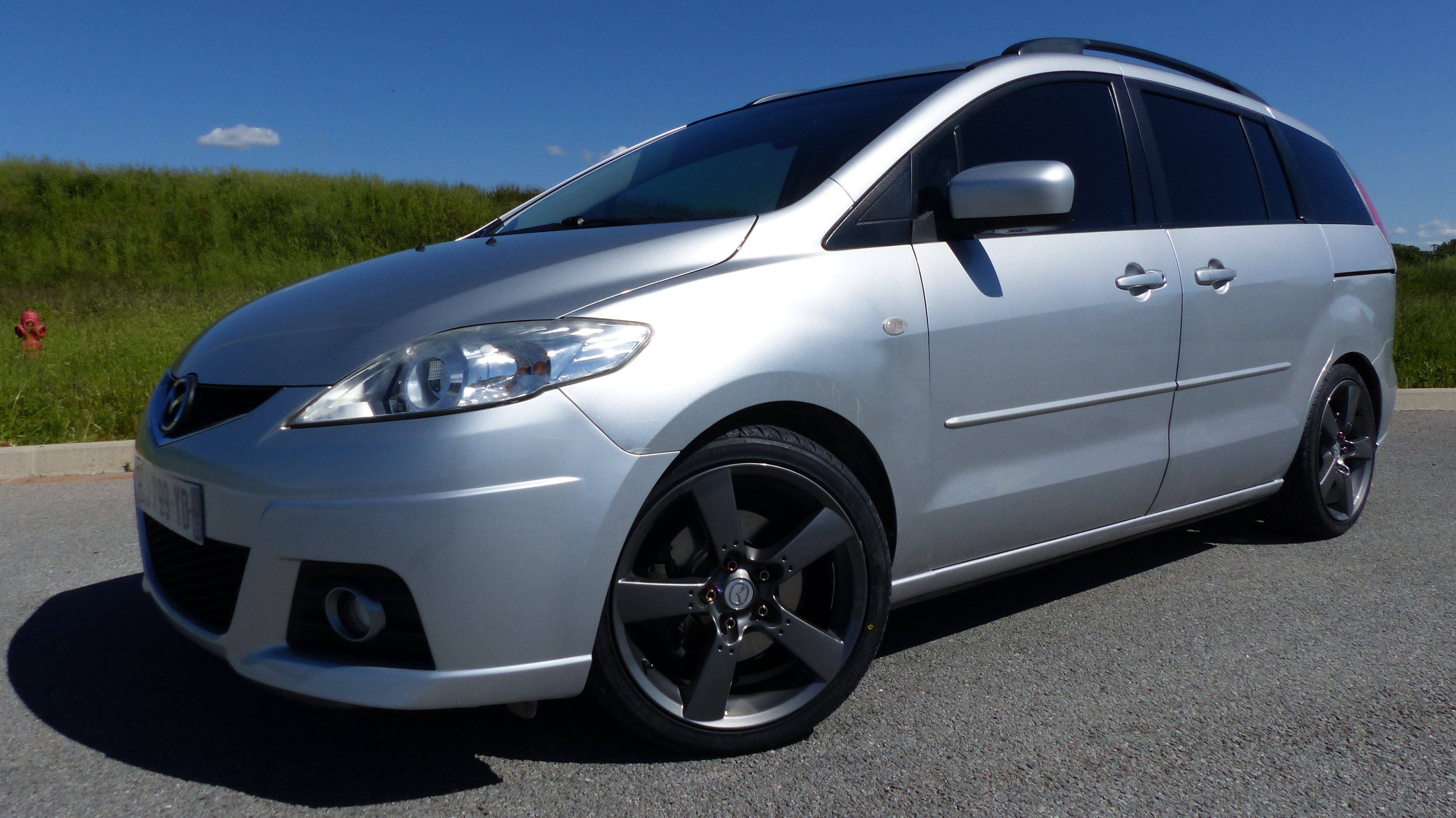

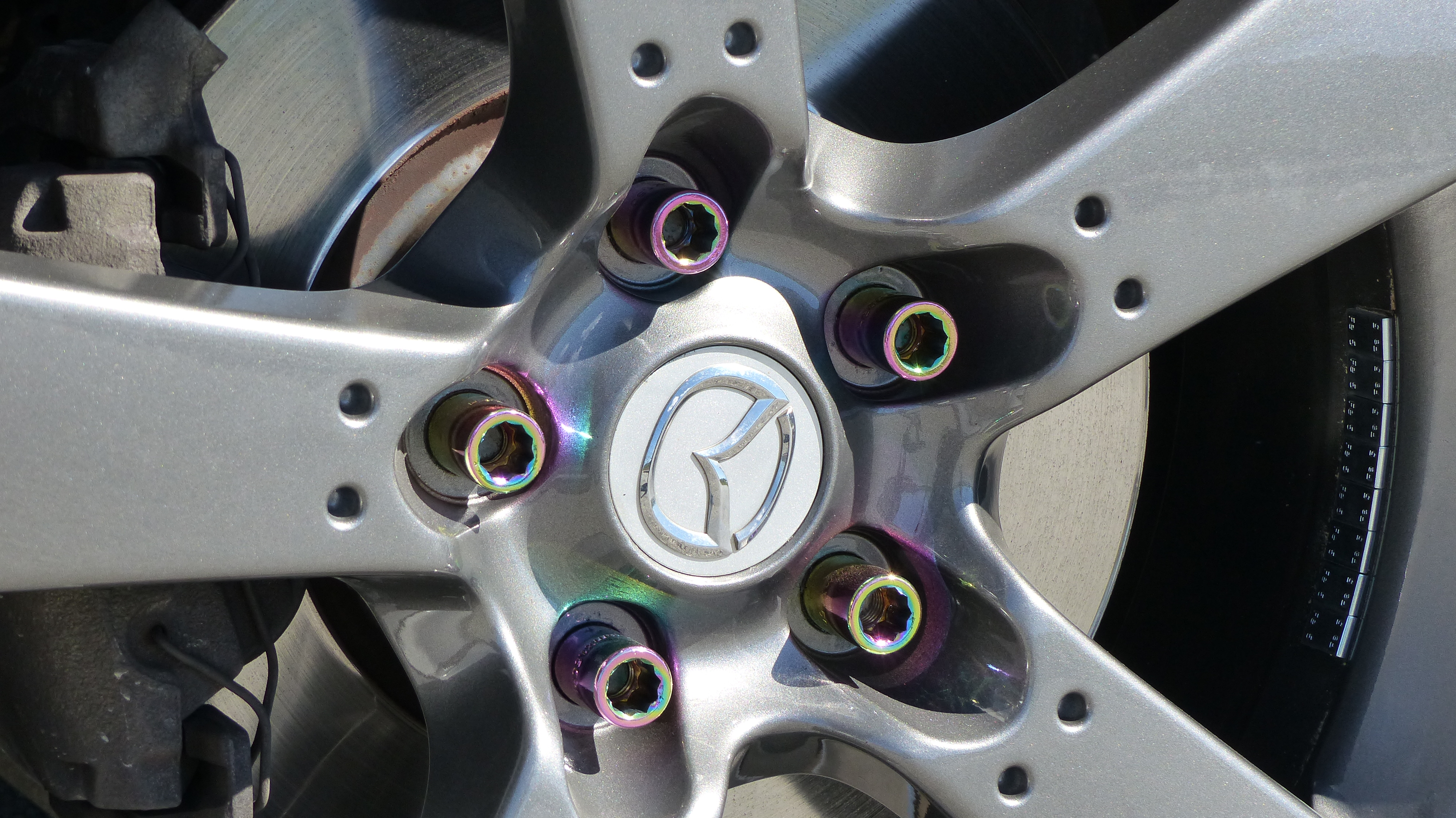

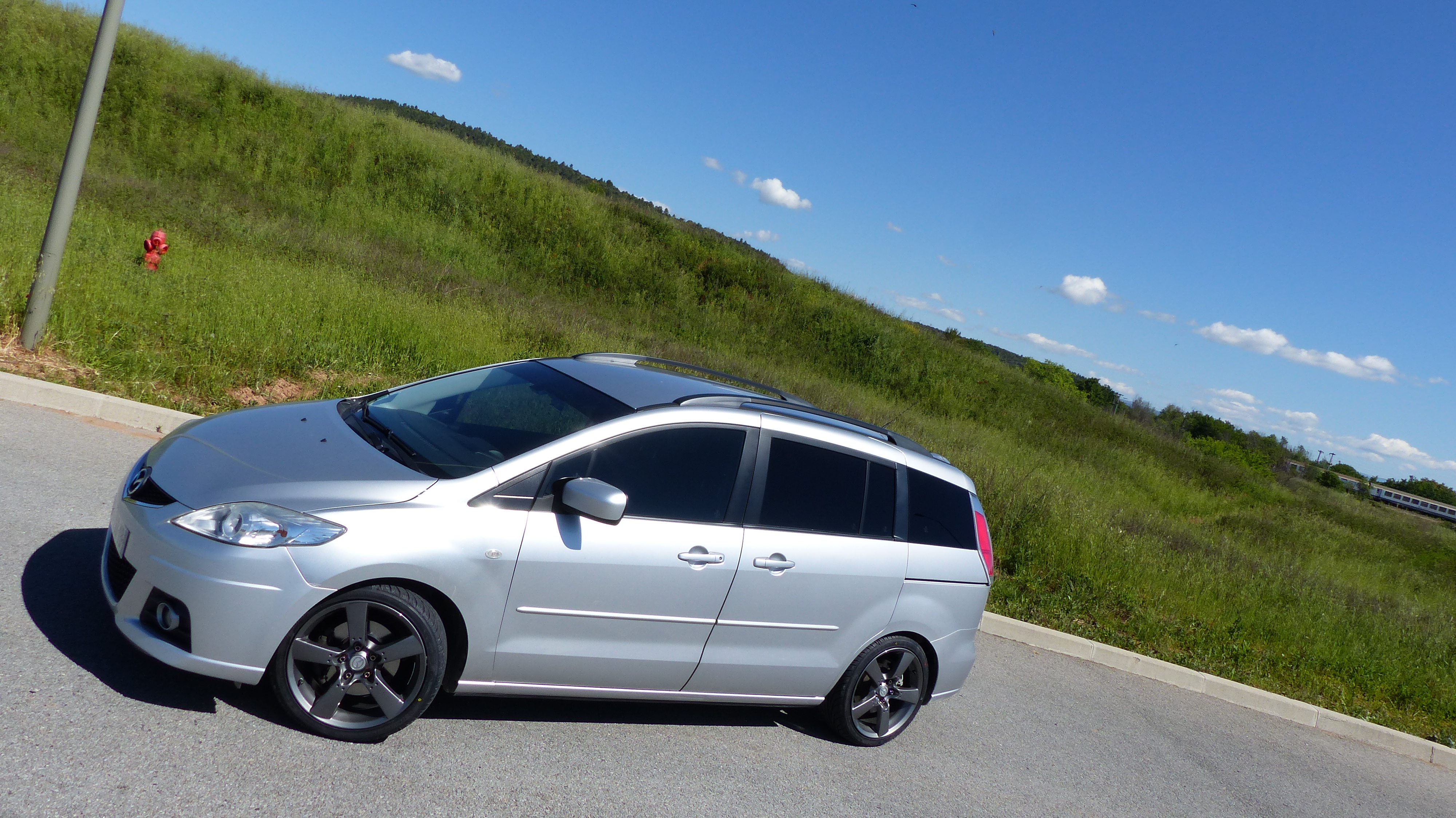

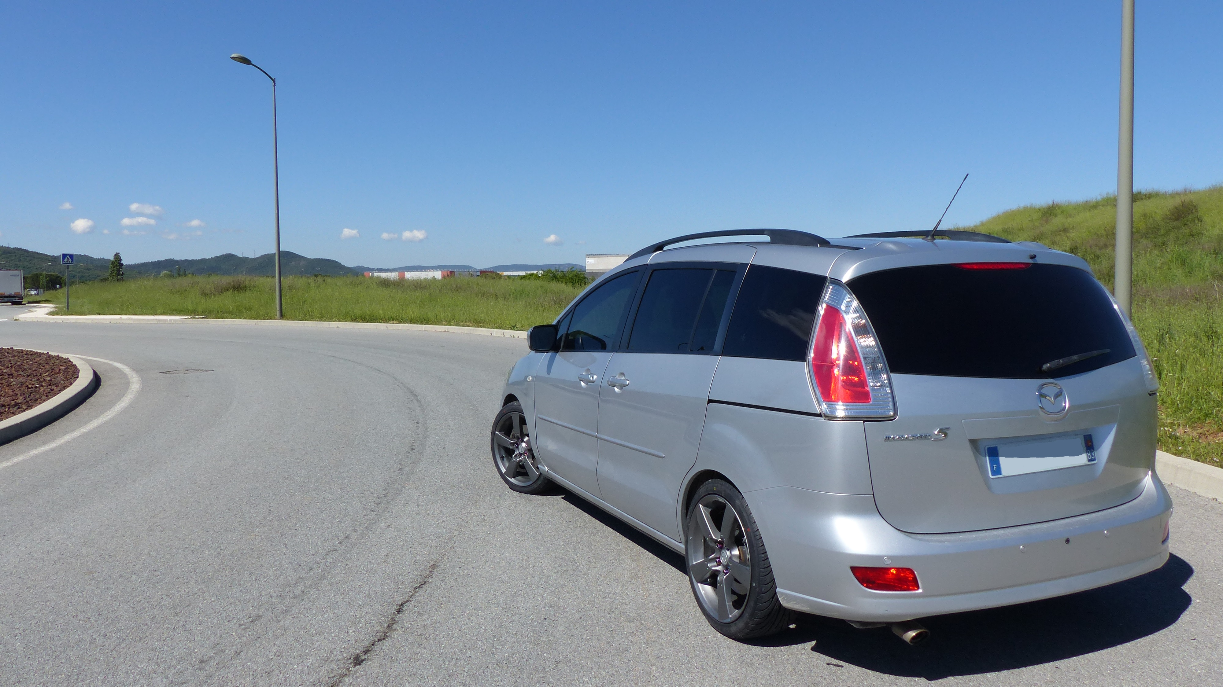

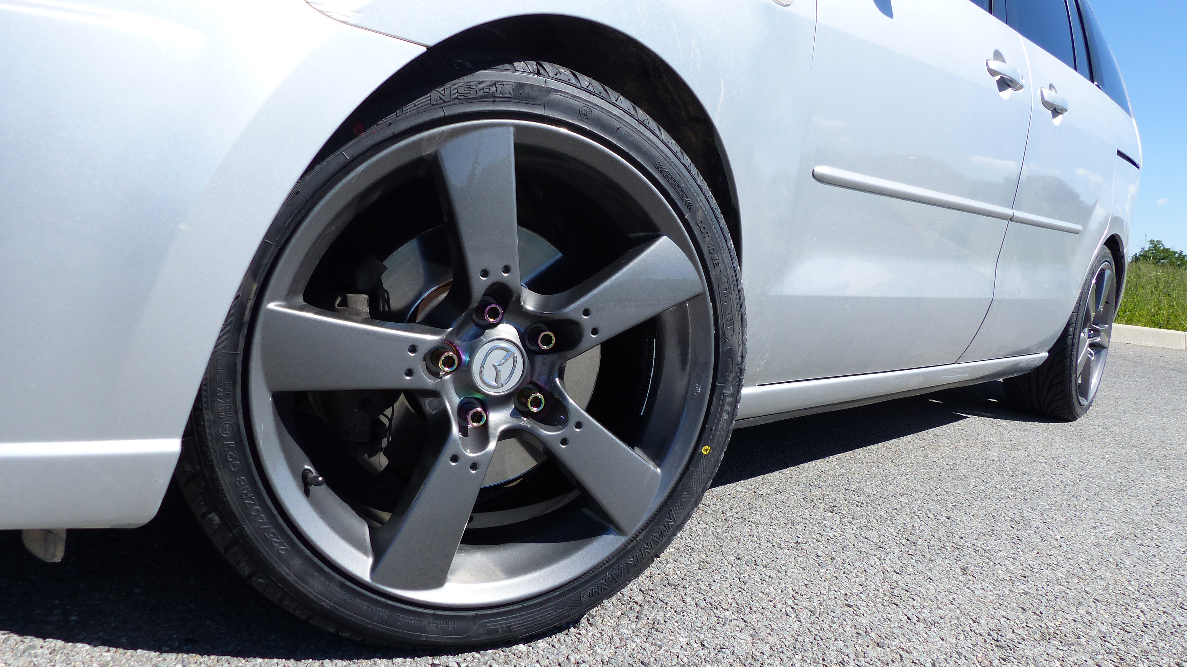

New rims, after my 17 5zigen 5ZR setup, welcome Rx-8 rims with 225/40ZR18 Nankang NS-2 SuperSport tires :-) and -30 Eibach short spring !!!
I love my Five !!!
^^ nice and clean. Can you share the part number for the eibach? Is it for Mz3 or Mz5? Reason why you choose eibach over H&R? Also what shocks are you using?
Thanks silentnoise.
This is the ebay link for Eibach kit, it's for Mz5 :
http://www.ebay.fr/itm/361308302158?_trksid=p2057872.m2749.l2649&ssPageName=STRK:MEBIDX:IT
Part number : e10-55-009-01-22
I choise Eibach kit because the price are lower and the quality is good, i've a eibach lower spring kit for my another car (clk 200 kompressor convertible).
I've stock shock absorber but news.

Thanks for the link. I like Eibach too, top notch in my book, and I've used them in the past.
I see these are only for 1.8 and 2.0 engines. Be interesting to see how much of a weight difference they are compared to the US 2.3... With your current setup, have you tried riding in the 3rd row to get a sense of how it feels as a passenger?
Yes, in France, we have only 1.8 and 2.0 petrol engine and 1.6, 2.0 diesel engine.
I don't know for the 2.3L engine but diesel engine is heavier than petrol engine.
For petrol engine :
- Front Axle Load kg = 1035 Kg / 2281 lbs
- Rear Axle Load kg = 1205 Kg / 2656 lbs
For diesel engine :
- Front Axle Load kg = 1130 Kg / 2491 lbs
Eibach Pro Kit parts number : E10-55-009-02-22
Do you know the 2.3 axle load ?
I just check Eibach USA site, the Mz5 not exist (yawn)
I have no problem with 4 passengers with baggages but i don't have test with 6 passengers.

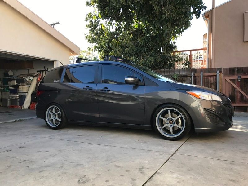

I have a S2000 with RPF1 17x9+45 rear with 245 tires and 17x8+45 front with 225 tires.
Will I be able to reuse those rims on my Mazda 5?
Little feedback come back to holidays, with the rx8 wheels and eibach short spring, 6 passengers with some baggages, no problem, the wheels work great (limb)
Appreciate the update! The diesel spec spring would be a great alternative without breaking the bank. Too bad we can't get them in the US... :(
