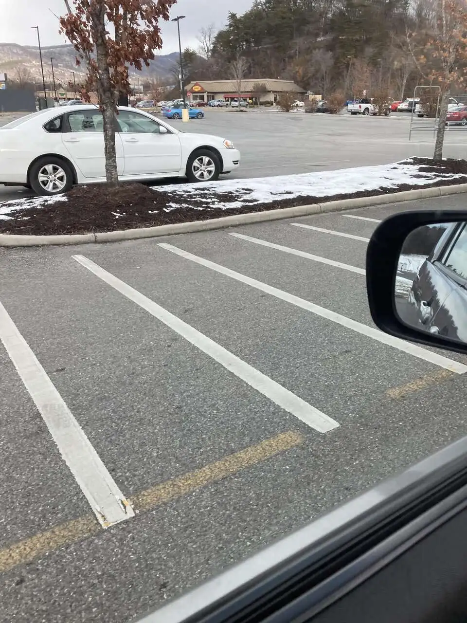

Ive attached an image over some painted rumble strips and a video of the sound that comes from the rear when I drive over them. I’m just wandering if this is a normal sound as it has made this sound since I bought it from the dealership in 2020. It doesn’t seem to be getting worse, but it’s very annoying.
