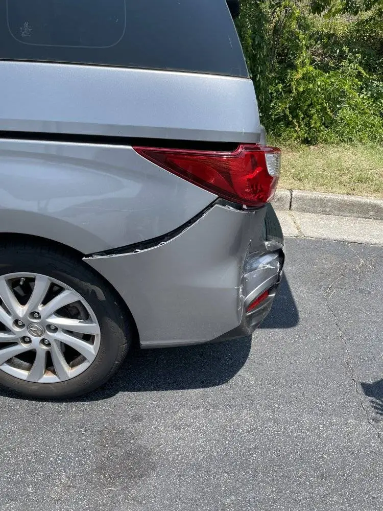

So coming home from 4th of July with my in-laws we got rear ended on the highway. After weeks of playing hide and seek with my insurance co. (Absolutely not our normal experience) the other driver’s insurance accepted all fault. Dropped the car off on Friday, and then not a peep out of them. Called the body shop yesterday and they said they sent in their estimate Friday night….. so geico has been not-approving repairs for nearly a week now.
The estimate was for a little over $3000. There damage to the quarter panel under the bumper cover, and the gap with the sliding door is off. It also blew the left strut mount. Sort of wondering at this point if they’re just going to total it out.

Update on this. After a week Geico finally decided to approve the repairs to the car and the body shop got started. The quarter panel in by the jack was crushed inwards, it broke some of the welds between the panels As well as some of the plastic interior pieces. Not sure if they’re able to pull that out or if the whole panel is being replaced. When I last spoke with the body shop their suspension person hadn’t been in, so they hadn’t pulled apart the strut at all. They said they were going to finish the other repairs, and then put it on the rack and do the suspension stuff afterwards. They did pull the front bumper cover off to check for any other damage because the impact popped the cover loose.

What I’m not cool with is they said they determined the popping/clunking noise from the front end was the fault of a worn suspension, specifically they noted play in the front/rear sway bars, and in the right side swaybar end link. This was determined by a 2 mile test drive, and a brief inspection and grabbing/pulling on things with it on a lift. I respectfully requested they open the hood, bounce the front end and watch the mount move inside the strut tower with their eyes…. A step they had not taken. Regardless of that Geico (other person’s insurance) denied the repair stating: 1) the suspension components were worn and likely why they were broken, 2) this wasn’t part of the initial damage estimate, and because it was a supplemental add on they concluded it was just there and unrelated (their suspension tech wasn’t there that week), 3) a front suspension component is unlikely to break during a rear collision.
I called both the body shop and Geico to try and get this resolved before picking up the vehicle. I informed them the front suspension was about a year old with only ~10,000 miles on it. I informed them the noise started immediately after the impact. I informed them other work had been done on the front end a month earlier (control arms-original and worn, and right strut mount-damaged in a pothole) and the mechanic specifically checked the driver’s mount at that time and it was solid; I am a little irked with my mechanic because I purchased and provided FSB bushings for them to replace, but they didn’t because the strut mount was broken so that was likely the culprit of the noise. I informed them “unlikely” does not equal “impossible”. I informed them I was impacted after a rapid stop from highway speeds, and the front suspension was completely loaded at the time of the impact (meaning there was no give in it like normal), and there was enough force to dislodge the front bumper cover. Their only response was to take it to a Mazda dealer for a diagnostic, and if their technician agreed it was because of the impact. They said I could submit findings from my mechanic, but they’d go with whatever statement the Mazda diagnostic gave them.
