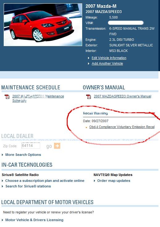

i noticed this on mymazda last night-
would this be the recall we are talking about here?
Edit- I just got off the phone with my Mazda dealer (Blue Ridge Mazda in KC) and they didn't know about the recall but found it when i asked.
I have this listed in MyMazda too. I wonder if we can get more details about it somewhere.

There is a recall concerning:
Obd-ii Compliance Voluntary Emission Recal
Q: Why are some of this type of vehicle involved, and others are not?
A: Recalls are vehicle specific and are issued for certain vehicles based on the production date and component. If your vehicle is not affected, it may be because it was built at a different time or using a different part than the affected vehicles.
