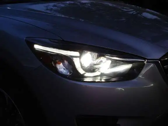

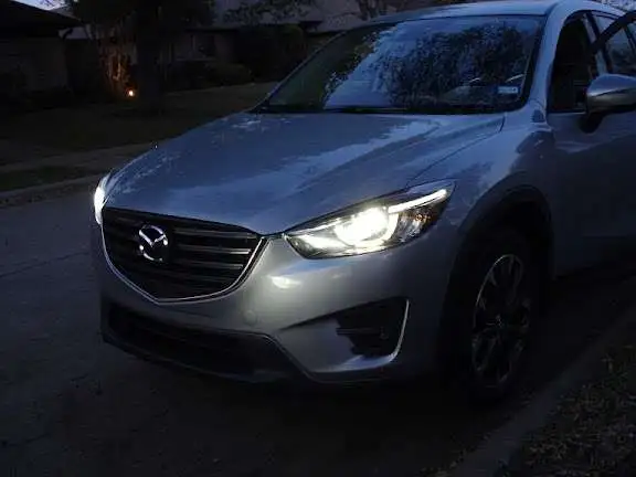

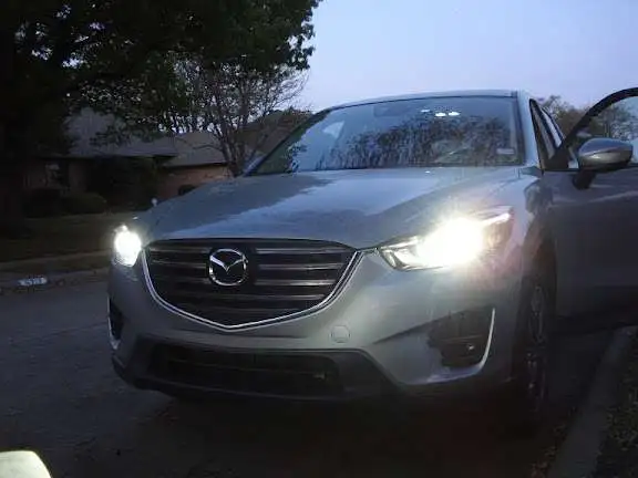

Can you tell if the CX-5 has LED headlights?
Upvote 0
If the CX-5 is a Touring and it has heated front cloth seats, your girlfriend should have a 2016.5 CX-5. 2016.5 CX-5 Touring is the only MY came with the heated front seat on cloth. Then the 6/2015 manufacture date contradicts that and it’s a 2016 CX-5 as the 2016.5 MY started in 2/2016.

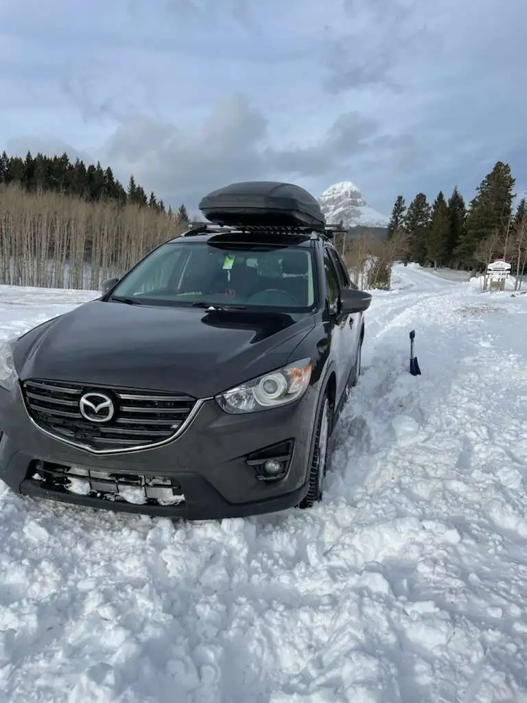

I did a google image search of my photos (love that function) and I found a random picture of the car. Excuse the grill and fender, she's been hit and run twice now. I'll be going after that as well. And yes, she was stuck. Anyone with lift kit ideas let me know... lol
So these are some kind of LED projector headlight by the looks of it to me. It does have heated cloth seats.

⋯ So these are some kind of LED projector headlight by the looks of it to me. It does have heated cloth seats.
No, the projector headlights in picture are the regular halogen headlights. The LED headlights on Gen-1 2016 / 2016.5 CX-5 have the LED accent strips / halo’s as the DRL / parking lights. Here’s my 2016 LED headlights with amber parking lights disabled.
Are you in Canada? When I said heated front cloth seats are only on 2016.5 CX-5 Touring but that’s applicable to US market. Canadian GS trim equivalent to US Touring can have heated cloth seats for many model years.
