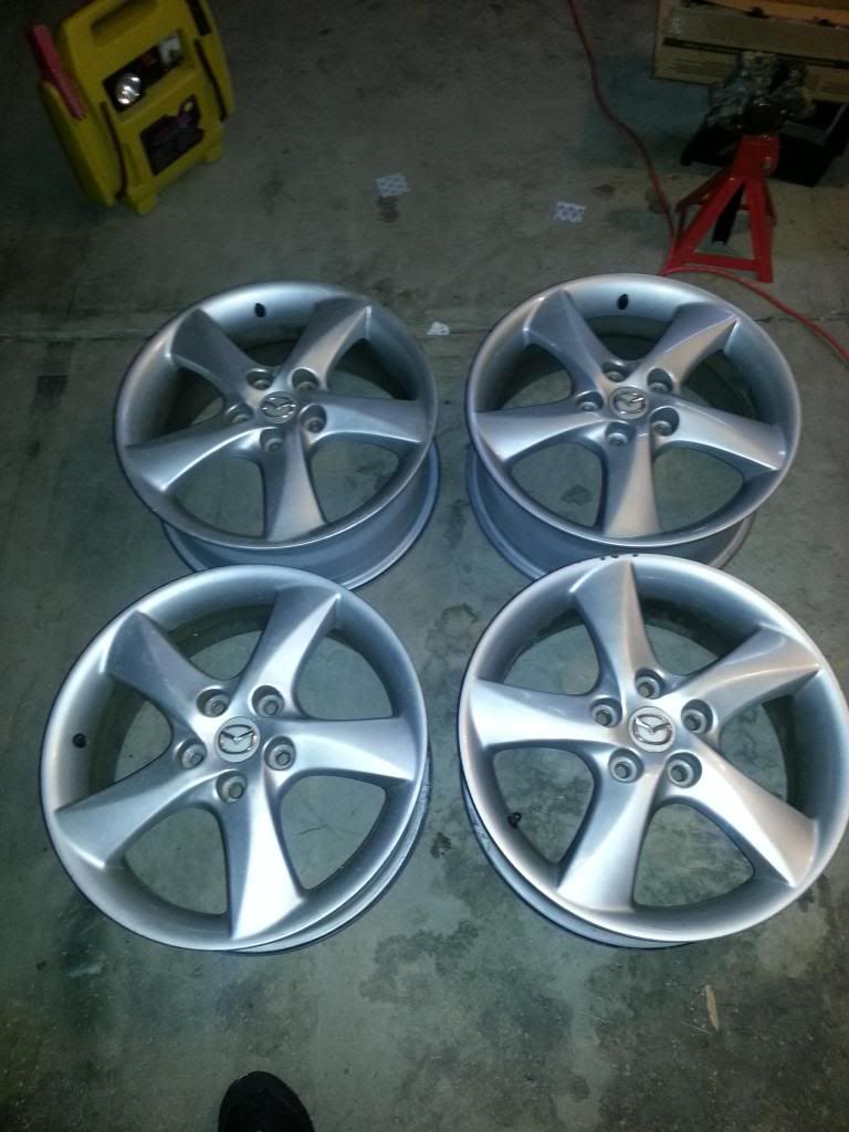

Hey Will Mazda 6 17" Rims fir on MY Protege 5? Bolt Pattern is the same and i test fitted one and it seems fine but the rim didn't have a tire on it. I have a set of "215 55 17" tires.

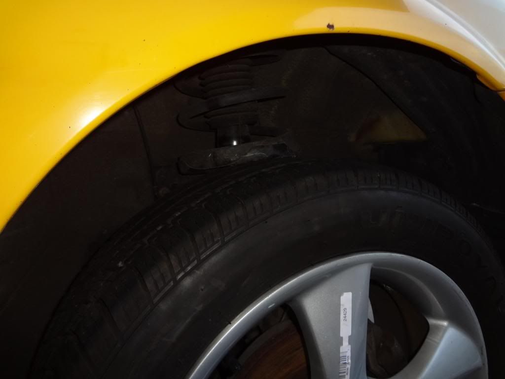

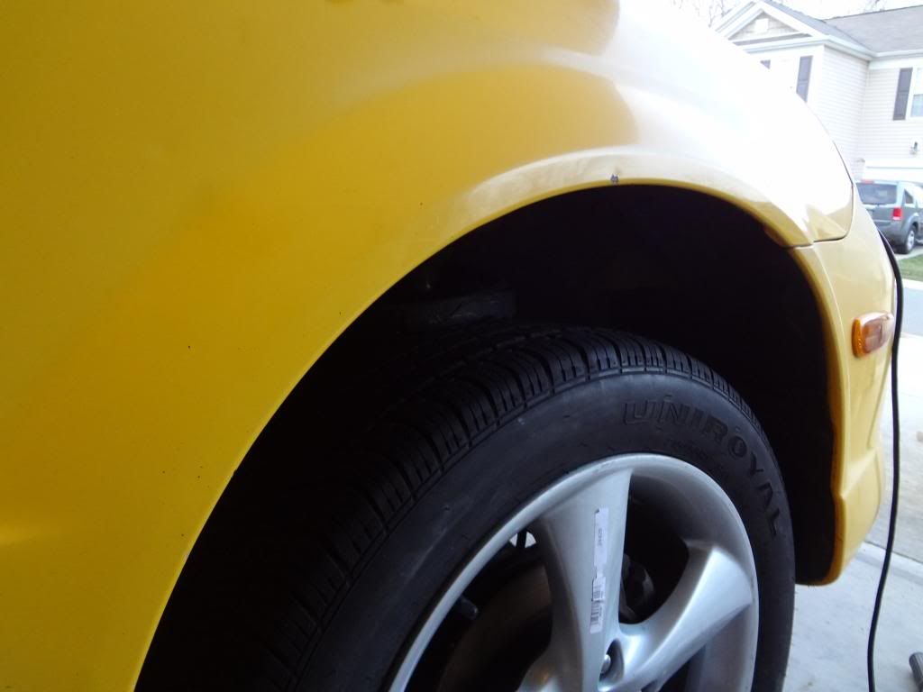

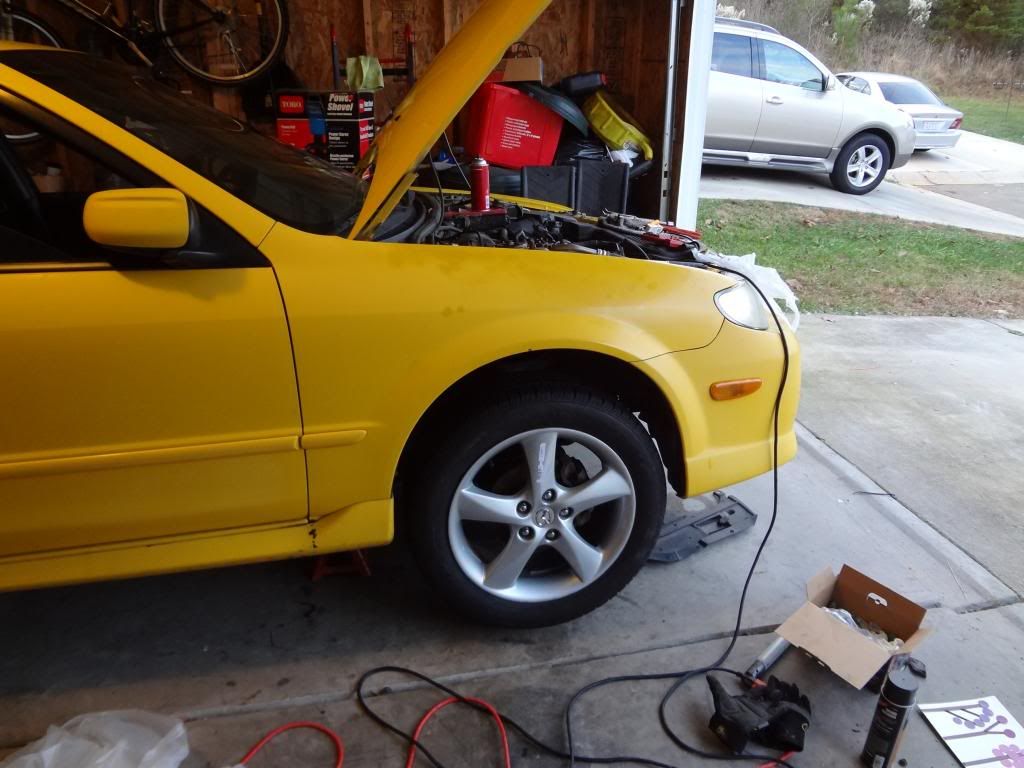

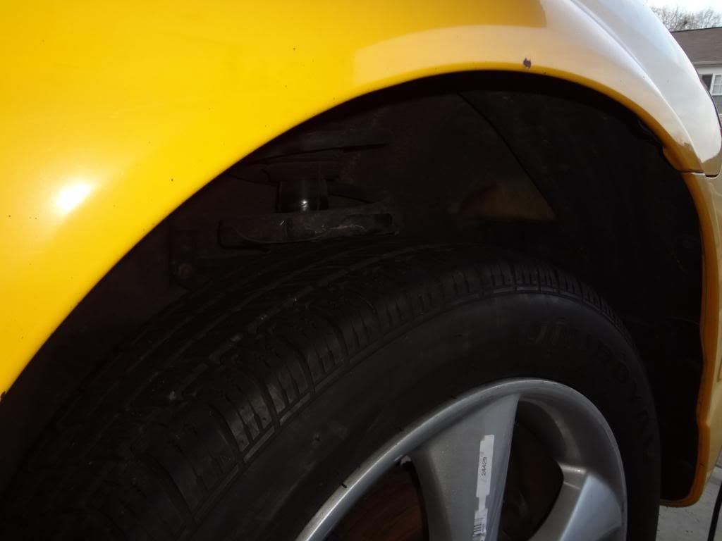

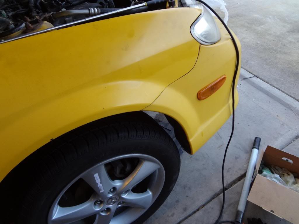

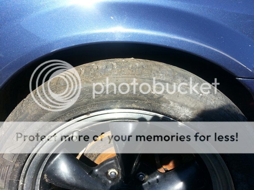

I could double check tire size but here are a set cobra wheels I had my p5(stock height) for a day while I mounted different tires on to the fronts.
I will say it sat just below the actual spring perch.
ha wow...245 width on a P5? Didn't know that was possible...those are 245/45 17's according to the last picture...a 215/55 will still have a taller sidewall (~118mm vs ~110 for a 245/45), so i'm still betting it will hit the strut itself or the perch...Its a height problem, not the width...
