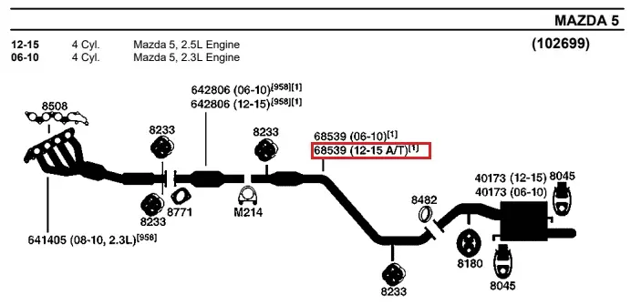

I'd prefer to replace after the cat from AP Exhaust PN 68539 for $77, but they list automatic transmission only.
Mazda is also showing different PNs for the automatic transmission L572-20-55X vs. manual transmission L587-20-55X (though the pictures and diagrams are 100% the same)
Has anyone dug into this?
Not yet, but I need to make a similar repair soon. I seem to only have one leak, so I may try welding a patch or replacing the elbow area with a bit of scrap elbow.
What source are you looking at? Offhand, I'm having trouble finding "5" exhaust at all (AZ, NAPA). Summit Racing lists the mid pipe 68539 for first-gen MT and AT, and second-gen AT, just like your diagram.
