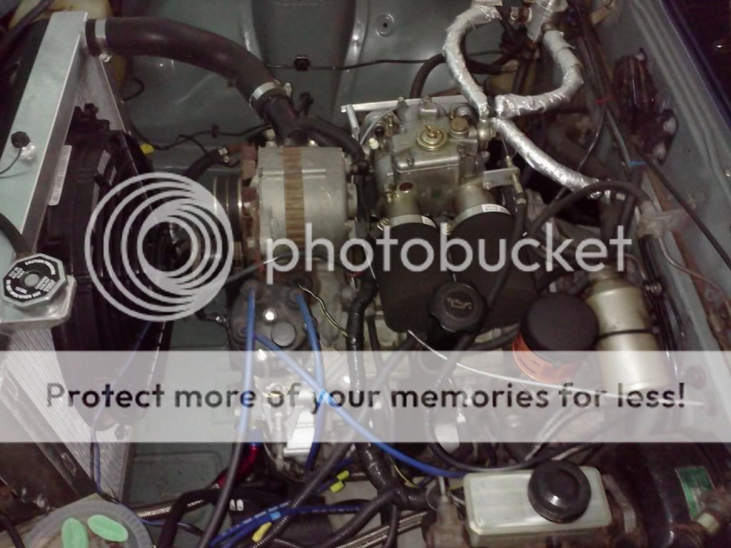

This is the best pic I have have of the engine bay right now, the car is in storage for the winter.
You can see the cooling fan setup that I have on the car.
I'll snap a picture of my e-fan on my radiator when I get the chance. The FC radiator is a little bigger than the SA/FB one. Marc, do you know the specifications of your radiator (e.g. flow rate, max. current draw)? Mine should be around 3000 ft^3/min at <20 A if I recall correctly. The only other reason I wanted to run some kind of shroud is because I planned on eventually connecting it to some kind of duct that vented out the hood. I was thinking about this more and a shroud shouldn't limit the amount of air going through the radiator. According to conservation of mass so long as the flow isn't supersonic (choked) the area reduction (fan shroud) should only serve to increase the velocity of the flow. This is obviously ignoring pressure effects in the engine bay but it seems to make sense to me. This isn't saying I could get away without a shroud, but I guess what I'm saying is I should do a little more reading.
