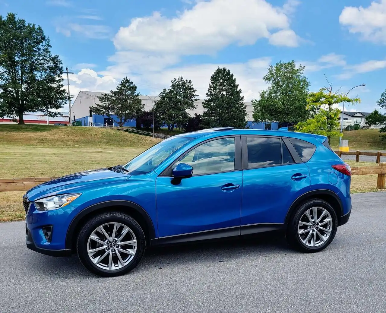

Made the impossible Possible 😎 20" CX-9 GT rims on CX-5
I think it looks great, but wonder what size spare do you have?
Looks great! Details please! Any mods necessary or just a bolt on?
What tires?
How much heavier is this set up over stock 19’s?
What is the perceived ride and handling differences?
Thanks. And beautiful looking vehicle!
No I heard it might rub but I knew it would fit and luckily no rubbing on corner or bumps. No bolt on or changes to anything. Tire size is 255/50/20 so probably any bigger would have trouble. It feels same ride quality 🙂
