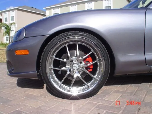

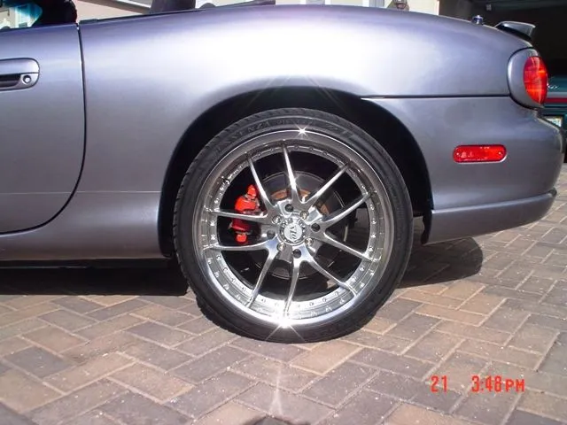

As many of you saw in this thread http://www.msprotege.com/forum/showthread.php?t=123622999 I put 18s on the miata. There is still some room to lower as seen the pics below.
My question, has anyone used or heard any positives or negatives about Eibach Pro Kit Springs. I had many a friend use them on their mustangs (I had mustang before miata) and they simply love them on the stangs. The look and performance of them were great, according to mustang owners. Just wondering if miata owners felt the same way.
Thoughts?

i have read all over the place that if you lower a miata you need to get springs and shocks. or you stock ones will die early and you could hit bumpstops a lot. i also have read alot that do not recomend the pro kit. i am not sure why i htink it may have been because the rates were too low. i want to lower mine but i am saving for springs and shocks. and our we gonna see you on monday
just to kinda save ass on the pro-kit, it's something i use and nothing bad has happened yet. i think i remember reading what you read and they mainly stayed away from them due to it not giving them much performance on the autox tracks? i'm still on stock shocks and they have not blown, but i do recommend for your time saving, to go ahead and purchase shocks if you plan on getting springs.
either way, i am satisfied with my purchase of the pro-kit.
I have the Pro-Kit and it doesn't play well with any strut that uses the same body height (in terms of the strut) as the stock unit. With the Pro-Kit mated with such struts, you'll only be left with about an inch of strut travel before the top of the strut body is resting on the bump stop.
In all honesty, I plan to ditch the Pro-Kit as soon as my budget allows it.

Granted, the are nice and cushy driving down the road. However, the spring rates aren't that much higher than that of stock.
Auto-x or not, I have no problem laying the strut body into the bump stops during spirited driving, which is not ideal in any case.
Yea I have decided against the Eibachs, since I don't have enough clearance. I have got to look into further performance springs to get the lowered look but no rub. We will see. thanks for the advice everyone.

Unfortunately, springs alone won't work. It's the inherent design of the Miata. Either the upper perch must be modified or the strut body itself must be shorter.
All things said, you may want to confirm this since you have an NB. I'm speaking from an NA standpoint. From what I've gathered and remember, however, the above holds true.
Seems I am going to have to redo the complete set up, new shocks, new springs and coilovers to adjust ride height so I don't rub. Man this stuff is getting pricey, oh well... :D
i know some people get the koni shiocks with adjustable perch and they can lower just a bit by changing the perch, without even getting new springs.
