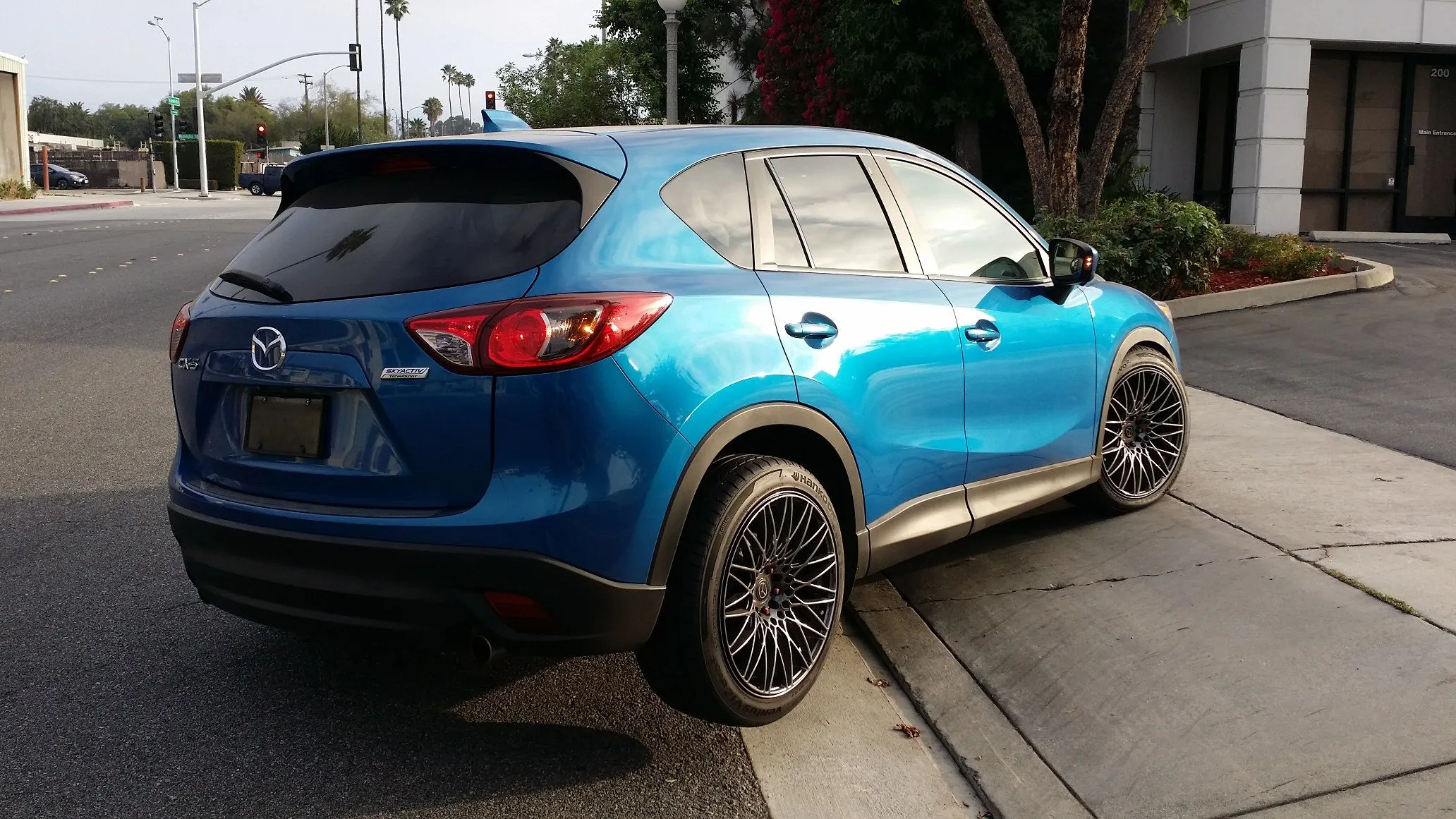

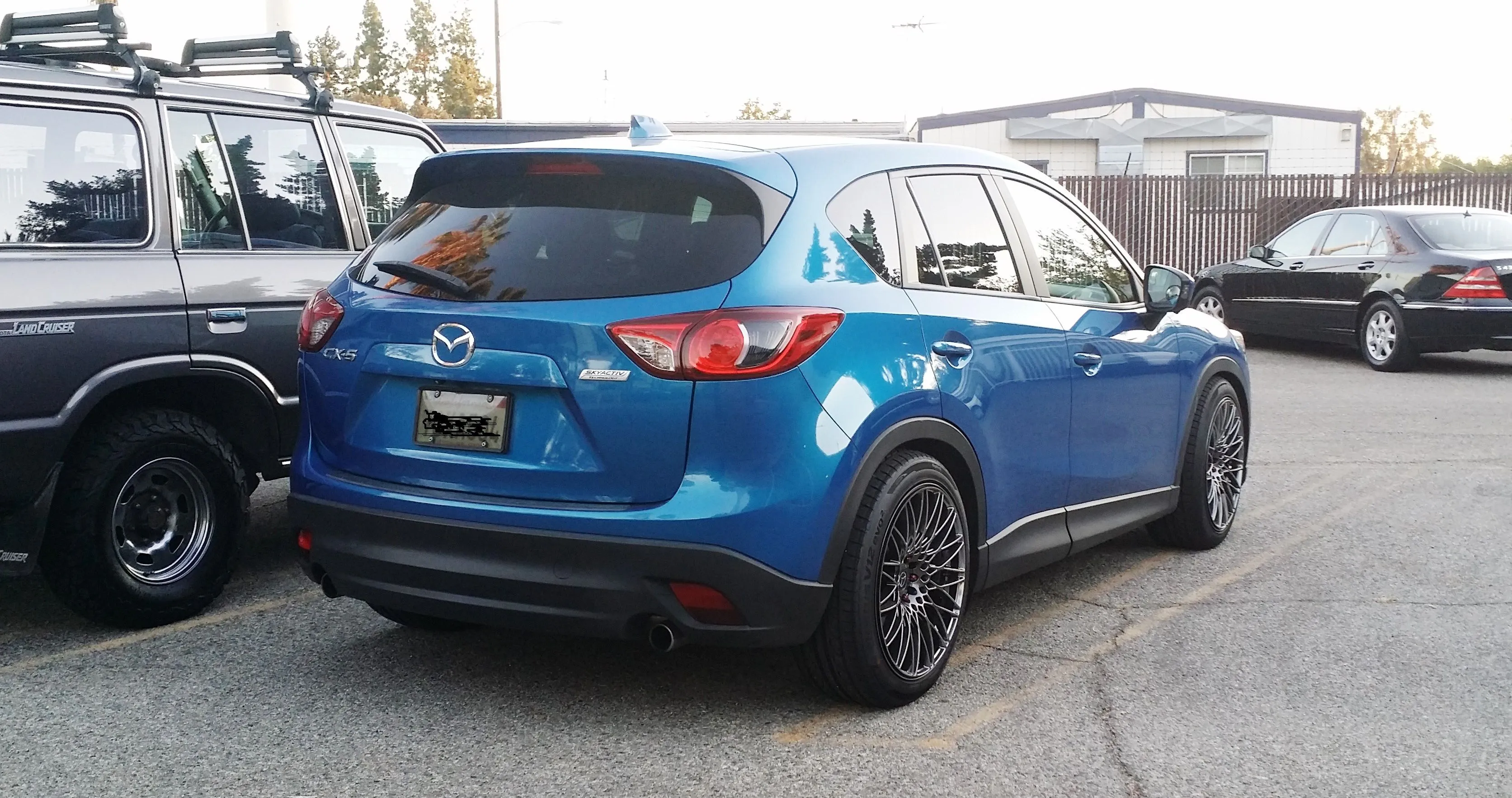

I have the CS springs and it's pretty hard core, but I like it.
I used to have a 1.5" drop in my ex 08' VW Golf(Rabbit), but this one is much more hard core.
In the beginning I have bottomed out, like three times, because I was driving the same way, as prior of lowering. After adjusting my driving style(more cautious), I have never bottomed out again.
I actually would prefer, that my car would sit a little bit lower.

Yours pulled up a couple times on google images and pretty much sold me on them. There is also a white one I found that looks nice with what looks like Niche wheels.
I usually lower mine about that much and know it can be rough, but cant stand wheel gap.
Any rubbing issues and did you use factory struts along with them?

Nice three wheeling!
Sent from my VS995 using Tapatalk
The white one, is Chris's car.
Using factory strut and no rubbing at all.
20"x9.25"- XXR553 gunmetal, ET36, 235/45/R20 tires.
I have been looking for pics of his because mine is the same color just to get an idea of the look, but almost impossible to find (bang)
