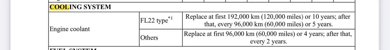

I just used Zerex Asian Coolant when I changed mine in early ‘23 so color won’t be a good indicator of stock fluid
I plan to follow Mazda schedule of simple drain and fill at 2 year intervals with the non-FL22
A lot of my maintenance is drain and walk away… use other vehicle if needed…come back later to fill….not a big deal
