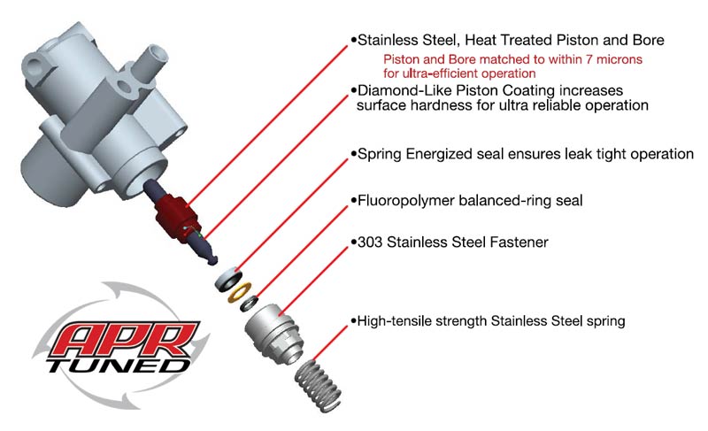

Keith@APR said:![]()
APR 2.0T FSI Fuel Pump
After many long hours of testing, APR’s Engineering Team has developed the final solution to FSI fueling. Even unmodified FSI engines can experience a temporary loss of fuel pressure due to inefficient delivery by the OEM FSI fuel pump. The APR 2.0T FSI Fuel Pump was designed to ensure consistent fuel pressure delivery and will support up to 520hp. The APR 2.0T FSI Fuel Pump requires engine management recalibration to allow for the increased size of the APR Fuel Pump to ensure flawless drivability and is included with your purchase. APR Stage 2 and Ko4 Turbocharger clients will be able to take advantage of increased horsepower and torque up to 25hp and 35lb ft with APR Fuel Pump specific engine management recalibrations.
Pricing is $1099 but as an introductory offer for Waterfest 13 you will save an additional 10% and pricing is $989!
Inventory of APR FSI Pumps is in stock and awaiting final assembly and quality inspection. Order now for the special pricing and you will receive one of the first pumps no later than August 24th.
To place your order, please contact your APR Distribution Network found here http://www.goapr.com/VW/dealer/locator.php or order at the APR Online Store http://www.goapr.com/ or call 800-680-7921
