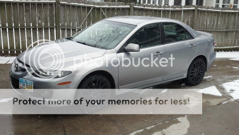

That is a beautiful thing :) except the snow. Go away snow and cold so this build can commence!
There won't be a build thread for the Speed6 because honestly it's going to stay how it is. I'll tint the windows this week and maybe lowering springs eventually, but that's it. I have to get the front bumper repainted since it's peeling. But she'll be my DD and it's SO much cheaper to build, drive, race the P6. The Speed6 has a couple fun mods already, like a 3" intake, CPE top mount, shifter plate, Dashhawk, Cobb accessport and a few other little things. 139k miles but 175-180 compression across the board and runs great.

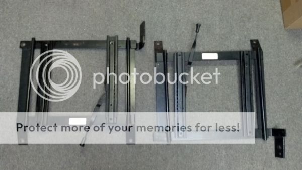

Seat brackets should be here Tuesday-ish then I can mock those up in the car. Warmer weather means more wrenching! :)

Looking forward to bolting them in and checking out the new seat position in the car. So far these look like they are lower than the OEM pieces which is what I was hoping for.
I don't now what part but the single slides break cause there only dipending on one side to lock it in. Mine broke on the side that locks. But I am not sure if I have a wedge slider.
Oh nice I got some wedge brackets too but those sliders I has one it broke just giving u a heads up
I don't understand. You broke a wedge slider that you don't know if you have it one or not?
