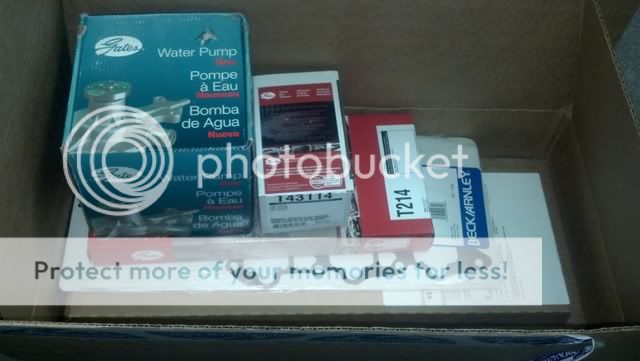

I got all my parts in from Rock-Auto, man I love that place. So it looks like I'll be putting the motor back together soon. I got some bits for my Dremel to port match the heads (oval) to the IM (square) last night so I'll do that tonight. It's slow going but fun nonetheless with some good music on in the garage.

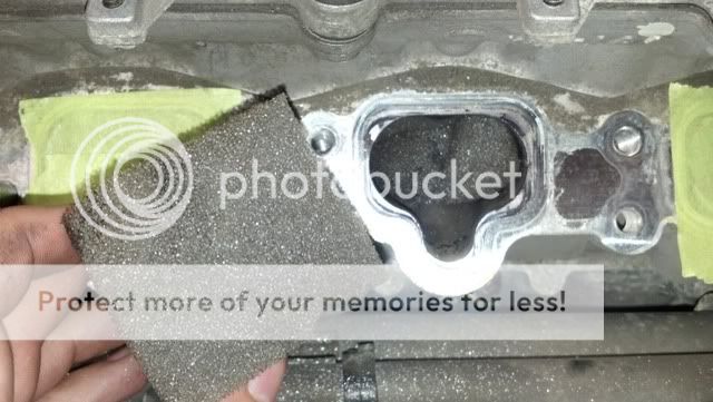

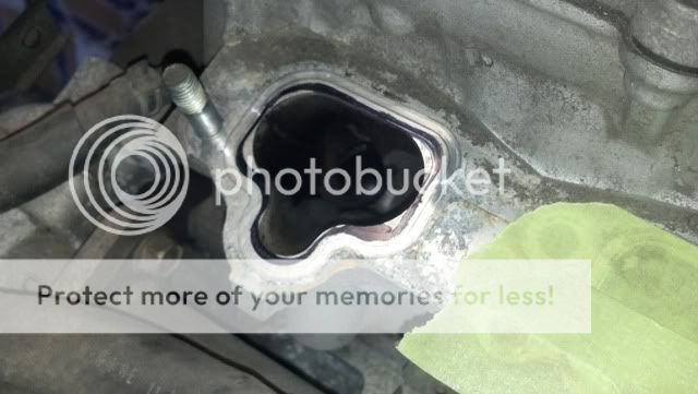

SInce I have a JDM KLDE the heads are oval, and the intake manifolds are square. A common thing for Probe guys is to port match the heads to the IM. Simple, cheap and only takes about an hour to do with a Dremel. Will you notice huge gains? Probably not. Is it worth a couple of Dremel bits and an hour of your time for better airflow? Yes.
I used the intake manifold gasket as a template.
Then use some sponge squares to block the metal shavings from going into the head and use a vacuum to carefully suck them all up when done.

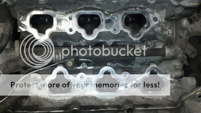

Finished port matched heads.
All done and cleaned up.

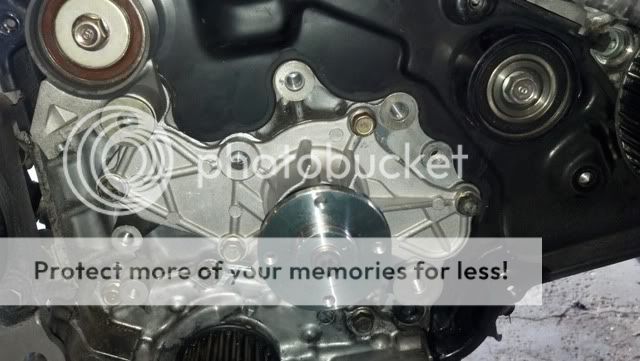

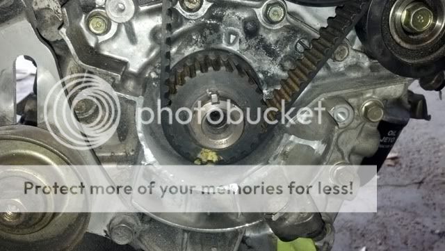

Installed the new Gates water pump.
Installed the new Gates timing belt and TB tensioner. It always takes a couple tries to get the timing just right but it's bang on now. :)

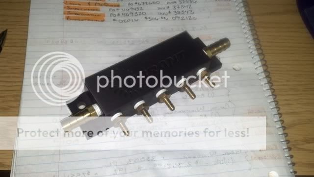

Impulse buy from the forums the other day.
^^^ Hopefully you got a smokin' deal because I could have pointed some good vacuum blocks from McMaster for MUCH cheaper than what Vibrant is asking.
