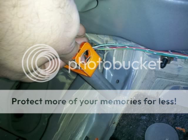

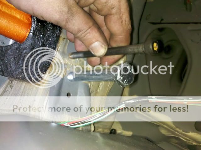

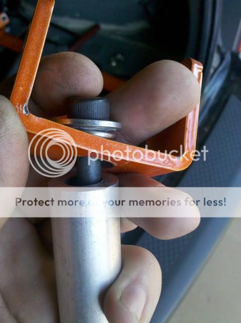

When I was taking the GT Spec trunk cage apart to get the old stuts out I noticed this bolt by the hatch. It's stupid small (M8) and not functional at all. This bolt is supposed to prevent chassis flex? Haha, riiiiight...
So after some running around town for metric hardware I drilled out the whole and tapped it for an M12 bolt. Which would you prefer?

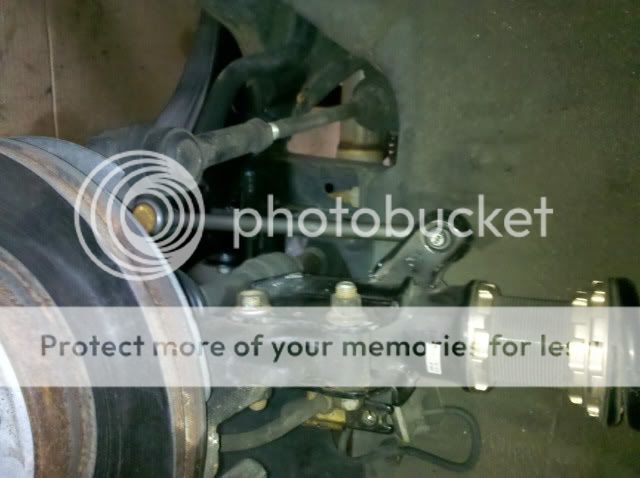

I got the rear camber plates in. The way the bolt pattern is on the P5 they don't mount perfectly straight like the fronts. But AAC said they got -1.5 degree of camber out of these plates. So we'll see when she gets aligned this week.
I'm also curious to see if these HardRace lower control arms are really a stiffer durometer. I think I may have gotten hosed... But here's everything all bolted up. Not that no one has ever seen a coilover before...
