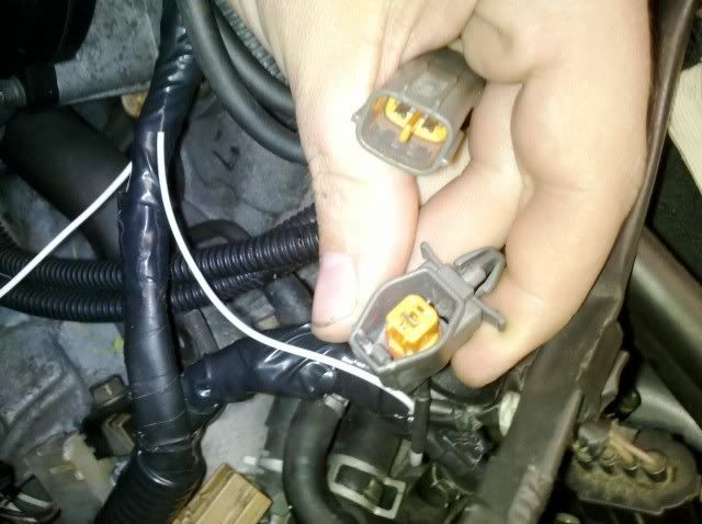

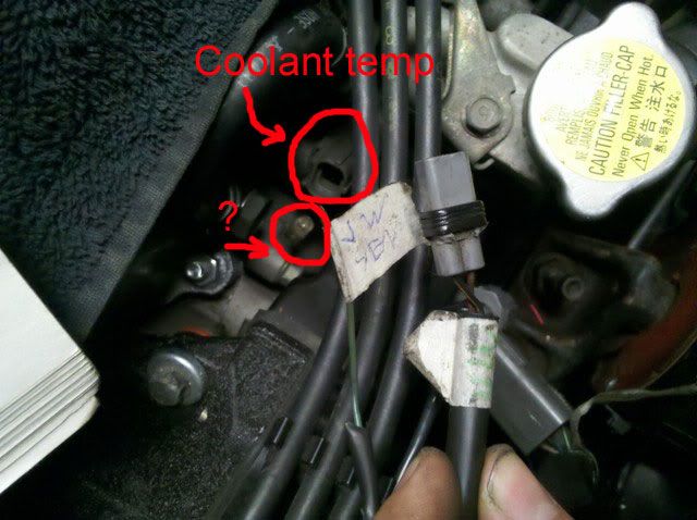

Here are some plugs I don't know what are. I know one is the coolant temp sensor, which I ran from the Portege coolant location. But I'm not sure what the little guy is for. Perhaps something that got snipped from the Milly harness. More research. And I don't seem to have a crank sensor... ???

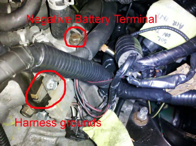

Here are my grounds. Are these locations okay?

Here's the ground clip that is broken. Should I snip the wires and tie them all together and ground them to the chassis?

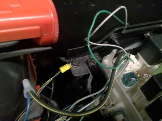

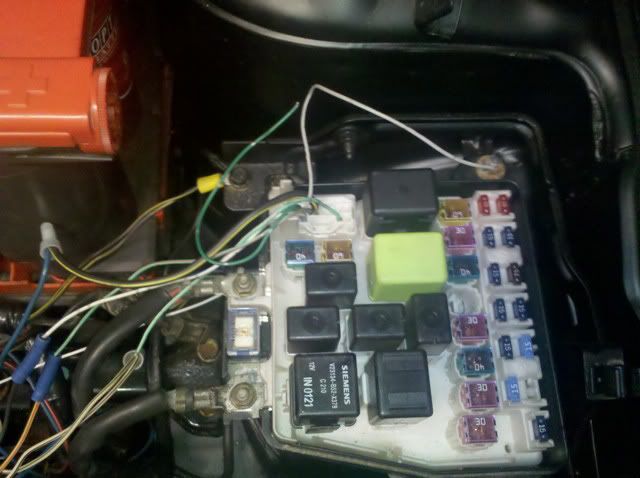

Here's the fuse block we tapped into. I think the spare two wires are to the tranny, but with an automatic harness I don't think they are needed. More research... But everything will be soldered and wrapped in wire loom and electrical tape when I go through and trim off all the sensors I don't need when the motor is running.

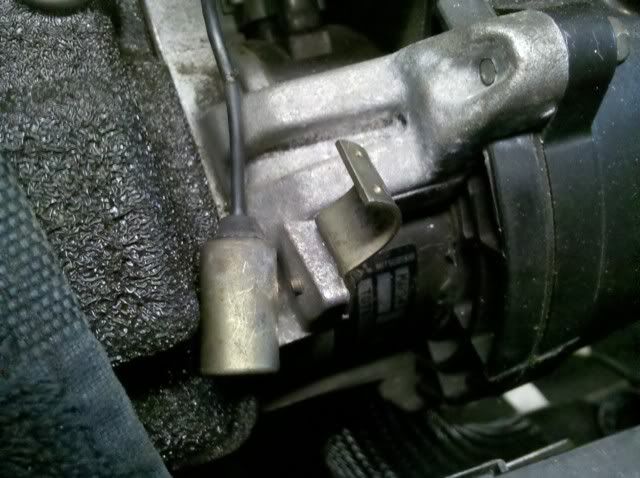

Here's the disty with this little bugger that was broken during shipping. I was hoping to just re-solder it to the metal clip and be okay. Or else I can swap it out for the spare KL47 disty I got from Jon.

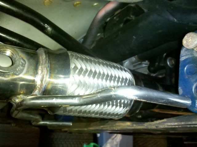

The OBX exhaust bolts up okay, but the hangers need to be heated up and bent towards the Protege urethane hangers more.
The exhaust is about 6" too short to mate up with the rest of the midpipe. And the Summit clamps I had used for the catylitic converter were leaking so I'd rather not use those again. But if I do, I'll seal them with hightemp silicone.
Grounds from the tranny plug.
Ladyhands for sure. As for your grounds you are better off grounding them to the chassis. (thats what i belive)
the sensor next to the coolant temp sensor is a coolant temp switch for either fans or for the ecu. Atleast the KL36 and Kl55 ecus lower the rev limit when the car is not fully up to temp.
as for the broken ground clip, just snip and terminate the wires by stripping them, twisting them together and using a ring terminal big enough for them and has an opening for a bolt on the chassis.
