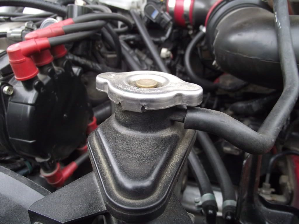

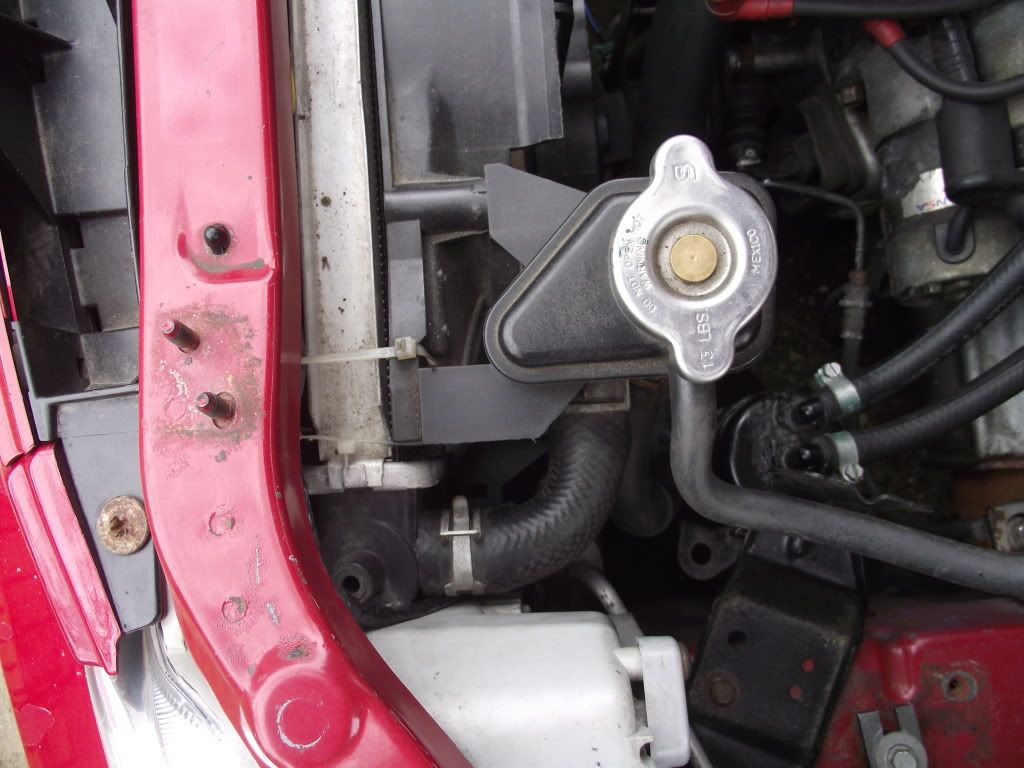

The picture above looks just like my radiator. What you are missing is the air separator tank that uses the smaller outlet on the top corner of the radiator. The air separator has the little nipple that you use to hook the protege container to.
Hope this helps explain it.
Pics:
Yup. That's the part I need. No luck on eBay so maybe I can try to hit a local salvage yard. Or the stearlership. Thanks for the pics, Justin.

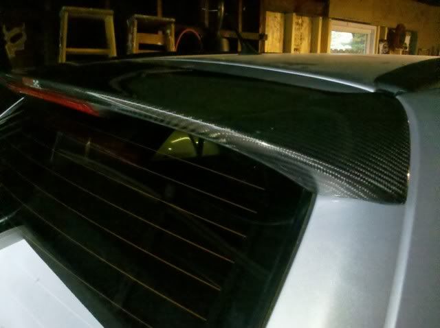

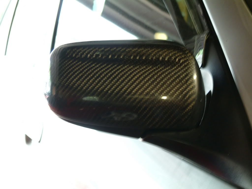

Got the axles in, finally. I changed one of the spring clips and it popped in easier. Oh, and we put on the CF spoiler and mirror covers. And new rear endlinks. I need to see if I have enough cash for the HardRace lower control arms ($315 shipped for the pair) for the new ball joints in them. O'Reilys wants ~$220 for one ball joint because they only sell the lower control arm. And it doesn't seem RockAuto sells ball joints for my car. Then I can at least finish the suspension. Oh, speaking of suspension, my CS strut tower bar juuuuust barely hits a bolt head on top of the intake mani. Ugh. I might have to shave the bolt off since it will probably never be removed anyway. (knock on wood)

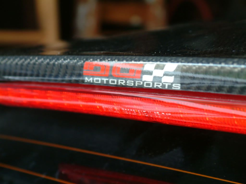

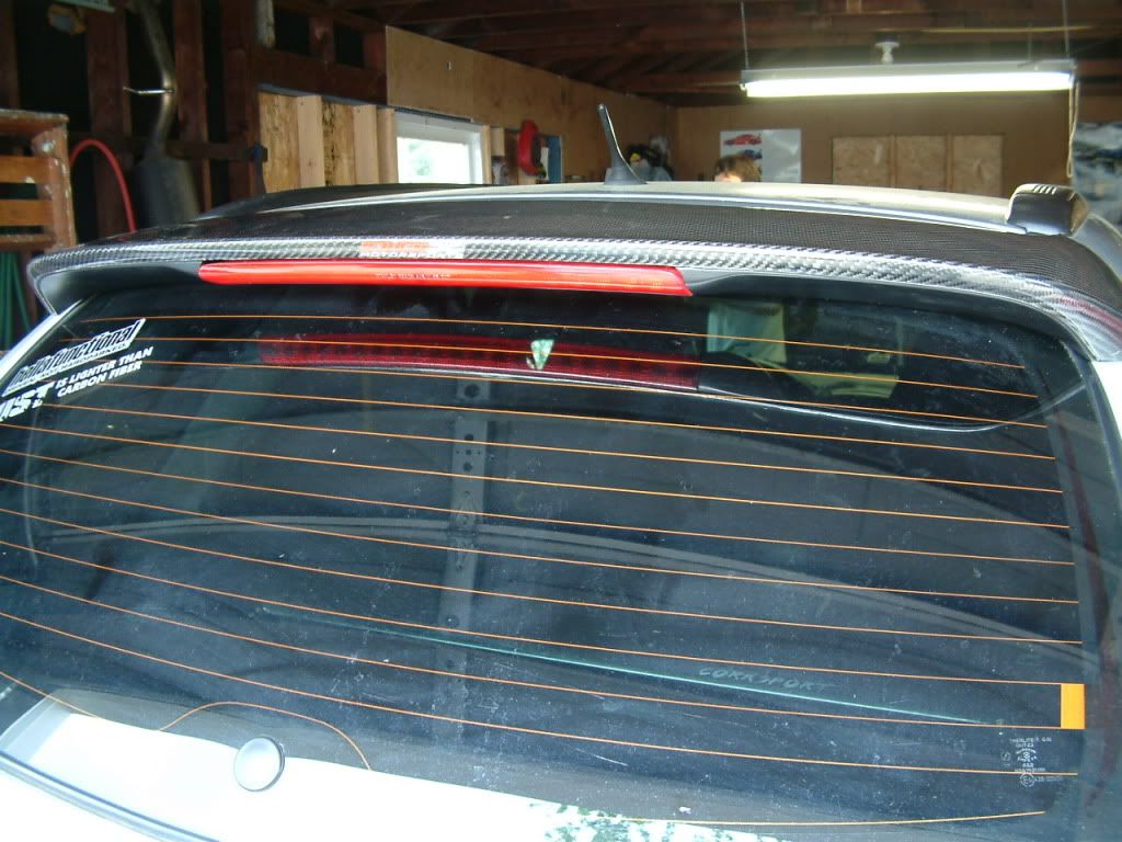

Here's a shot of the DGM spoiler. It took a long time to get the bolt holes lined up perfectly, then peel off the 3M tape backing and getting everything centered before sticking it down. But it came out well.

Hell yeah, man. Just some electrical tape. heh-heh, no Simon. There is a bolt on each end holding it on, then I used 3M double sides tape on the ends and all along the top. That bugger is on there solid. And it certainly won't rattle like my old one started to do.

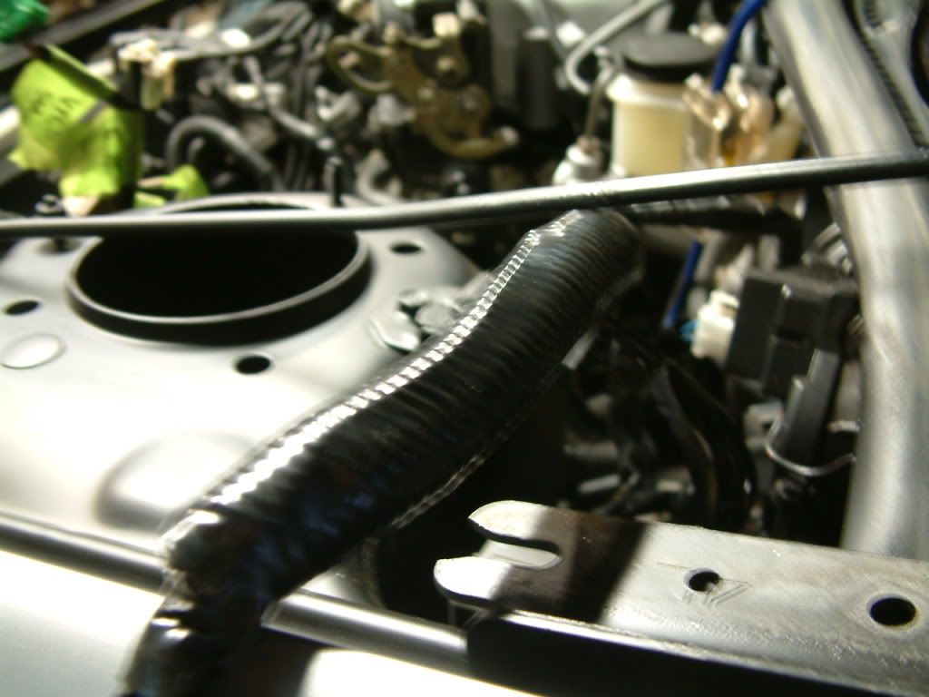

A nice blury picture of the wonderful wrapping job Evan did on the wiring loom. It's like a big shiny sausage of newness.

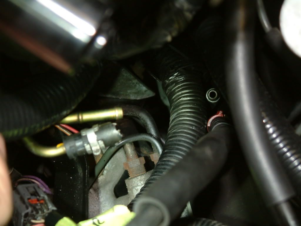

These are the fuel lines. They're really close, but finding the right inner diameter hose is the trick.
your hardlines look smaller than mine...weird..My hoses have 3/8 still marked on them. I will check the return and feed lines on the firewall in a few when I go to leave. I have a friends graduation to attend to but i'll update once I get there from my phone. Also, for the P/S line I got a hose that was very snug over the suction hardline on the pump and was kinda loose on the reservoir. It was loose, but clampable We took several sizes from my friend's work and didnt keep track of each sorry I can't help on that size.
