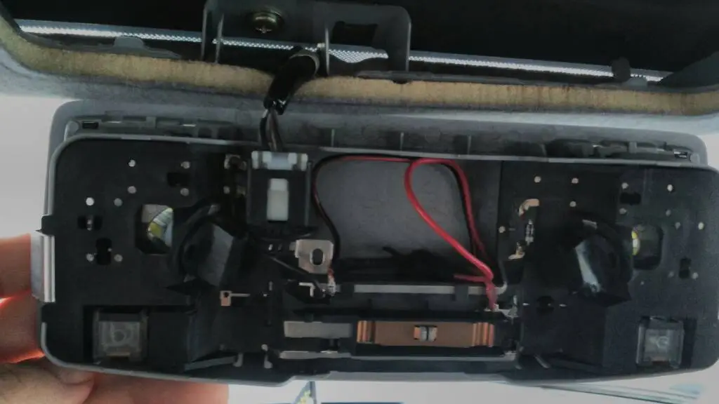

Does anyone knows where to solder wires for legroom LED on domelight?
On this picture you can see how did I soldered, but the light works all the time, so when I close the door the light it's still working.
I tried to change position of the + on every metal part I could find, but it's still the same.
Hard to tell from that picture, but i would suspect that your dome light has a 3-way switch (off-auto-on) and therefore on that 3 wire plug there is 1 ground wire, 1 auto(door on wire) and one always on wire. You could either use a multi-meter to figure out which is which and solder pig tails onto those wires. Besides that I am not really sure where to solder to.
Thanks for help.
Actually, it's a 2way switch, so there is only auto and off mode.
And yes, I tried to find where is that contact with multi-meter, but nothing. Everywhere it's power all the time. It's really crazy.
