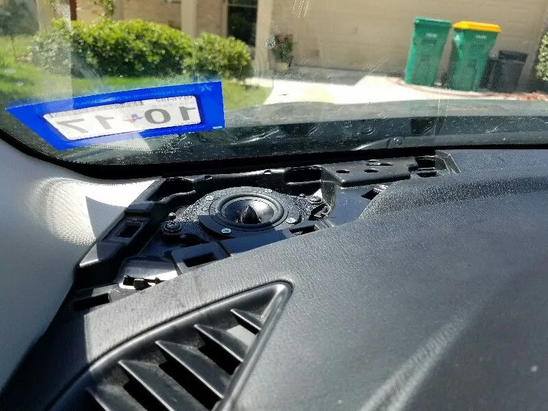

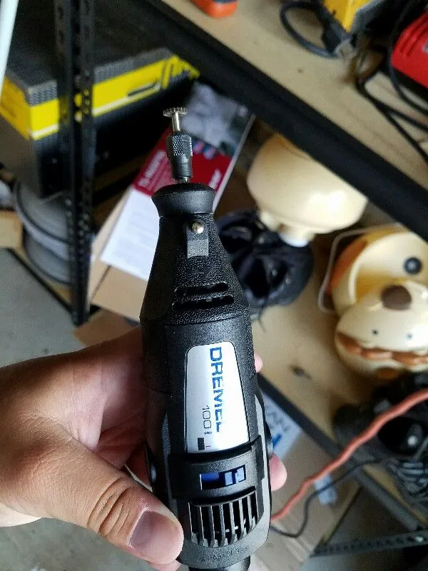

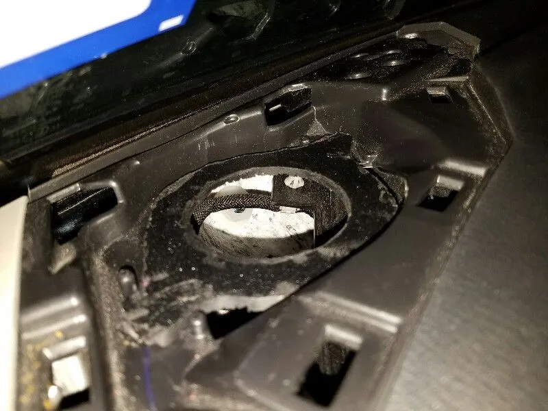

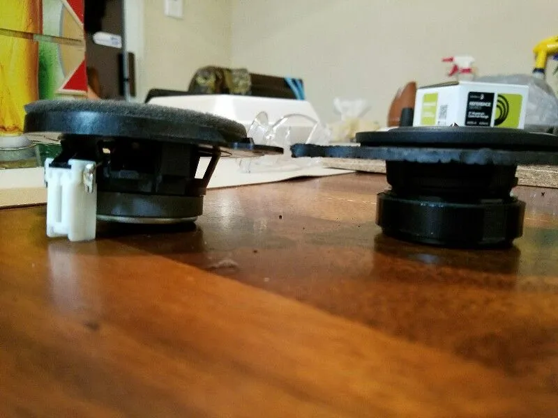

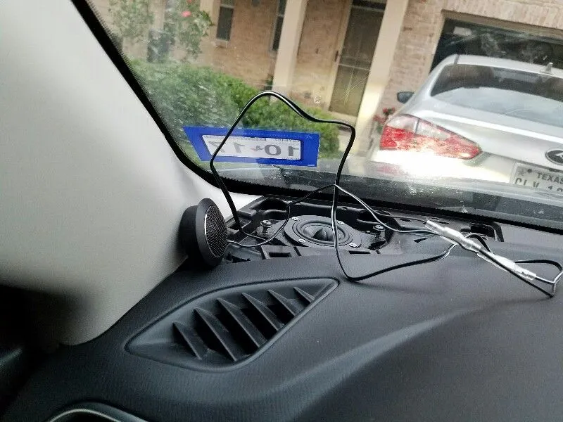

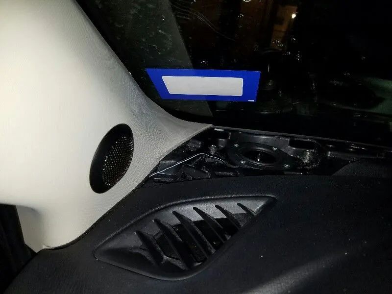

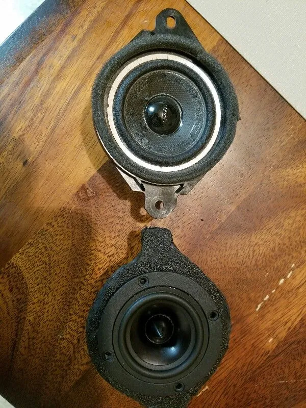

Components used are as follows:

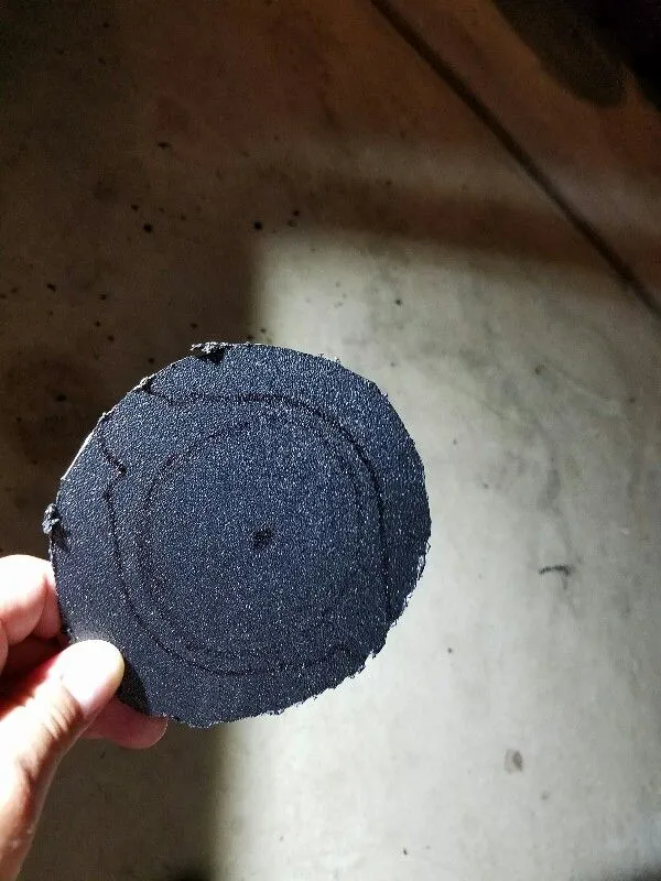

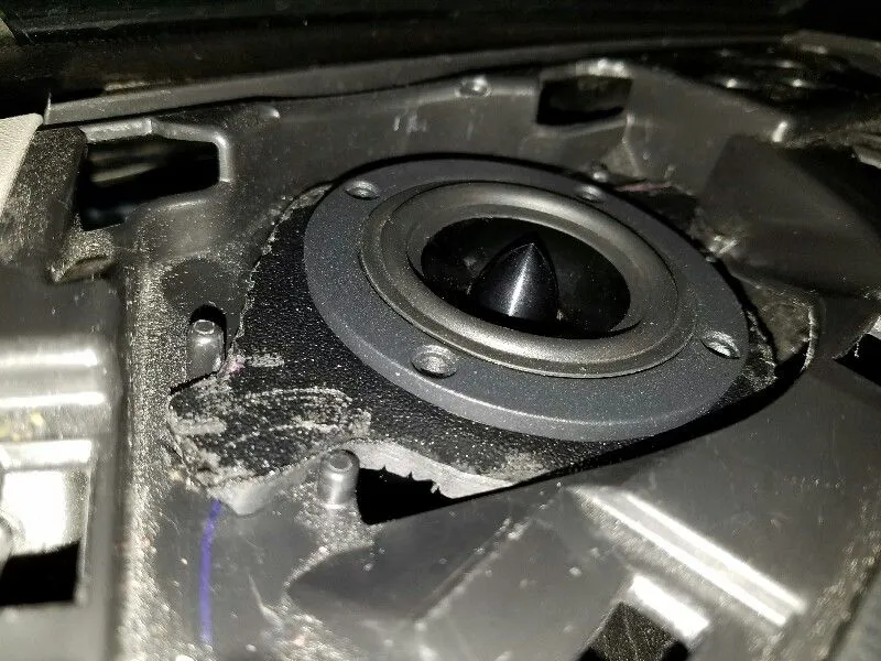

1. Dayton Audio rs75-4 for the woofer in stock dash location. I cut out a bracket for it and it fits just fine
2. Crossovers and tweeters come from a pioneer component set (ts-d1730c). I used the woofers on another install and was left with crossovers and tweeters so I figured I'd put them to use here. Crossover point is @4800hz, which works great in this case because that about where the Daytons begin to roll off their upper frequency response anyways.
The crossover has 3 tweeter settings. -3db, 0db and +3db. I ended up using -3db setting

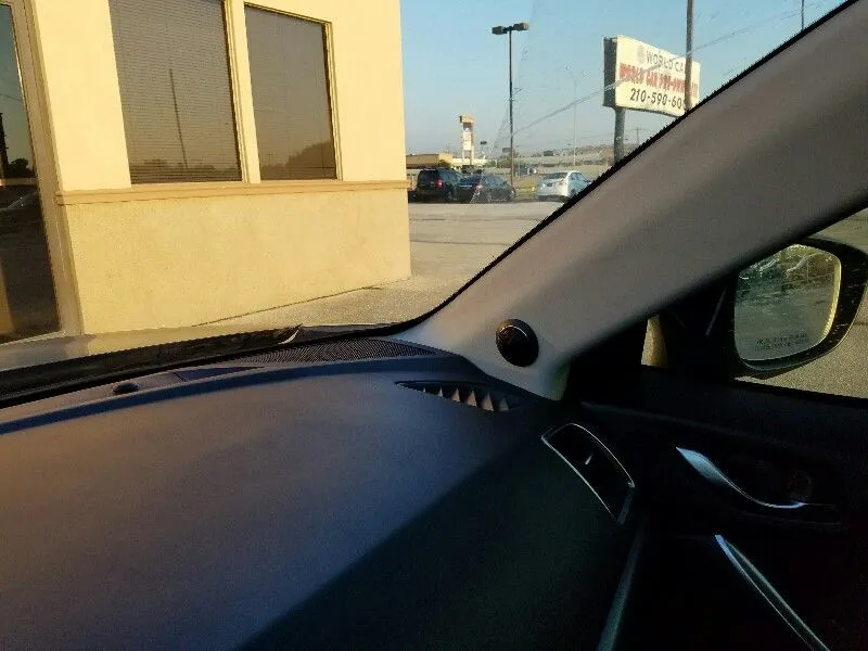

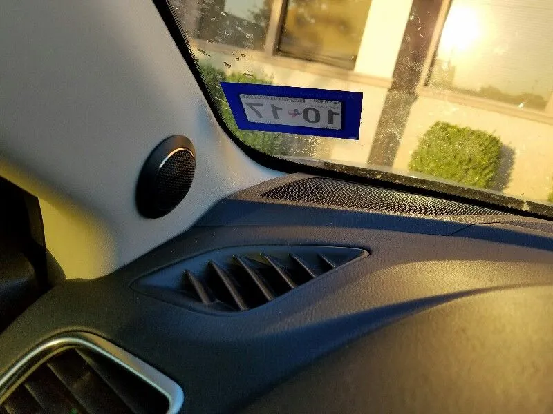

The location I chose for the tweeter is where I thought it would be easiest to install. Before making any cuts I played around with a few different locations for the tweeters and this one was the best in my opinion for sound and ease of installation.
Also keep in mind, you can do this project while using the stock dash speakers if you want. You just need the passive crossovers and tweeters. Parts express has a good selection.

Tweeters are supposed to face the listeners as the high notes are directional. Putting the missing tweeters on the A-pillars is the least the Mazda should do for the new CX-5! The most ideal location for tweeters is like my BMW 528i, on the triangle area inside of the outside rearview mirrors.

In car audio it's a little different though. With home audio yes, you want tweeters facing you. But in a car, where your surrounded by glass, plastic and metal, there is so many reflections, not to mention you are sitting on one side of the vehicle, as opposed to a "money seat" in a home theater being dead center between left and right channels. The same rules just don't apply in car audio. Trial and error is all you can do, and every car is different. Even if both tweeters where aimed at me, there would still be issues. Without time delay and active gain control you can't fix it. And even then it would only fix the driver seat position. There's going to be pros and cons no matter where you put them. That being said, Bmw premium sound systems are pretty good. Oh, and I'll try that method the next time I post photos. Thanks.
Yeah I agree. I just raised a general idea that the tweeters are more effective and less complicated when they're facing the driver like those high-end cars, not in the dash facing the windshield like Mazda6 and CX-3, and worse, without tweeters like CX-5 in their Bose system!

Somewhere I have read, that the tweeters should be like in a X, what I mean is that, the driver's tweeter should point at the passenger's seat and the passenger's tweeter, should point at the driver's seat.
Pointing them toward the windshield, is bad.
Soon, I will replace my front speakers, I will install my new Focal speakers and I will use the cone pods for the tweeters. I will play with there position and I will see which position sounds the best. I can time align mine, with my Kenwood as well. I'm not sure, if I like that feature, tough.
Yes I've read about configuring like that also. There really is no 1 way of doing it. It's all trial and error and what is appealing to your eye and especially your ears. Time alignment is a great feature. It's basically just adding delay in milliseconds. Also, in this case, making a component set out of the dash speaker, mounting a tweeter in the pillar was just way easier. If your component set involves a door speakers, we'll then it would be easier to install in the little plastic triangular trim piece at the top of the door. At the end of the day it's whatever makes you happy
