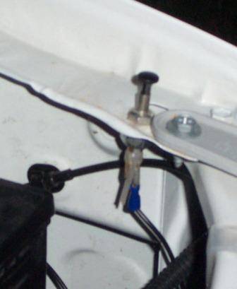

edit: I was envisioning a switch that activates automatically when you open the hood.
OK I guess knowing what the type of switch you need is called is the hard part :) Thanks.
U will need an spst(single pole single throw) switch
if u want one for when the hood opens I would suggest using the magnetic one like they use on regular house doors. Those pin switches like the ones posted above usually break and require drilling. The magnetic ones require double side tape and are less prone to breaking. But with either of those switches you will probably need to run a relay cuz they really aren't switches at all.
or you could wire in a switch so that they came on when you opened the hood... much cleaner, and easier.
My car alarm has a little mercury switch that attaches to the hood, as the hood lifts above horizontal, the switch opens. Something like that would probably work pretty well for underhood lighting.
EDIT: just read that's what he OP already has >.<
"I installed (3) Oznium High-Intensity LED Flood Light in addition to the 28" LED strip to fully illuminate the engine bay."

It's not my install and you dont have to use a mercury switch. You can use this normal run of the mill hood pin switch that most car alarms use.
I know but it would be cleaner to hide the switch and wiring up under the hood under-cover thing.
then you have to run more wiring to the hood. this could be installed next to the hinge in the back of the engine bay and be relatively hidden.
The lights are already going to be mounted in the hood, so it's 2 wires that have to go up there either way :)
