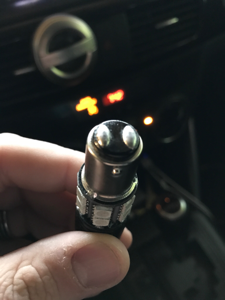

Does the base of your LED have two electrical contacts? Did you replaced rear turn signals into LEDs too? What happened if you turn the parking lights on, and added the turn signal with parking lights? The phenomenon you described is very weird and shouldn't be happening. Have you tried to put original 1157NA bulbs back and see if everything is back to normal? If that's the case, I can only say your eBay LEDs are not compatible to CX-5's turn-signal system and you've to try another brand. And you need to get load resisters too if you don't like hyper-flash.
It seems to have both contacts
