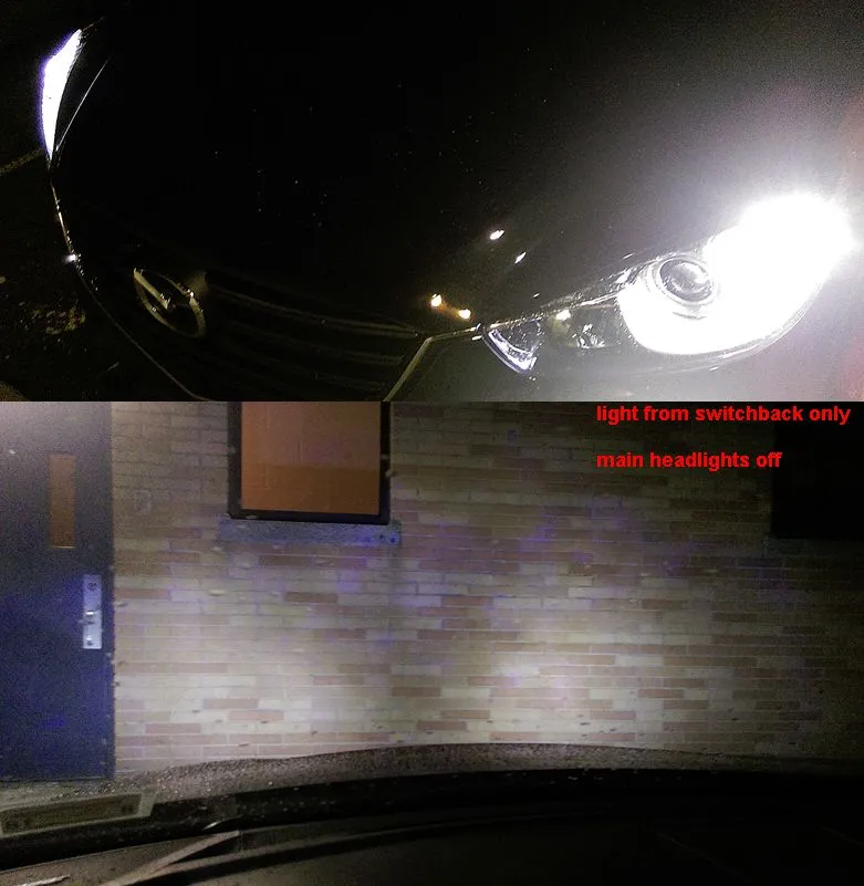

video of switchback LED, these are the newer generation switchbacks so there's no white light when the yellow light flashes, the white light comes on like 2 or 3 seconds after the yellow light stops flashing, the white light does not come on at all when the yellow light flashes which is what most drivers want unlike the previous generation switchbacks.

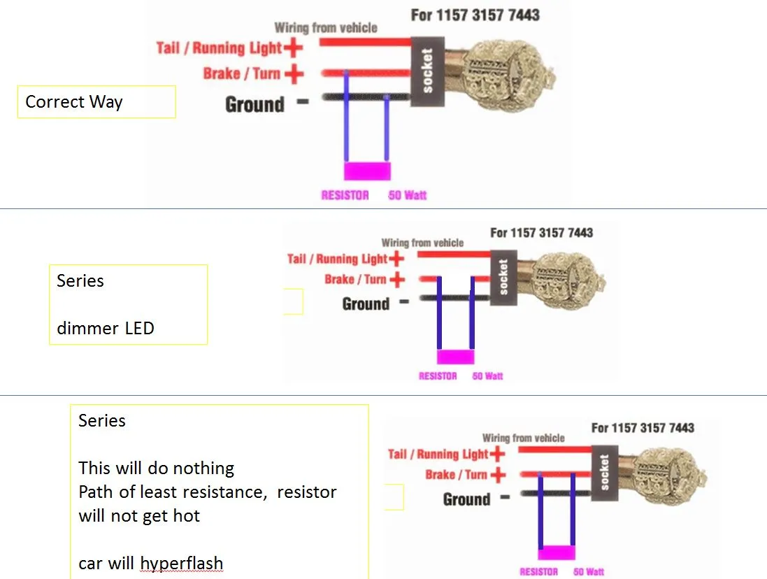

Hi, I received some requests to show how to connect the switchback resistors to prevent hyperflashing, here you go:
first thing, you need to get 50W 6 ohm resistor, readily available on Amazon or eBay, I added additional heatsinking because my work place has scrap metal that they don't need... the additional heatsink is not necessary but since it's readily available for me , I just used them.....

here is the wiring diagram for the resistor on driver side, you only need to connect the resistor wires to the OEM yellow and black wires, leave the brown wire alone.

here is the wiring diagram for the resistor on passenger side, you only need to connect the resistor wires to the OEM yellow and black wires, leave the brown wire alone.

The purpose of the resistors is to trick the car that there's a OEM orange bulb there to prevent hyperflashing, the LED switchbacks use less wattage so the computer thinks the bulb is bad and thus hyperflashing to notify driver to change bulb....
I tried to just drive around with hyperflashing at first, but the dash sound was annoying and also my OEM incandescent rear turn bulbs were also hyperflashing because of the front LED switchbacks. I didn't want to attract police attention, so just better to add the resistors.

The resistor preventing hyper-flashing is installed in parallel with the LED to lower the resistance of the LED making it compatible to resistance of the incandescent bulb. This means you have to splice two OEM turn signal wires to make the added resistor parallel. Now I saw someone claimed the resistor can be installed in serial, hence no splicing is necessary but some connector adapters in most cases. Is this possible though?
Nice work, tomcat1446! There're many people would appreciate your detailed instruction here and I hope you can spend some time to re-arrange your posts a bit and post a new write-up in the "How-To" section!
I may be wrong, but if Voltage =I (current) * R (resistance) ,
adding a resistor in series, it will increase the total resistance which will then reduce the voltage
being supplied to the LED and thus making it dimmer than it should be.
so yes, the fellow who put the resistor in series may have thought it worked, but he's not getting full brightness.
also, if connected in series, doesn't the resistor have to be connected on the 12V supply circuit not the Ground circuit, which would mean the LED sees all the heat aft of the resistor.
That's the beauty of the parallel circuit, current and voltage both flow equally and freely thru each parallel path,
so the LED gets full brightness.
the resistor is just a dummy load (like a virtual incandescent 1157A) parallel to the LED bulb because the LED is so efficient with low current draw causing hyperflashing.
the heat of the resistor that everyone describes is comparable to the OEM 1157A amber glass inside the housing, it's just that no one goes and touches the amber glass LOL, the LED produces very little heat inside the housing.

this worked like a charm , thanks tomcat!! the switchback is so cool, white LED for DRL then it switches to amber during turns then switches back to white LED after turn is complete. also you were right after pulling back the wheel well panel, that bracket with a hole is a perfect mounting location/heasink for the resistor, I didn't have access to scrap metal like you, so I just mounted the resistor direct to the car chassis. I have a 2016 non-LED also and the wire colors match exactly like yours, going thru all the posts it looks like for previous years prior to 2016, the wires are different and also it matters if you have the tech package LED headlights or not, it's best to get a multi-meter and confirm which wire has the alternating voltage for turn signal......
