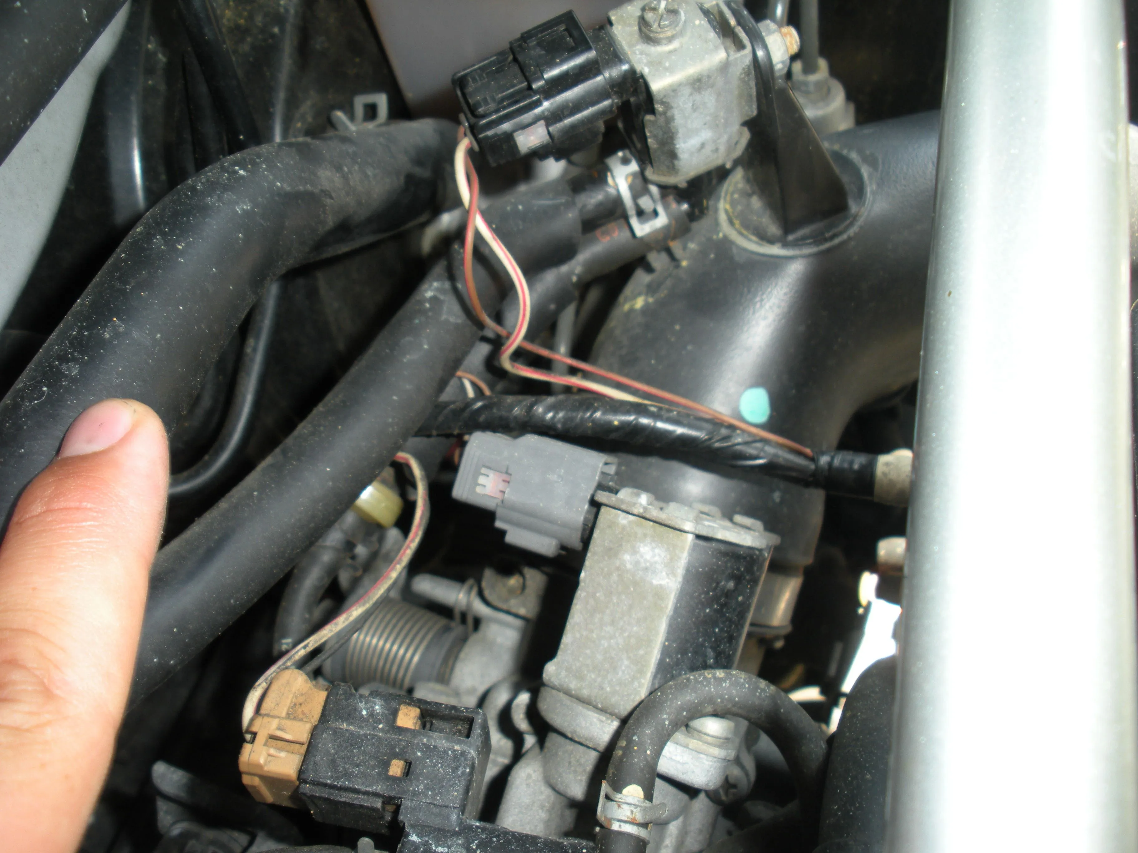

What are these two vac lines/plug for? (Mounted on the cold pipe) Do you just mount them somewhere else when the hardpipe is installed? (Mine is on the way)

Well I feel dumb for asking that now.

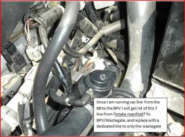

I have sortof sketched out what my install will be like in these two pics- will someone please make sure I have it right? Thanks! (scratch)
Pic 2 is right. Pic 1 is the right line but don't put your tap that close to the booster. Feel around for the check valve and put your tap on the engine side of it.
