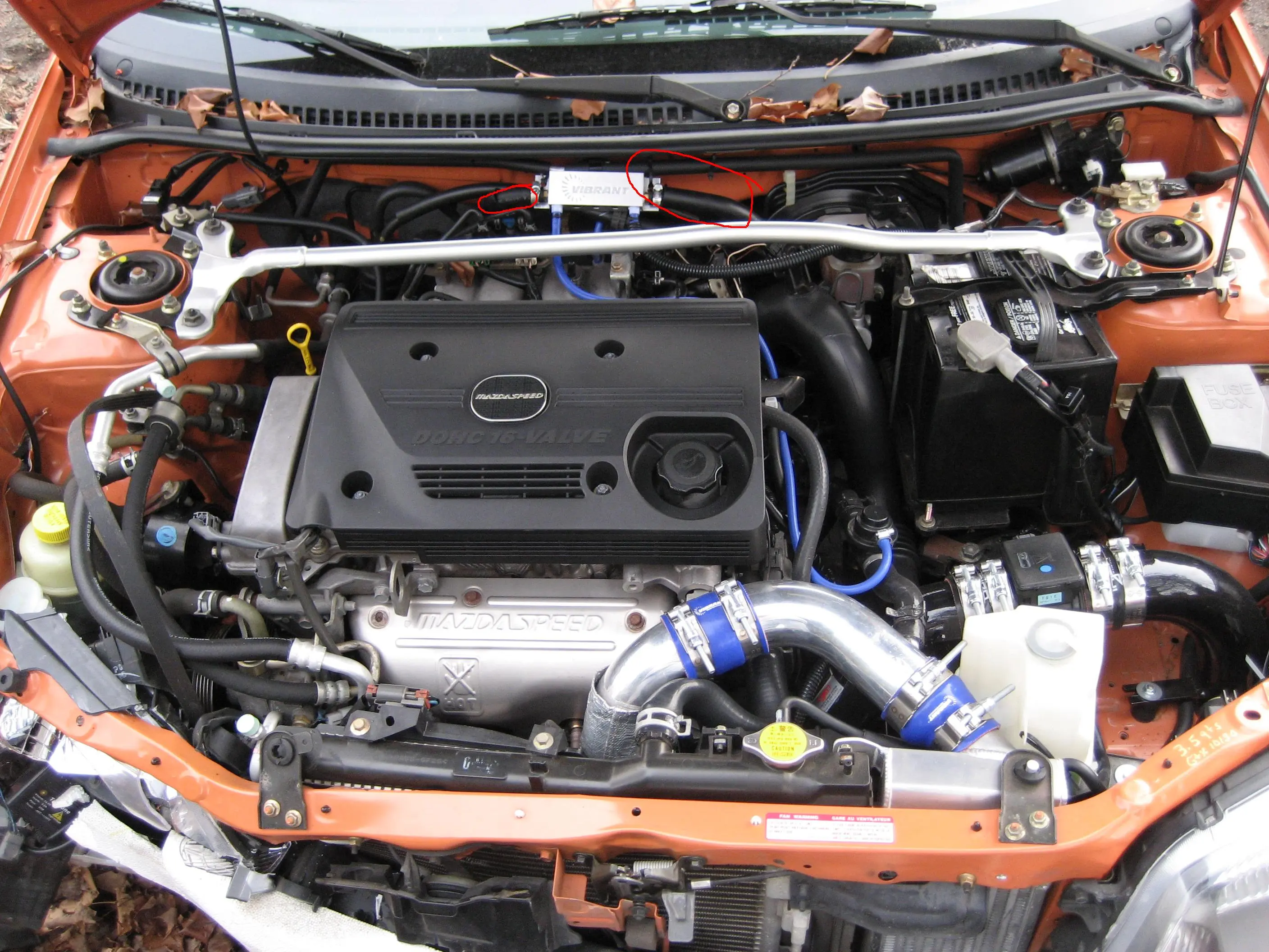

The brake booster is one of the largest vac sources in your engine bay. right now your bpv and your wastegate are running off the same vac source. For any aftermarket bov (especially the boostsciences rdv) to open properly it needs its own vac source. Look at the pic above. I can take some more. The one on the first page is running for a fmic, mine is if you still have the stock smic.
Break booster line is.. well I will post a pic of it, but it is good to run it off of there, as well as all/most of your other parts that need a good vac source because it is a strong/"clean" source, it provides a more stable and consistent source of pressure than the IM, or something like that lol

the key to the bpv only setup is getting the setup right. if you look at mine they had to move the nipple on the sri from the right side by closing off the stock nipple and putting a new one on the sri. this is better than trying to get a pipe over to the side. the key is to have as little space as possible between the inlet of the rdv and the outlet of the hotpipe and as little space as possible between the outlet of the rdv and the inlet of the air intake. also make sure the vacuum hose has no kinks or shapr curves in it

you will be golden then, all you will need is a 1" inner diameter nipple welded onto the hotpipe and a 1" inner diameter nipple on your air intake. look at my pic a few pages back to see that I had to relocate the nipple on the air intake from where it came stock so the vaccum line from the outlet of the rdv to the air intake is as short as possible and as straight as possible. Aside from the nipples the shortness of the vacuum pipe and the straightness are the most important. You want as little gap as possible between the hotpipe outlet and the inlet of the rdv. and you want as little gap as possible between the outlet of the rdv and the inlet of the air intake. You do not want any harsh bend or kinks in any of the pipes or hoses. then you remove the stock vac line the bpv used and cap that off at the "t" then run a dedicated line from the rdv to the brake booster. (put a t in the brake booster line to the left of the check valve, to be safe start feeling for it in the middle of the line and make sure you cut to the left of the check valve.)
