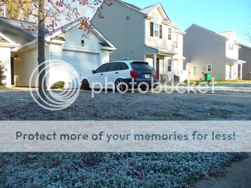

So put the new coils on, I have some pics on my computer that ill post tomorrow. The camber adjustment with these sucks ass, but the ride and dampening is WAY better
Im going to upgrade the rear springs for sure, there really soggy and compress a decent amount on long sweeping corners. Im thinking 10k front 12k rear, I had 12.5K on my old coils and the ride wasnt bad at all, so thats not something Im worried about.
Tomorrow im going to roll my rear fenders some more, slot the coils some more, and see how much camber I can get, Im barely at -1 degree right now, and thats not working with the 17x8 +38's, at least not with the size tires. SO im shooting for -2 up front and -2 in the rear, toe is zero'd out, car handles amazing. Next check im buying a rear strut bar, the springs, hard race control arms, and maybe other suspension stuff. Going for a functionly low car
