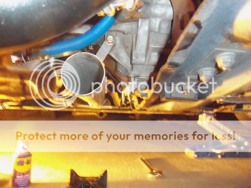

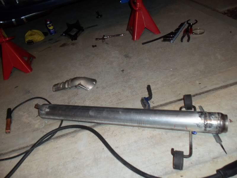

welded my 2.5"-3" adapter to some 3" pipe, made the mid pipe section of the exhaust,
only got two pics, was pretty easy actually...took me like 30-40 mins

why not full 3" all the way back? that 2.5" is somewhat restrictive
Where did you get that 2.5-3 transition for the exhaust.?
ATP turbo, its a pretty nice piece actually. Dont remember how much it was, but it wasnt expensive
awesome man, cant wait to see some pulls.
mainly because of the extra time and money it would take for me to make a full 3" lol
i just used all the 3" pipe I had and am makin the rest 2.5"
