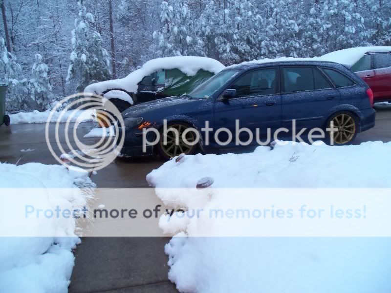

Have you tried photoshopping them a dark gunmetal? I think it would look with the blue
Looks good. Are you going to can spray or PC?
Probably spray..i dont want to pay 80 bucks just in tire mounting and dismounting fee's lol plus one of the wheels was majorly curbed, so i fixed that with body filler...which the powder wouldnt stick too
this is the best i could get that looks gunmetal...i thinks its a little too bland
Ill prob stop by walmart, lowes, or autozone to look at spray paint and see what colors look good
