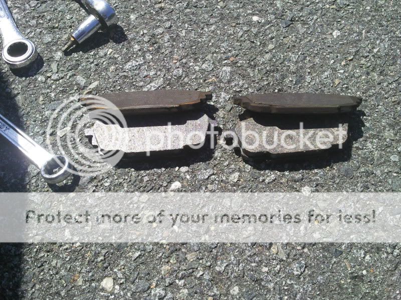

but here are some pics of the pads, as you can see i needed to change these very badly haha
